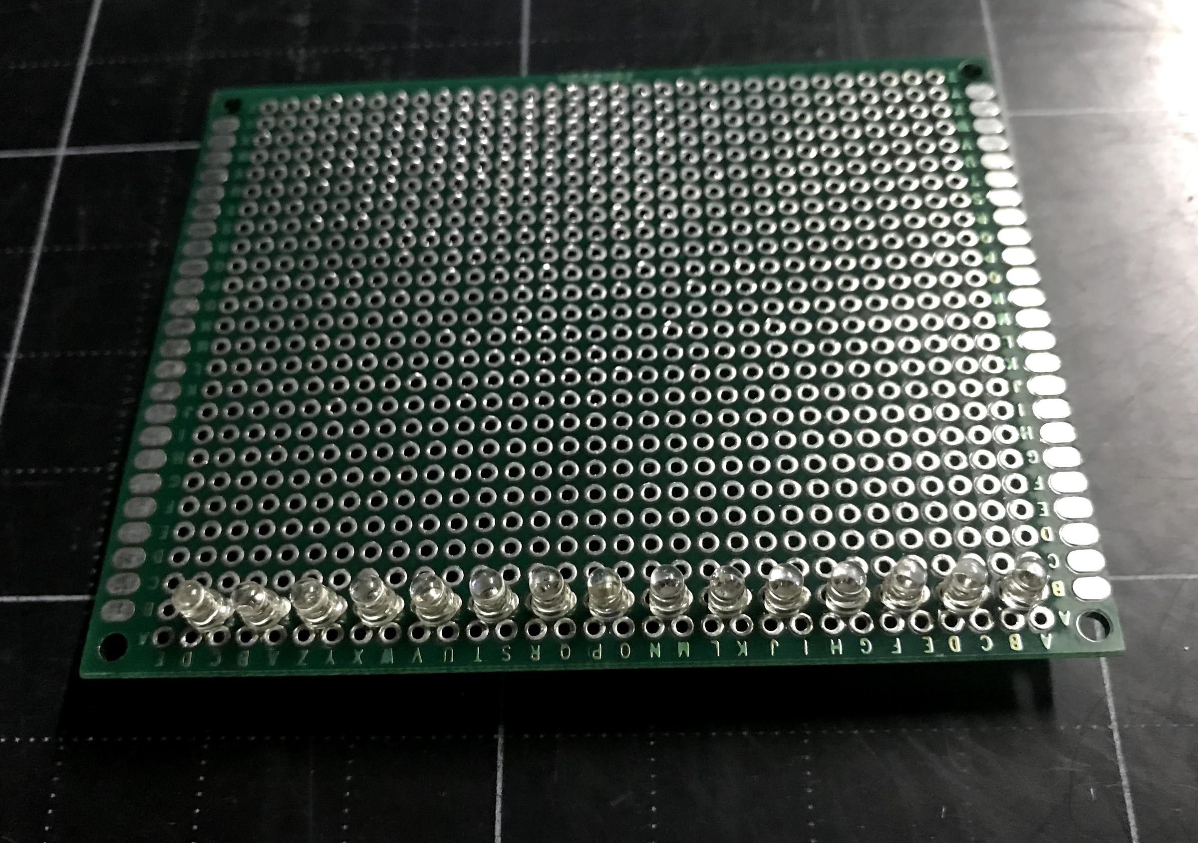

Step 3: SOLDERING LED MATRIX 13x15

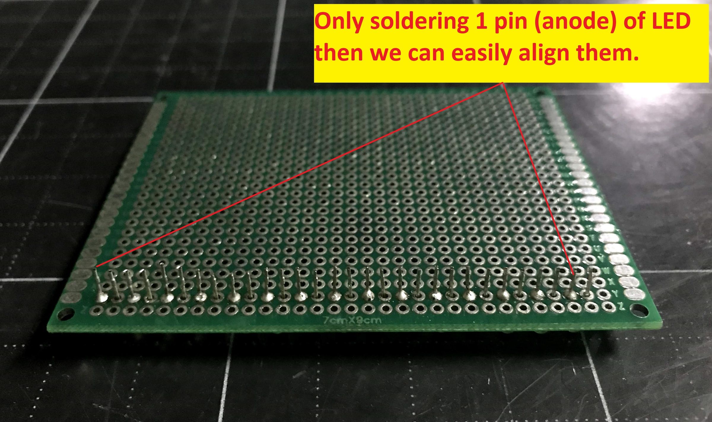

- Arrange the first row of leds

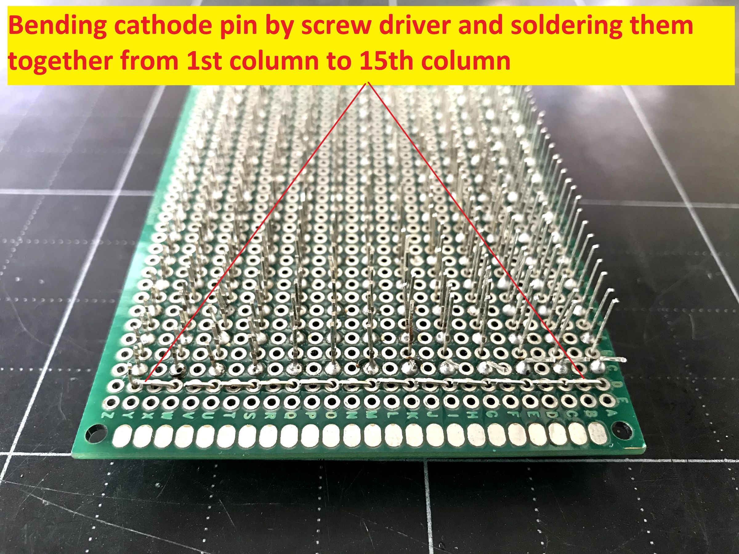

- To be able to align the LED, we only solder one pin of led - anode pin in my case. If the led is deflected, we put the soldering head at its anode pin until the lead is melt down and do alignment at this moment. We should cut led pins short enough and ensure all rows/ columns to be soldered together without any extension wires.
- Soldering one anode pins and cut led pins for all remaining leds. Now we start soldering 13 cathode pins of leds in the first row together. We have all 15 rows and each row has 13 leds.

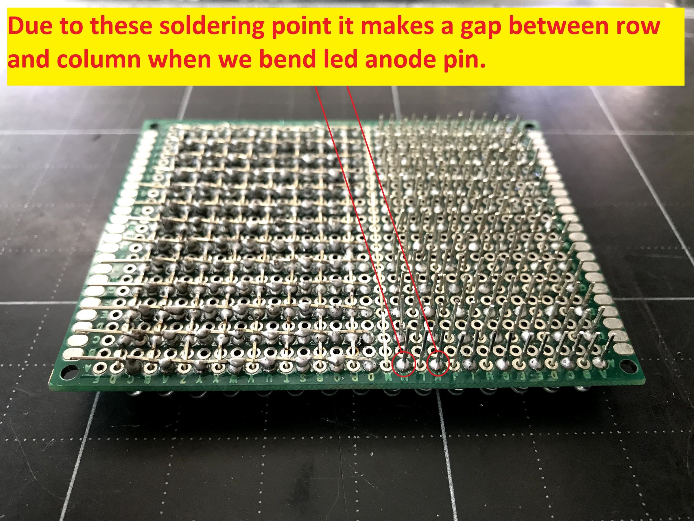

- For the first row of LEDs, we just bend them and later they will be soldered to the male header and connected to transistor A1013. The second row will be bended and soldered to the first row. We just follow the order from outside to inside and solder the columns first, then after solder the rows. Note, after each row and column is completed, we should check the leds to see whether they are broken or short-circuited / open-circuited.
- Note that we should solder with a sufficient amount of lead at the anode of led. And later when we bend anode pin, they will be folded at top of this soldering point and there is a small gap with the cathode pin.

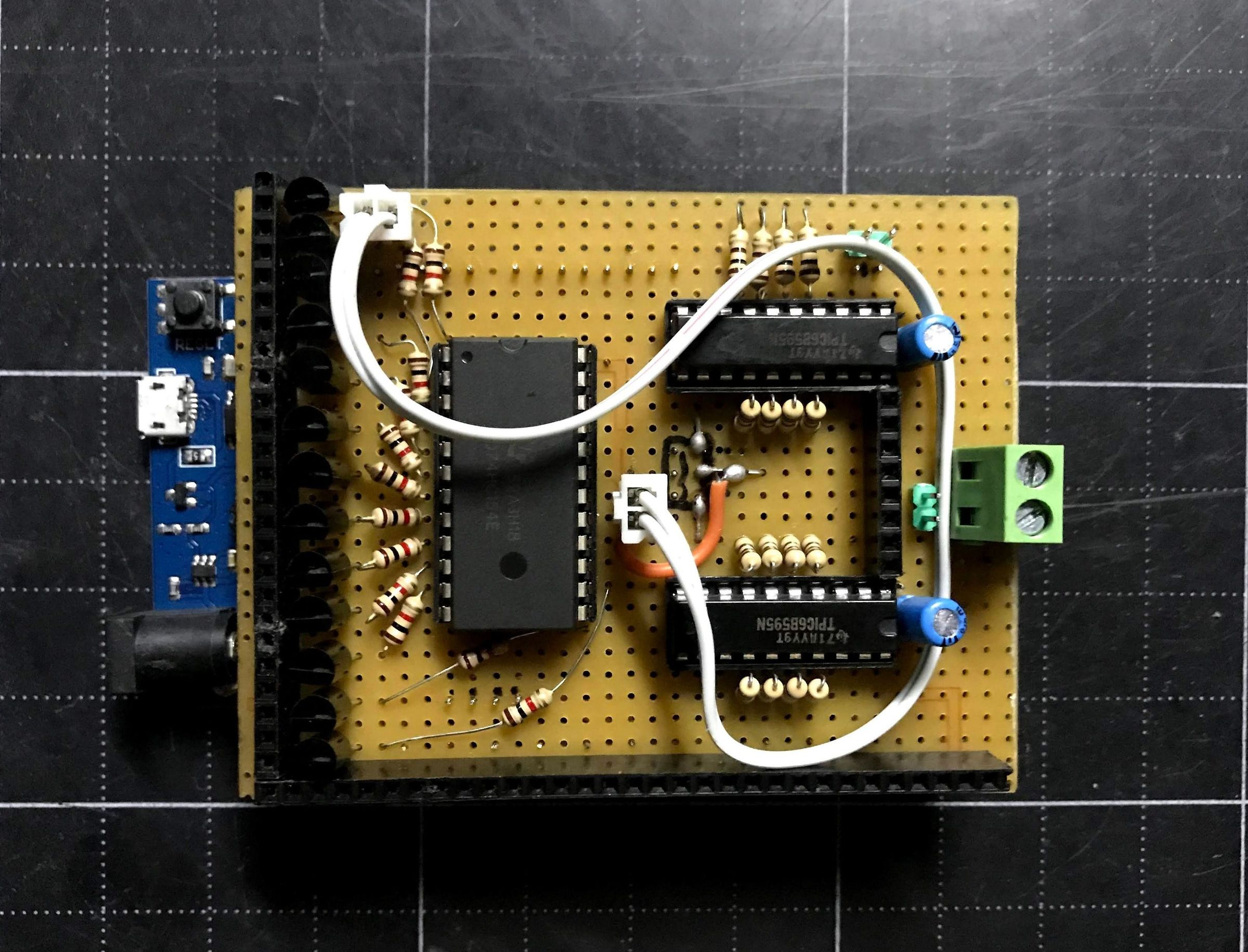

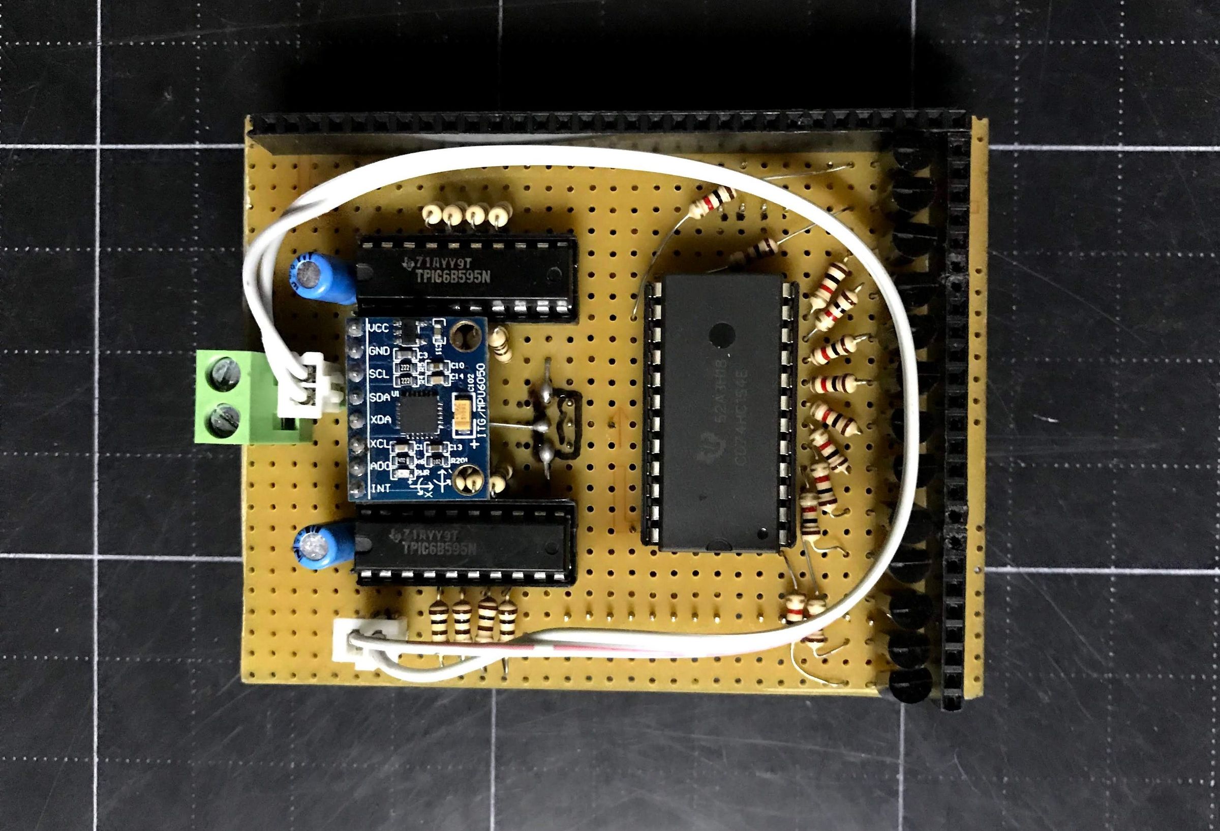

Step 4: SOLDERING CONTROL ADAPTER BOARD

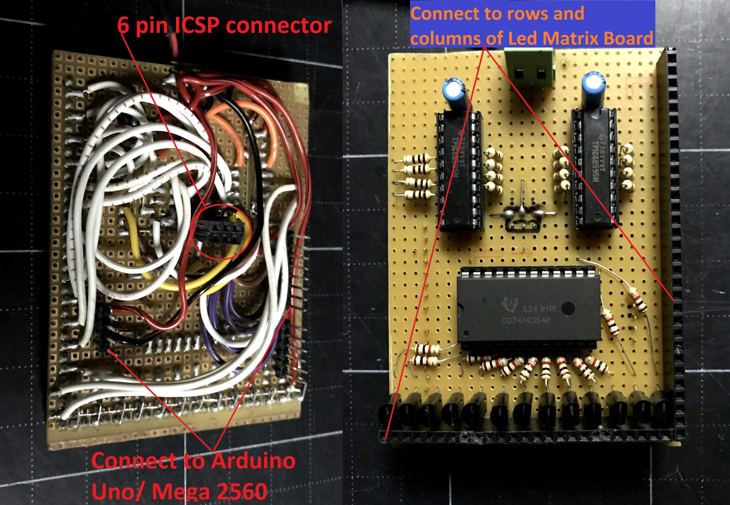

- Soldering the control circuit following the diagram as following picture.
- Control Board - TOP VIEW
- Control Board - BOTTOM VIEW
- To turn control board and led matrix into a shield, we solder the headers on control adapter as follows:
- Female header at top is connect to row and columns of led matrix board.
- Male header at bottom is connected to Arduino Uno/ Mega 2560.
- Female header at middle is connect to 6 pin ICSP connector of Arduino Uno/ Mega 2560.

- And we can add MPU6050 on the control board.

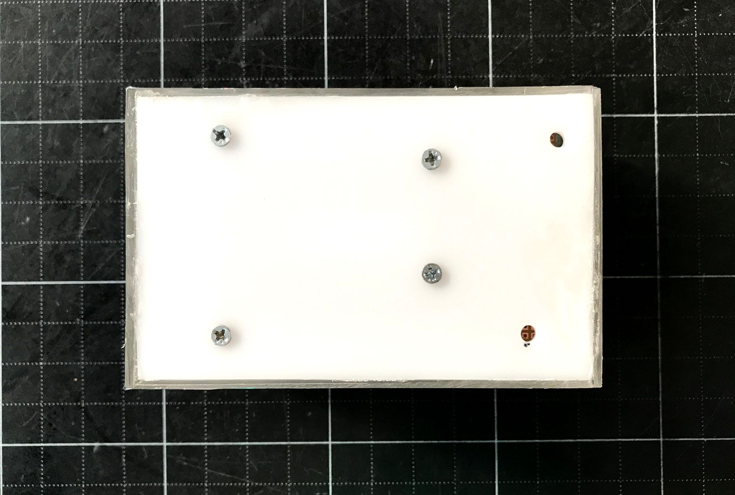

- Covering by a small box
- At back side of box, we drill 6 holes to ensure that UNO/ MEGA/ WEMOS can be mounted by these holes. Picture below I used WeMos to control this led matrix.
