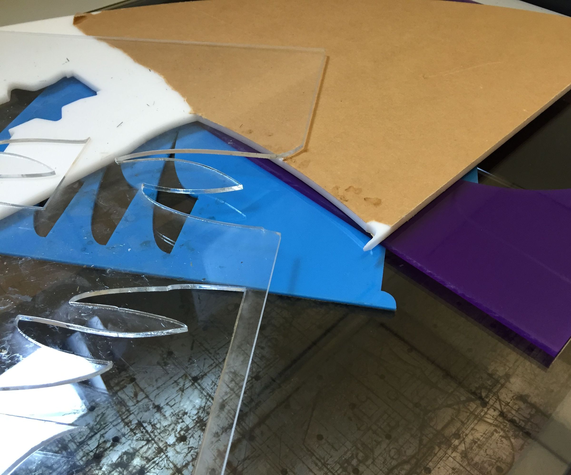

Step 16: Go to Zotebook.io to Get a Pdf File to Laser Cut or Print.
On the Zotebook website you can sign up to download laser cutting and 3D printing ready files.
