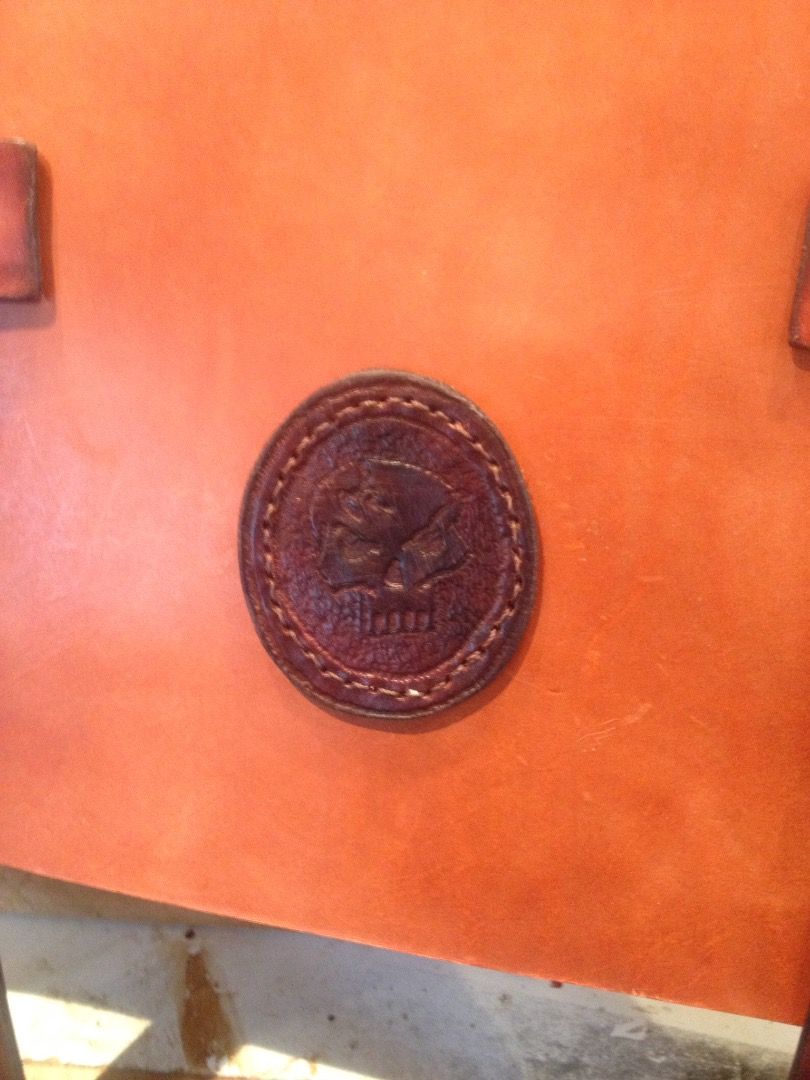

I forgot to take pic's as I worked here because I was frustrated. I had been too distracted by taking pics for everything that I had glued the liner on my front piece before it was ready. I just meant that I was going to have rivets showing on the inside of the liner but It still made me mad... Anyway....The tuck catches come in two main pieces: male and female. I think you can figure it out. So attache the male parts on to the flap where they need to go making sure everything is lined up. I had to trim the liner on the inside of the flap where they go because the leather was to thick. I also hid a rivet in between the slot for the catch to really secure the straps from moving at all.
Once done with that cement liner in place
