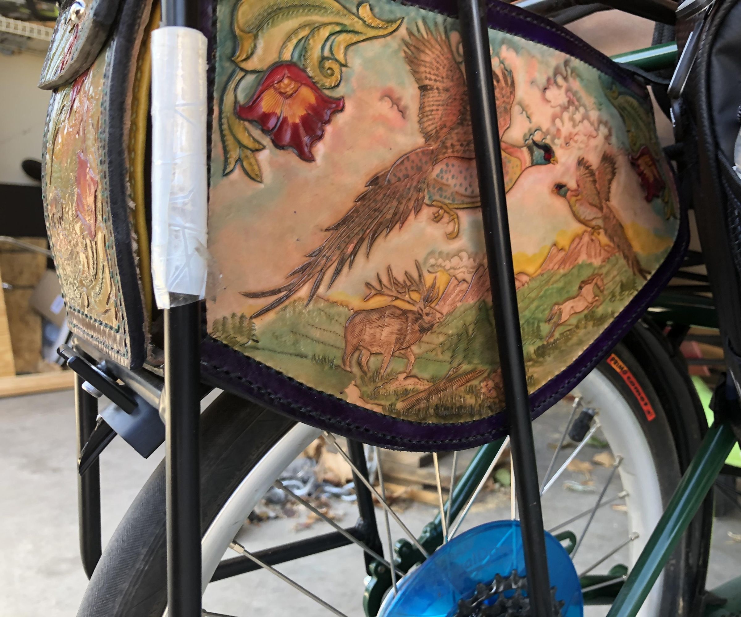

Introduction: Leather Painting
My take on colouring a leather project. Hope you enjoy.

Step 9: Apply Antique
Using liberal amounts of antique black I rubbed on, then wiped up. Polishing it up as I pulled the excess off.
Final step was to add all the hardware and polish up the leather with a good coat of leather rub to bring it back from all the drying the tooling and painting took out of it.
If you've made it this far, thank you for looking. Have an awesome day!
