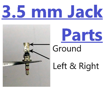

Step 2: Preparing the 3.5 Mm Jacks
NOTE: If you get wires Pre-Soldered on the jack then you can simply skip to the Next Step but If you get the Jack only then follow this step.
First we are going to get our Jacks ready. In a 3.5 mm Jack you will find 3 parts (Terminals) as shown above.
The Highest Part is known as GROUND.
The next 2 Shorter Parts are known as LEFT and RIGHT
  1. Unscrew the Cap on the Top of the Jack
  2. Solder a wire on the GROUND first.
  3. Then Strip a wire longer from the front and solder it on the both shorter parts ( LEFT and RIGHT ) from one side only
  4. Pass your both wires through the hole on the cap and screw it back on
  5. Repeat the same steps for the other jack too and your both Jacks are ready to go
