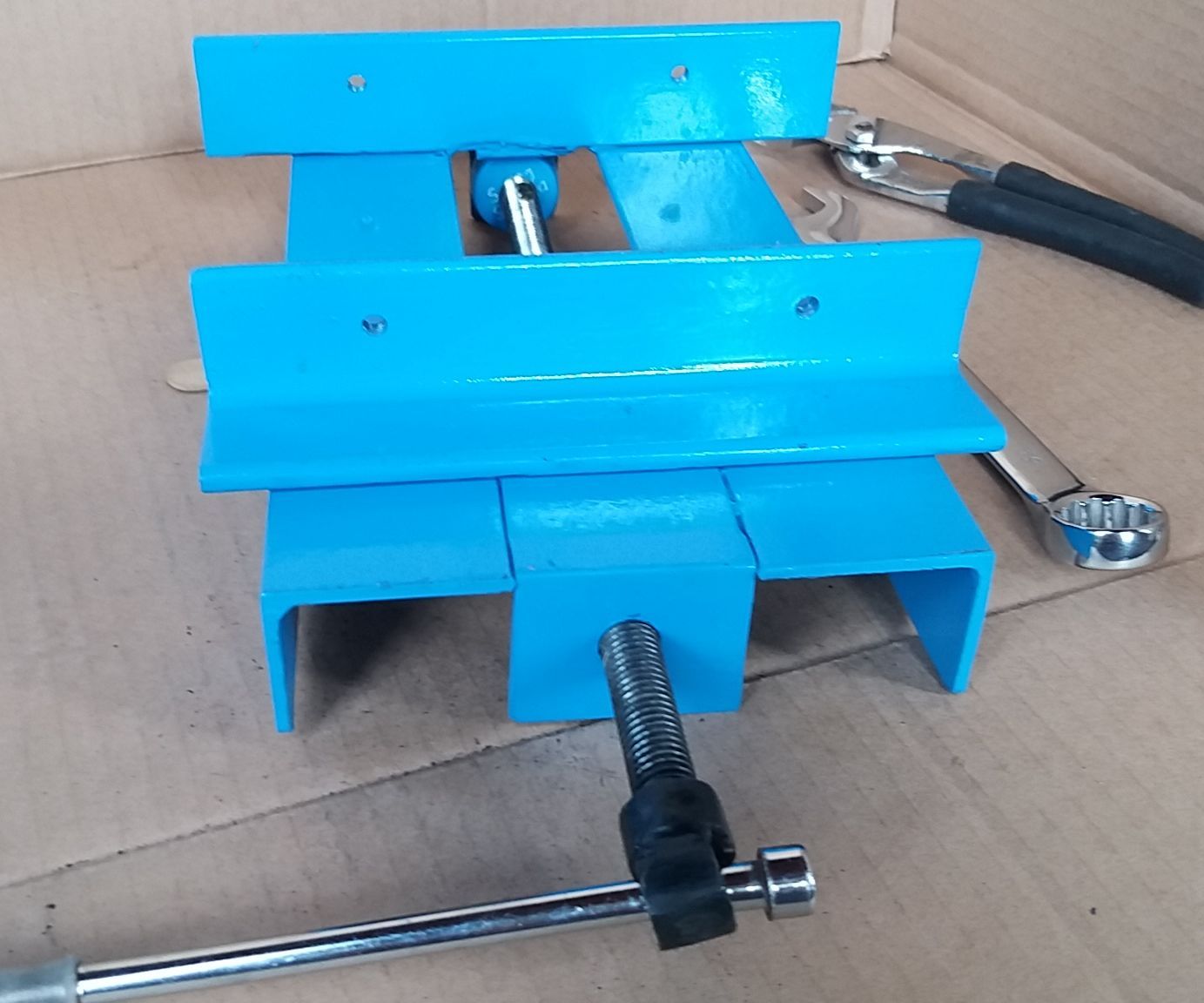

The metal frame is very simple.
PHOTO 1-2> Weld the three pieces of metalon, the two of 32cm are vertical and the 28cm horizontal
In the upper part it has made a hole ½ "and one soldier nut ½";
Photo 3-6 > was welded two bars plates of 7/8 "x 20cm on each side. The holes were made according to the screws of the table;
On one side of the structure were welded two pieces of round bar 5/16 "and the other side only one also of 5/16".
At the other end of the 5/16 round bar "was welded a small piece of flat bar of 7/16 x 1/8" with a hole in the center.
Detail to be observed is that to have a perfect fit this part in the process of assembling the structure, where were welded the round bars of 5/16 ", the equipment was coupled to the structure.
Step 3: Handle
PHOTO 7-9> At one end of the threaded bar, roughen until the tip snaps into the bearing bore;
At the other end a chamfer was made to allow the recess in the flat bar that had served as the crank arm.
PHOTO 10-14> Next step and prepare a flat bar piece of 12-15cm. On one side a ¼ "hole was made to fix ¼ x 5" bolt;
At the other end a 5/16 "bore was made and with a jig saw the contours were given to fit the fit on the threaded rod;
To finish this step the assembly is done as the photos show.
