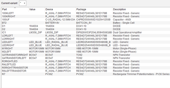

1 IC LM358P
1 8pin IC holder
2 Transistors BD139
2 1kΩ resistors
2 100kΩ resistors
2 10kΩ resistors
2 blue LEDs
2 LDRs
2 diodes
1 100µF Capacitor
1 50k Potentiometer
1 battery pack
2 wheels
2 motors
2 small perf boards
1 switch (optional)
a couple of nuts and bolts
a couple of jumper cables
access to soldering iron and solder
access to a 3D printer
Autodesk account for Fusion360
some budget for the PCB (I spent approximately 2 USD for 8 PCB boards)
some passion and creativity!

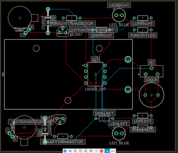

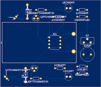

Step 1: Receive the PCB
First, we need our PCB to get things started. The schematic for this PCB is attached as a photo above but I highly recommend using my already-made file and sending this to an external supplier. The photos are the schematic, the PCB layout, and the PCB design red is the top blue is the bottom.
This Google file has everything needed for your circuit (This includes the Gerber files that you will need to send to the external supplier)
https://drive.google.com/file/d/13iip1R1UNj7a4yf4HGUV1jxkZFb22mx1/view?usp=drive_link
This is the external supplier I used to get my PCB
https://jlcpcb.com/
So how does this circuit work?
This circuit has 2LDRs, the input, the off-pound IC, the process, and the motors, the output. The left and right LDRs are light sensors that will give different voltages, the IC will compare the two and then "tell" which motor to move so that the robot moves towards the light.

Step 3: Solder the PCB
After having received the final PCB put in your components and make sure that if they are polarised components they are put in correctly and check where each component goes. The photos should be clear enough to check where each resistor goes. Solder accurately and quickly so you don't burn the PCB and accidentally damage the circuit.
