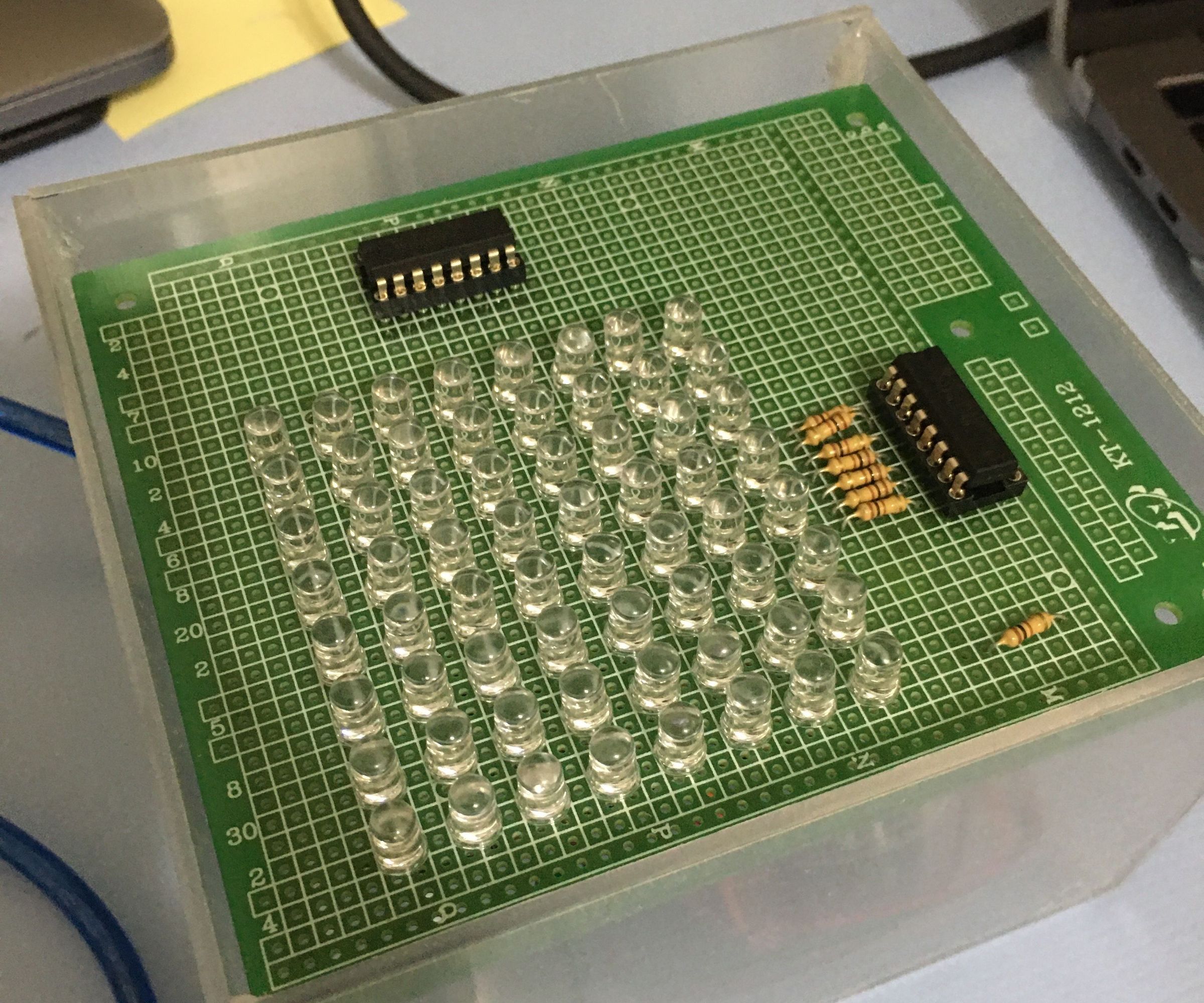

Step 8: LED Lights ON
As the same as before, always first mark the position before doing any action. First draw out where the LED should be placed then use sharpe file to dig out the hole. The hole should be a the middle of the board. For the round circle design board, one LED is required. For the bubble and air popping design board, two RGB LED lights are required. Next, tug the board into the trenches and check the height. Hold the board and glue the board with hot glue and wait for it drys. When the position is set, use the hot glue to stick the LED lights into the hole. If you can keep the light horizontally with the board, the result will look better.
Step 9: Place the Bottom Plate On
For the convince soldering all the pins and fix them if something bad happens. I decided to add a hinge to it. Before adding the hinge on, we must make sure all four sides are flat to others. If not, then you may use a planer to remove all the unnecessary height. Both the top and bottom should be flatted. Four screws are needed in this process. Firstly, mark where the hinge should be, then use the drill to dig out the guide hole on the side and bottom plate. After, screw the screws with a screwdriver into the plate. The screw might stick out the wooden plate. When this happens, use the flat file to flatten the screws.
Step 10: Solder Pins Together
This step, I connected all ground pins together (all LED lights) and connect it with a black ribbon cables. Next, bend the pin that displays red light on the RGB LED light. Time time I chose for the light to show a cold color, so red looks abrupt in the combination. After then, solder each positive side pins with ribbon cables. In total, six positive pins and one ground pin are used. While connecting the ribbon cable with the pin, add some solder onto the wire. This allows you to connect the wires with the pin more efficiently.
