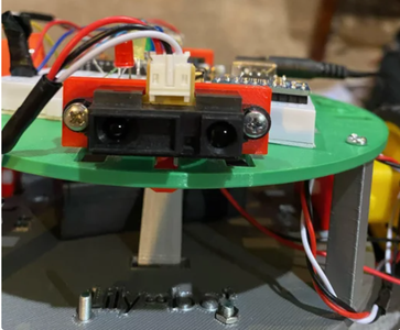

  • Use the two 6 mm screws to attach the Arduino uno to the upper chassis
  • Tape two mini breadboards next to the Arduino uno as shown in the image
  • Place the TB6612 motor controller on the breadboard to be wired later
  • Place the 4 LEDs on the breadboard to be wired later.

  • Line up the chassis so that the Lily∞Bot words face the same way
  • Use the eight 8 mm screws to attach the 4 standoffs in the four corners
