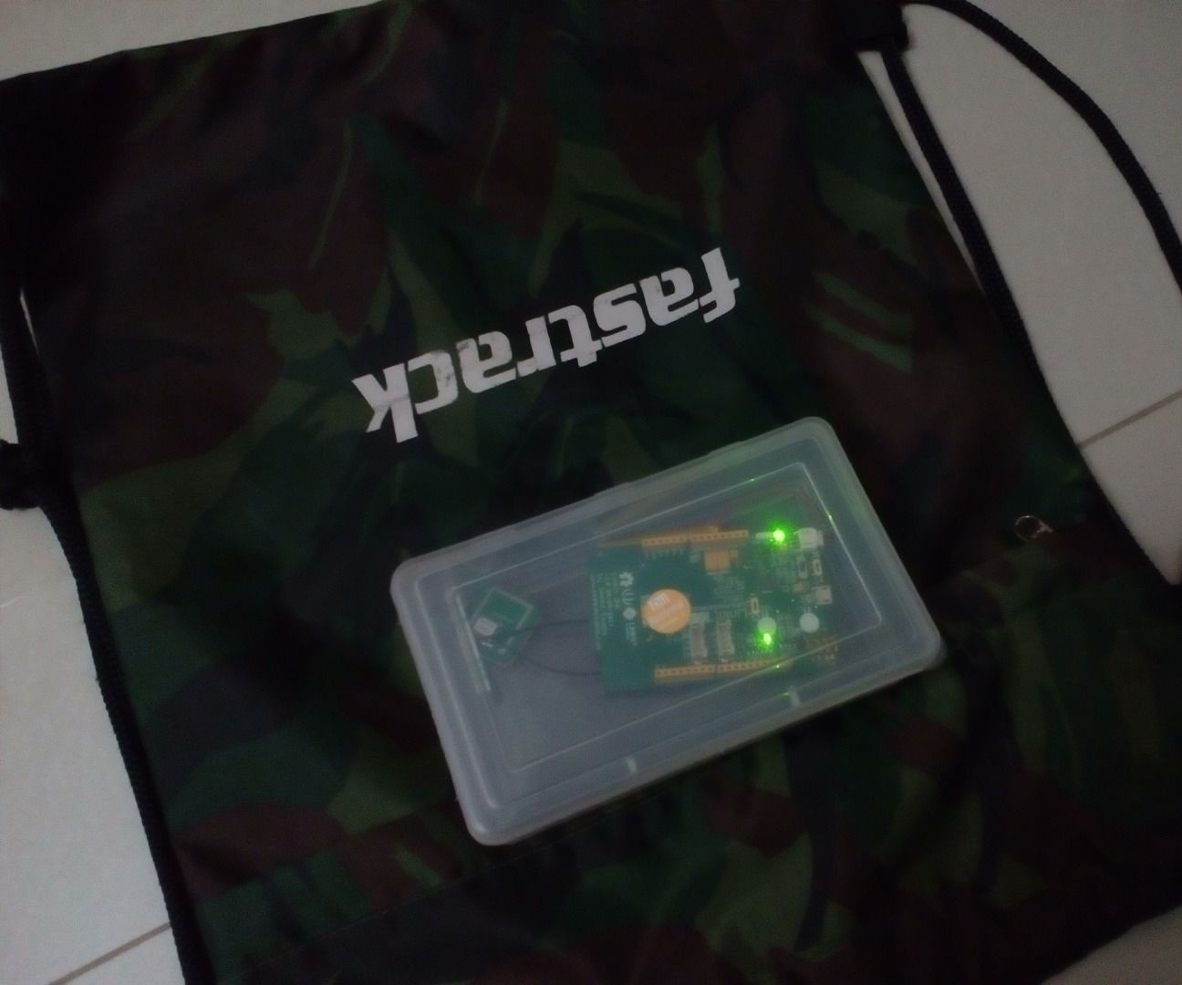

1) Connect LM35 Vcc and Gnd pins
2) Connect LM35 output pin i.e center pin to the A0 (analog 0 ) of Linkit ONE board and connect the board to USB port
