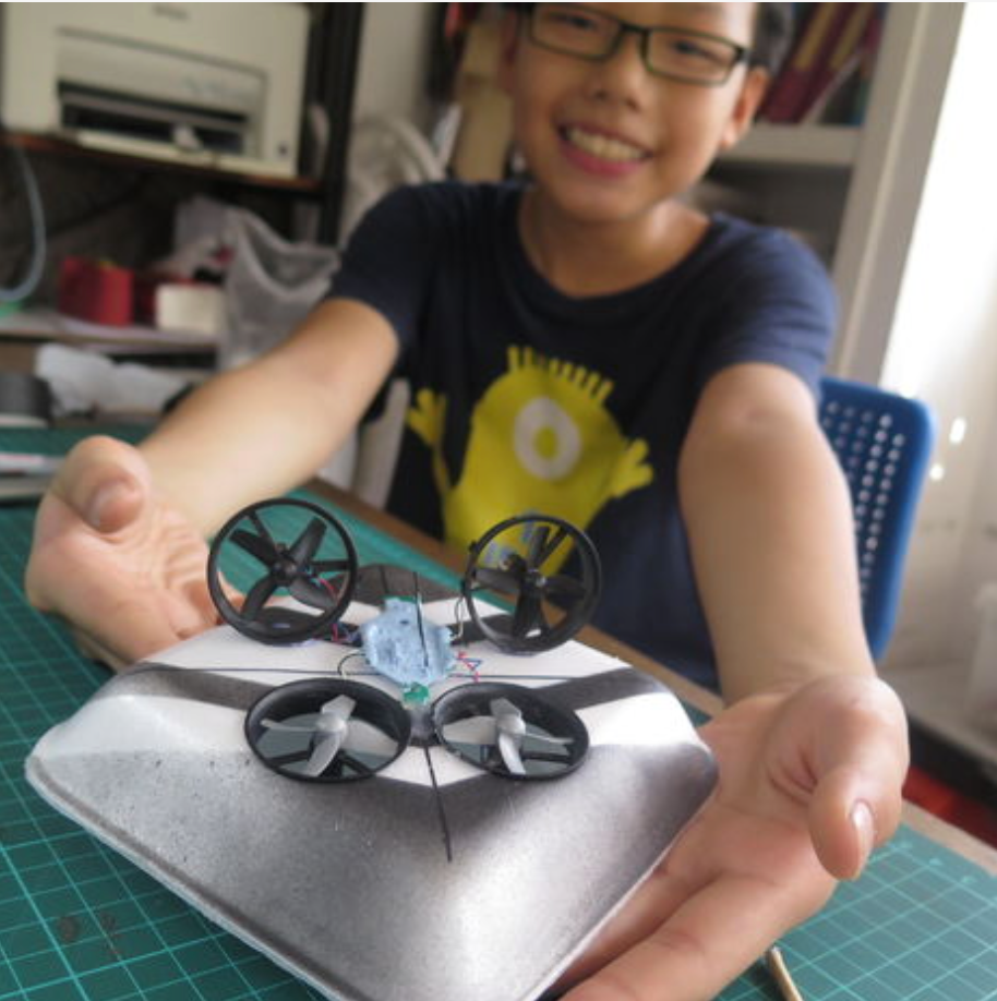

Sushi from supermarket always comes with an EPS Box tray. It's kind of waste if we throw it away when we finished the sushi. Finally, I thought of a way to up-cycle the boxes, it is to make a EPS box hovercraft. With the help of my elder brother, I finally have my 1st intractable done. Woo!!

-inset the front motors into the recutted round holes
-cut a small hole on the box so that the PCB can lay flat on the box surface.
-then put a little drop of hot at the very fun end of the PCB & stick it on the box.

Step 12: Final Step
-cut a small hole like photo to allow the battery cable lay properly inside the tray
Now the hovercraft is ready to play
-install battery & bind the hovercraft with your controller.
Step 13: Test Run & Tuning
You can make the hovercraft flow higher & run faster by cutting more holes on the bag. However, too much holes can make your hovercraft fail. Try it bit by bit until you get the optimal floating performance. My experience is 5 holes of 1cm width at each of the 4 corners is perfect for my hovercraft.
