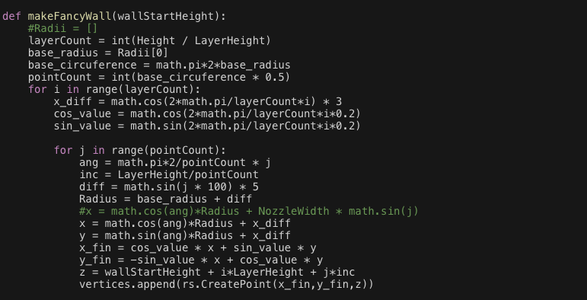

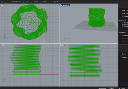

For my design, I modified the parametric cylinder with base. For each layer, I added a sin function to the circle to create an alternating star pattern. I also had a cos function of layer count to make the circumferences of layers alternate in a periodic way. On top of that, I rotated each layer. My code and design preview are shown in the images.
