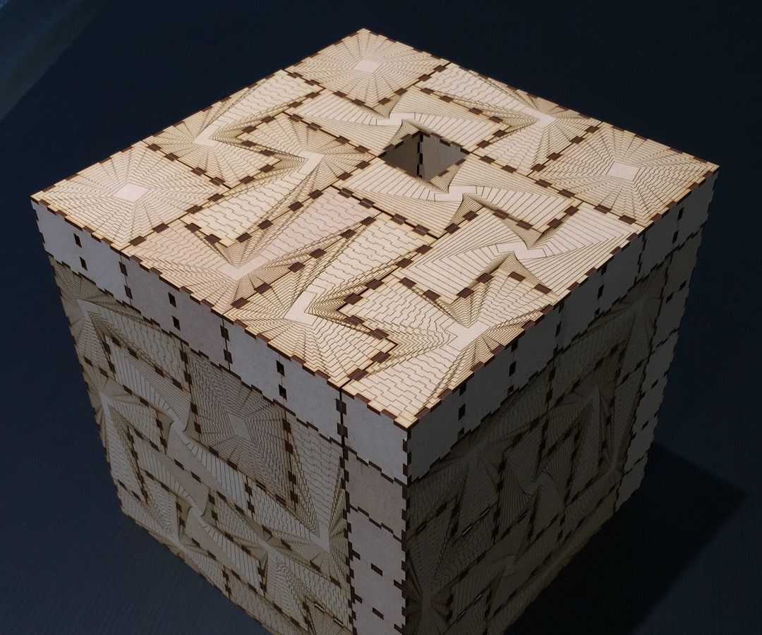

Step 2: Cutting Out Parts by Laser Cutter
IMPORTANT: Before cutting out all parts, confirm the press-fitting strength and engraving depth. I recommend you to assemble two cubes before cutting out all parts to confirm press-fitting and magnetic force.
For your reference, measured actual press-fit-margin and engraving depth data is attached (file: calculate kerf-loss and press-fit-margin.pdf). This press-fit-margin may be a little too hard to assemble, but I’ve never experienced broken-up without adhesive even if a cube is falling on wood floor.
- Cutting out from MDF thickness 2.5mm
- cube face: 3 kinds of shapes x 2pcs / one cube
- To assemble faces securely without adhesive, they are press-fitted hardly. You may need adjust the size of fitting.
IMPORTANT PROCESS: Before cutting out all parts, confirm the press-fitting strength and adjust size and/or laser-cutter parameters. Assembling with adhesive is available. - Mad black square of the cube-face.pdf file means engraving area. Adjust the power of laser cutter to engrave its depth between 1.2mm and 1.5mm.
IMPORTANT PROCESS: Before cutting out all parts, confirm the depth of engraving and adjust laser-cutter parameters. Shallow engraving leads to week magnetic force, deep egraving may lead to fragile face. Too weak magnetic force to chuck another cube is not available.
- magnet case: 2 kinds of shapes. magnet-case-with-hole:3pcs & magnet-case-without-hole:1pc / set * 6 sets / cube
- Cutting out from MDF thickness 5.5mm
- jig: 1pc (2pcs, if substituted 2.5mm for 5.5mm)
Step 3: Assembling Mag?CUBE
- remove burnt residue on the engraved area using cotton swab.
- make a jig for assembling magnet case
- cut three toothpick to length 13mm(= total thickness of assembling MDF 5.5 + 2.5*3)
- insert toothpicks into the holes of jig with adhesive.
(if substituted 2.5mm, pile up 2 pcs and adhere before insert toothpicks.)
- adhere magnet case parts on the jig. Pile up three magnet-case-with-hole and a magnet-case-without-hole on the jig.
- clump the case assy on the jig, and remove. clump the center of the magnet case assy for curing time.
- set a manget on the engrabed area center.
- adhere magnet case on the face
- take care not to contact magnet with adhesive
clump for curing time.
before assmbling, shake the faces with magnet case and hear the sound, to confirm magnet shaking freely.
- firstly, half press-fit (not press-fit completely) all faces.
- secondary, press-fit gradually on each press-fits by fingers.
- finaly, press-fit completely using a rubber hummer.
- shake and hear the sound to confirm magnet is shaking freely.
confrim each faces can be chucked by another cube.

Question 2 years ago
Very clever, the design.
But I have a doubt,
What is the mission of the 4 slots in the jig pieces?
Thank you
Answer 2 years ago
Thank you for your comment and good question.
Your inquiry the 4 slots in "the jig pieces” suppose to be "the magnet case” set on the jig of the first photo on step3. If it is right, the 4 slots around the center hole prevents adhesive from oozing into the center hole. I want to reduce the risk for the magnet fixed in the case by the oozed adhesive. Please inqure me if this is a misunderstanding reply.
