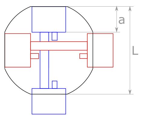

Since in my example, the diameter of the holes is h = 32 mm and the diameter of the sphere is D = 84 mm. L can be calculated with the following formula: L = - D + 2 · sqrt (D² - h²) = - 84 mm + 2 · sqrt ((84 mm)² - (32 mm)²) ≈ 77.6 mm.
We defined a = 23 mm and the thickness of the pole going through is p = 8 mm.
Therefore the distance holder needs to be slightly less than L/2 - p - a ≈ 7.8 mm. As I said above we are going to go with 7.5 mm.

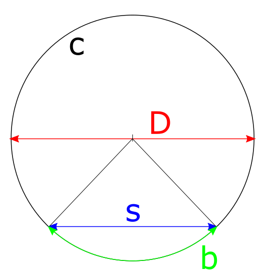

While still on the lathe mark a circle as shown in the third picture about 1 cm from the sides. Measure it.
The circumference is calculated with c = D · π. "D" is the diameter.
So if its diameter is 13 cm the circumference is about 47.12 cm. Divide your result by five (since we are using five screws). This is the arc length in this case it is about b =9.42 cm.
Now you have to calculate the chord length with s = D·sin(b/D)
Make sure that your calculator is set to radiant. In our case, the chord length is about 8,8 cm. Set your compass to 8.8 cm and mark where you have to drill as shown in the third picture.

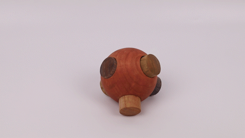

As you can see in the picture I added some color to the wood since I knew that my son would prefer colorful pieces. Make sure to use paint or like in my case glaze that is approved for baby toys. I used glaze since I wanted it to still look like wood.
As I have written in step 6, the assembly is a bit hard to photograph. Take a look at step 6 to see digital images of the assembly.
I suggest to try to fit the pieces without glue first to make sure everything works and has the right measurements.
Simply use glue to hold the pieces together. Congratulations, you are done. Have fun fidgeting.
