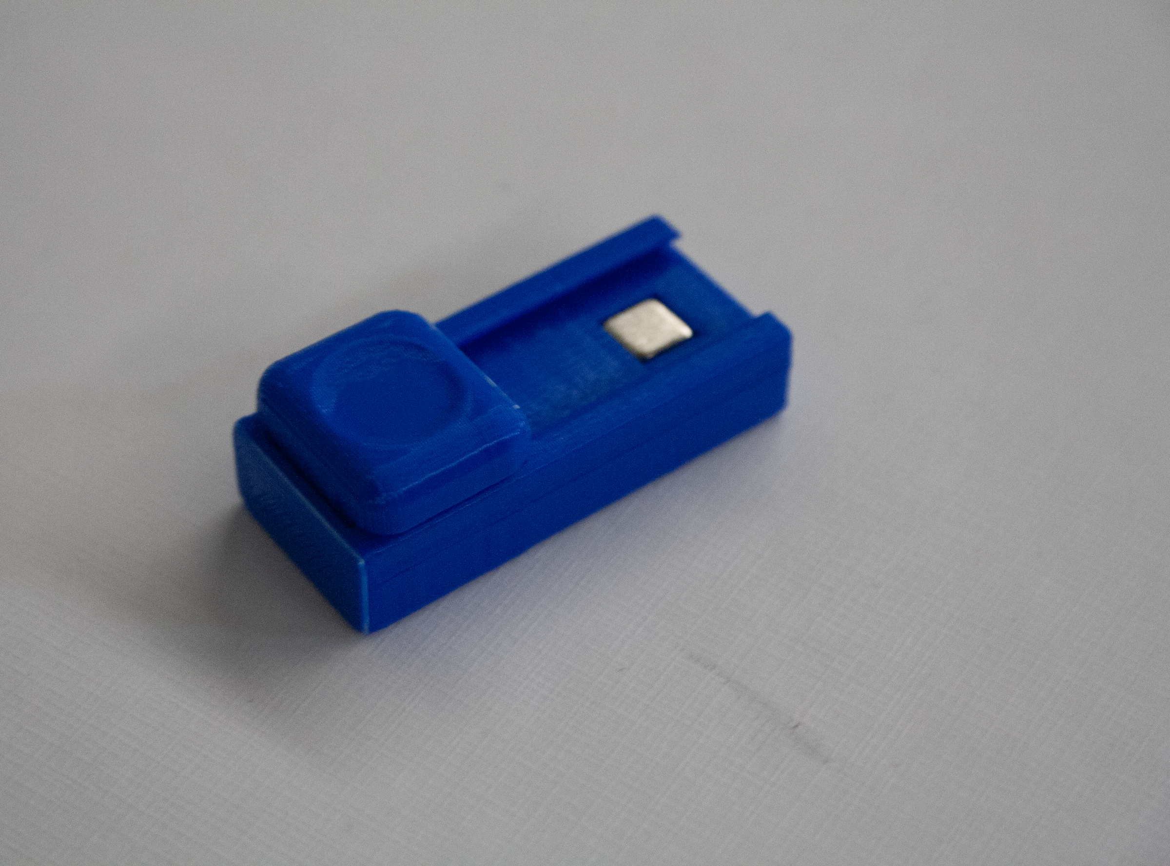

Whenever I have my keys in my pocket, I'm afraid they might fall out, if I move around a lot, so I fixed the problem with 3D printing and some magnets.
I used some 5x5x5 mm neodymium magnets and a 3D printed part.
You can get the magnets here
The STL and Fusion360 files are included in this Instructable
Step 1: Printing the Part
Print the file with your 3D Printer
  • For best results use a flexible material like TPU
  • Use a brim for better bed adhesion
Step 2: Insert the Magnets
Insert the magnets into the holes
You might need to use a hammer to get them into place.
Important: The magnets must have a different polarity when inserted, otherwise they will not attract.
Step 3: Attach the Clip to Your Pocket
Put the ring with your keys onto the "bridge" between the magnets and clamp the clip to some of the fabric of your pocket.
