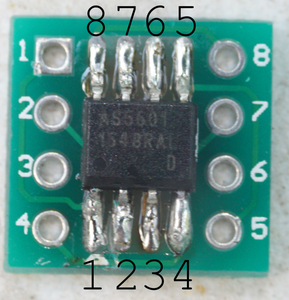

Step 1: Solder to Breakout Board

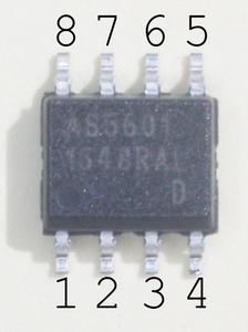

It's really crucial that the AS5601 chip be centered on the board so that the center of the magnet is no more than 0.25mm from the center of the chip. I have a little 3D-printable jig for centering.
To solder the chip, put a dab of tacky PVA craft glue (I use Aleene's) in the center of the PCB. Orient the chip so that its pin 1 (see photo) is connected to the pin labeled 1 on the PCB (My PCB has different numbering on the top and bottom, and it is the top numbering that is right for it) and place it in the jig with the PCB on top. Center the chip (see below for details). Wait for the glue to set (30-60 minutes), remove from jig, and solder with fine solder and a fine-tip iron.
The potentially tricky thing is centering the chip. Once the chip is in the jig, you can shift it slightly by poking it with a fine screwdriver. My first try was just to eyeball it, and that is the PCB that I have in my spinner--it works fine. But if you want verifiable precision, read on for another way I found.
Precision Centering
First take a macro photograph of the chip, carefully ensuring the camera is vertical. Import the photograph into Inkscape or some other image editor (I prefer vector to pixel for this), and draw some lines from opposite chip features, like opposite corners of the chip or places where the legs come out of the package. (Be careful: the AS560x has asymmetric beveling on the top surface. It is the bottom surface that needs to be centered, I believe, not the top surface.) I would do several of these for greater precision. See screenshot.
For me, this identified the lower right bump of the "8" in the second line of text as the center of the AS5601 (and when I tried it with an AS5600, it was the lower end of the stroke in a "5"). I also drew a red circle of radius 0.25 mm (I knew the chip package was 4.9 x 3.9 mm, so I could scale it) to see what my placement tolerance would be.
The centering jig has a sighting hole. You need to align the part of the chip you identified as the center in the sighting hole. If you have good eyesight, you can eyeball it. I also successfully used a microscope. But the best method for me was to use an illuminated magnifying glass.
Once you are done soldering, you can take another macro photograph and verify centering on the PCB in your image editor.

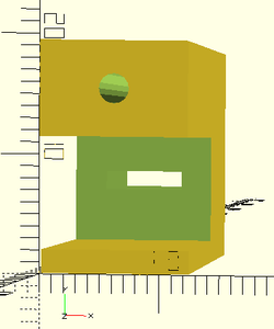

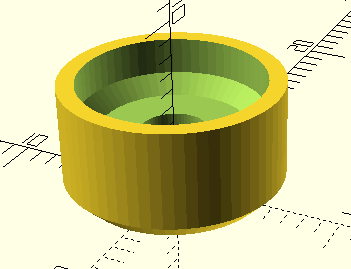

Download the 3D printable files. If you use the same size PCB as I have (11.94 x 11.58 mm), you can just print directly. Otherwise, you will need to change pcbSizeX and pcbSizeY in the OpenSCAD file. (If the sizes of these are large enough, you will need to enable supports when printing.)
At this point you want to decide if you want the simple top-mounted tactile switches for buttons 3 and 4 that I had in Version 1, or if you want the fancier 3D-printed buttons 3 and 4, and choose the matching version of the top plate.

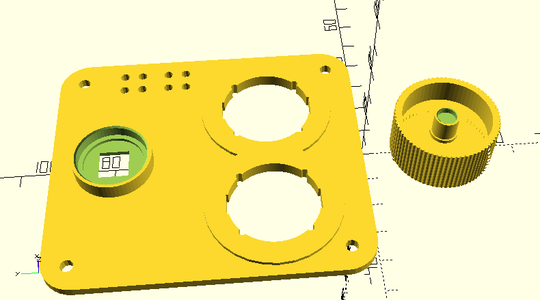

Print the knob and top plate of the spinner box.
Press fit the magnet into the depression in the knob axle, and press fit the bearing over the axle.
This is a good time to check that the pin numbers on the PCB match the ones on the IC (use a continuity tester).
Make the following connections between the sensor PCB and the blue pill, ensuring the wires come out of the bottom of the PCB and into the top of the blue pill PCB:
  • sensor pin 7 (SCL) to blue pill B6
  • sensor pin 6 (SDA) to blue pill B7
  • 4.7K-10K resistor between blue pill B6 and ground
  • 4.7K-10K resistor between blue pill B7 and ground
  • sensor pin 2 (3V3) to blue pill V3
  • sensor pin 4 (GND) to blue pill ground
Press fit the PCB with the magnetic sensor into the rectangular hole.

Snap arcade buttons into the two big button slots on the top plate for buttons 1 and 2.

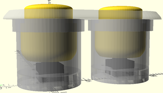

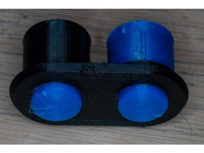

For Version 2, get the 3D print files for the buttons. The wells and plungers for the buttons are designed for 5mm high (from base to top of button) tactile buttons. If yours are a different size, use the Thingiverse customizer or OpenSCAD to change them (the crowns don't care about the button height). Print two wells, two plungers, and an x2 crown (with two holes). I recommend printing the wells and plungers with as high resolution as you can to make the vertical motion less bumpy.
Straighten the legs of the button and fit it into into the well with legs sticking out the button (this is tricky; I used needlenose pliers to fit it, and you may need to tweak the tolerances in the customizer or sand a little to fit). Put the plunger on top (with the stepped side up). Make sure that the wider part of the plunger does not protrude at all beyond the top of the well or else the button won't work reliably; if you have this problem, increase the vertical tolerance. Snap into a crown and make sure it works. For smooth motion, you may want to sand the inside of the wells and the edges of the plunger.
Then glue the well into the crown with a bit of superglue, and put some drops of superglue into the button slits by the legs. Glue the whole button assembly into the top plate.

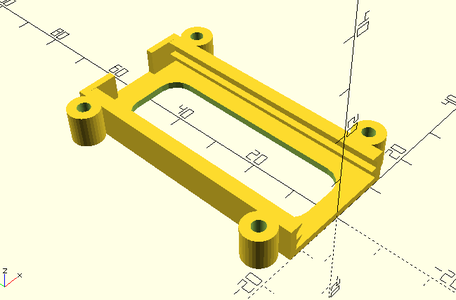

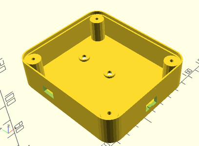

Print the bottom of the case and the PCB holder for the blue pill. Slide the blue pill PCB into the PCB holder. Screw it to the bottom of the case. Screw on the top. And you should be done, unless you want to do the nunchuck connector (see last step).

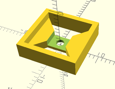

Print the nunchuck adapter holder. It will be oriented as in the picture above (screw hole at the top) looking from the outside of the spinner box.
Press fit the nunchuck adapter board into the rectangular hole. The adapter board has three traces on the top side and two on the bottom side. It should far enough into the rectangular depression in the holder that contact can be made by a nunchuck from the outside of the box. Put a small screw from the outside of the box into the holder to keep it in place, and consider gluing the bottom of the holder to the buttom of the box.
