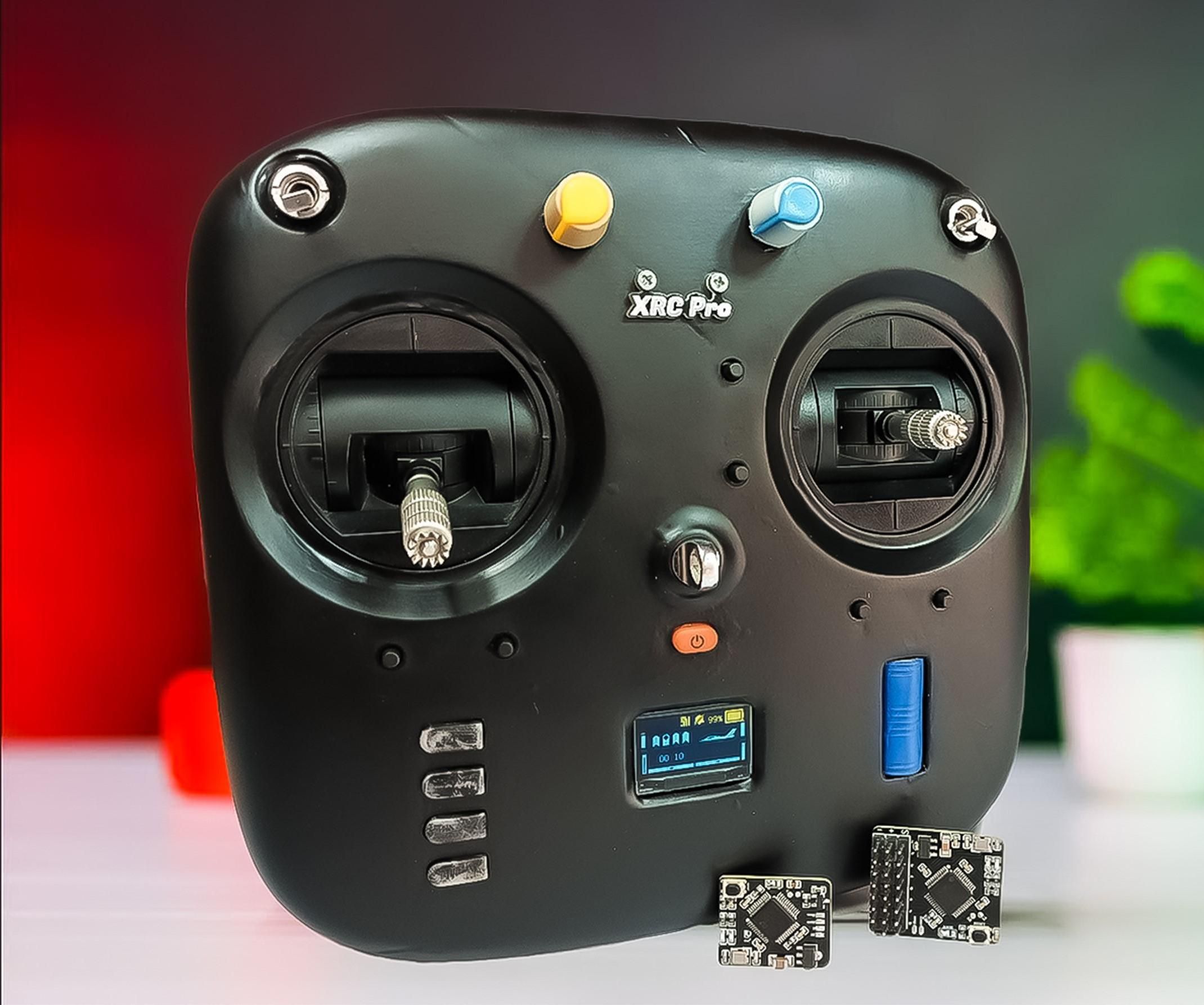

Transmitter (TX) Working
User Interface Initialization:
  • Upon power-up, the STM32F103C8T6 microcontroller on the transmitter initializes the user interface, activating the 0.96-inch OLED display to present the main menu.
  • The menu system is designed to facilitate easy navigation and configuration of various settings.
Control Inputs Processing:
  • The dual pots and switches on the transmitter provide the user with tactile controls. These inputs are read by the STM32F103C8T6, allowing users to adjust parameters such as stick calibration, channel tuning, and mode selection.
Data Encoding and Transmission:
  • User inputs and configurations are encoded by the microcontroller into a data packet.
  • The NRF24L01 wireless module is then employed to transmit this packet wirelessly to the receiver.
PPM Output for Simulator:
  • If the simulator mode is selected, the transmitter generates a PPM signal based on user inputs and transmits it through the NRF24L01 module.
  • This facilitates a realistic training environment for RC enthusiasts using simulators.
Audio Feedback with Buzzer:
  • The microcontroller triggers the buzzer to provide audible feedback for specific events, warnings, or successful execution of user commands, enhancing the user experience.
Customizable Channel Configuration:
  • Users can navigate through the menu to configure individual channel settings, including inversion and tuning.
  • The transmitter stores these configurations for precise control over connected devices.

Transmitter PPM Output:
This diy transmitter is capable of giving ppm signal output through aux port to play any pc fpv or simulator with this.To enable this option you have to go to output setting on transmitter oled menu and then you have to turn on the ppm output.
Note:When you are using this transmitter with receiver.Makesure to turn off the ppm output.Because its high priority signal.
Receiver Output Signals:
The receiver that i made is capable of giving 8 CH PWM,PPM and also SBUS signal.You can use this receiver with rc car,drones and aircraft.
For Binding:
You have turn on both the transmitter and receiver.Then you have to press reset button of receiver and then the receiver will automatically bind to the transmitter.
