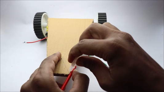

Step 1: Preparing the Base
The 3D design is made with the TinkerCad application and you can use my STL from the file below.
You have 2 options here, one is a 3D printed part and the other is cardboard.
The 3D printed frame I showed here is very strong and is printed with PLA filament, You can choose filament color as you wish, As most of my readers might not have a 3D printer we will proceed with the other method.
The template that I made to make the body was based on BO motor design consideration.

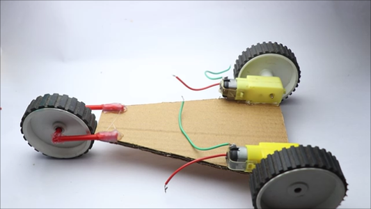

The same template was traced onto the cardboard and this became the base of our robot car, you can 3D print too like I said earlier.
Once the base is ready we can glue the DC motors, wait for the glue to dry and the wheelbase is almost ready.

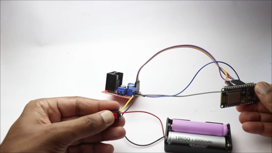

Step 2: Circuit Diagram
This is the circuit that we are using for this robot car, we will not use any breadboard instead we are using the jumpers directly between the components.
Before making a connection make sure that the ground of the battery is connected to the motor driver along with GND of the Nodemcu board.
The positive of the battery from the holder is connected to the 12v slot of the motor driver and the 5v of the motor driver is connected to Vin of the Nodemcu board
Now for the communication the connection between the motor driver and Nodemcu is as follows
  • ENA To GPIO14 (D5)
  • ENB To   GPIO12 (D6)
  • IN_1 To GPIO15 (D8)
  • IN_2 To GPIO13 (D7)
  • IN_3 To GPIO2 (D4)
  • IN_4 To GPIO0 (D3)
In the end, I will connect the BO motor terminals to the motor connection slots on the motor driver.

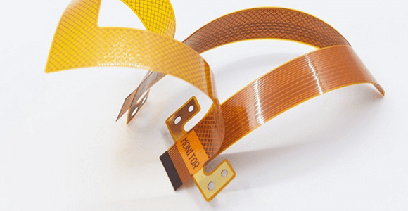

A revolutionary solution that combines the best of both rigid and flexible circuitry to elevate your electronic projects to new heights.
With their expertise in advanced manufacturing techniques, they offer a seamless integration of rigid and flexible components, ensuring enhanced reliability, durability, and space-saving benefits
Check Here for Rigid-flex Pcbs with this your circuit becomes flexible! i have added the images on this step kindly check

Step 3: Arduino Codes
Connect the board to the computer using a programming cable.
Open arduino ide copy the below codes and paste them into the IDE.
If you wish to have your custom name for the Wi-Fi you can edit my name on the code but if you are not aware of this fully I recommend not to make any changes.
Click on the board and select on esp8266 module board, Now check for the proper com port number and click on the upload code button.
After some time the code will be uploaded to the board and the board now has the code.
After this is done test the project by switching on the power supply from the battery, when you switch on the button if everything is fine the Nodemcu LED glows and you can see the wifi name on the mobile phone.

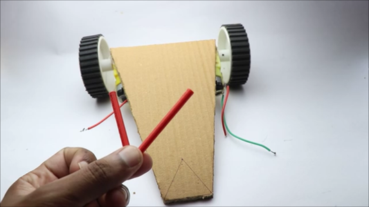

Step 4: Adding Front Wheel

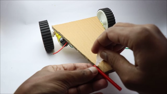

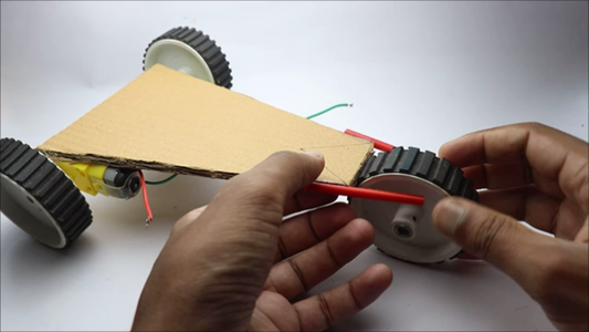

Since the robot car that we are building has only 3 wheels, the front one is just the free-moving wheel.
The other 2 wheels are held by the motor shaft, Now for this we are using a simple mechanism, All we have to do is use a straw or a piece of tube.
If you don't find any tube you can prepare it yourself, just roll the strips of paper into the tube and strengthen it with drops of superglue.
Place on the tip of the cardboard and secure it with super glue.
Now you can add the wheel and lock it from the center using the tube or your homemade paper tubes!

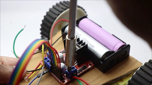

Step 5: Finishing

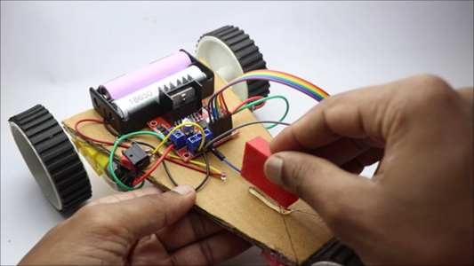

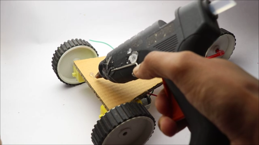

I will start this step by adding a drop of hot glue to the cardboard followed by adding the lithium-ion battery holder with batteries.
Next, I secured the motor driver to the cardboard, we can add the wires of the BO motor to the driver slots.
In the end, we can place the Nodemcu board, Instead of placing this board directly on cardboard i have used a small piece of plastic square frame.
I glued this frame first followed by adding the board later and adding a tiny amount of less hot glue.
By the end of this step, the model is ready and now we can move to test this robot car.

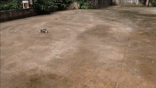

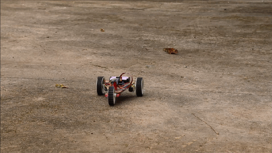

Step 6: How to Use
Establishing a connection between the robot and the smartphone(control device) is very easy.
We will be using the Wi-Fi connectivity, Switch on the Wi-Fi on your phone first and later power on the car.
You will see the name of the wifi that was given to the car on the smartphone, Connect to the network.
Now you can open the application that is pre-installed on your phone, And there you go you will have the digital on-screen remote by which you can control the robot car in more than 4 directions.
You can just see from the image that how cool the car works and it's truly a joy for the creator to see his creation in action.
