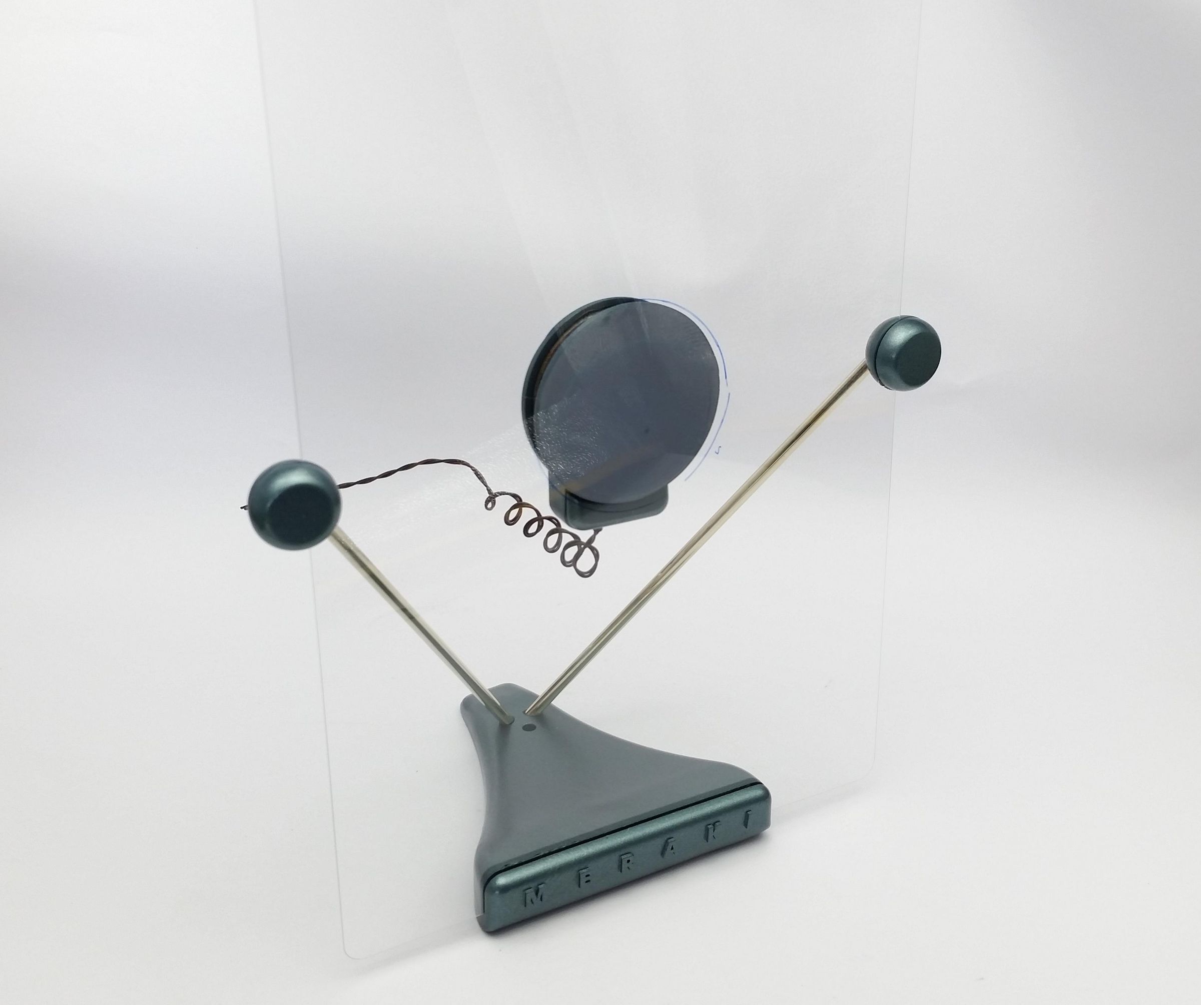

The solution hit me when my friend brought me his phone for a screen replacement, the replacement came with a free tempered glass screen protector, I got an idea...let's just test it out....
To my surprise even with my little 3W test rig exciter this piece of 6 inch glass sounded good and I mean really good!
I hopped onto the internet and found some discounted 10.8inch tablet tempered glass screen protector for only $2!
For my next iteration of the build I'd like to try and get some MacBook screen protectors to try ~14inch size panels.

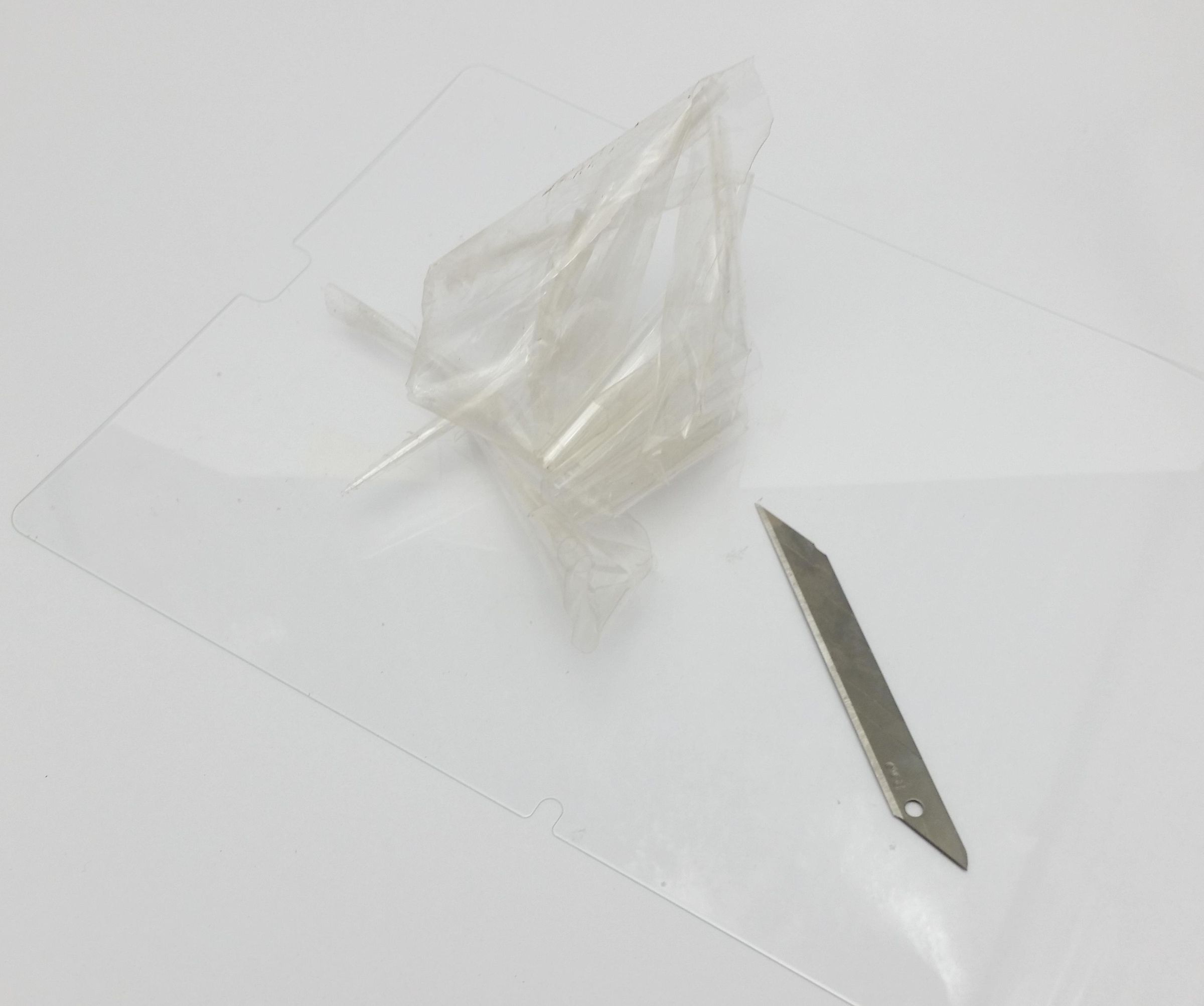

First thing I needed to do was to get rid of the silicon adhesive on the protectors, I when through my chemicals and nothing dissolved the adhesive!... frustrated I started scraping at it that's when I realized the adhesive layer is a sticker. 🤦‍♂️
By using a heat gun I heated the glass protector and started tearing off the film in sections to avoid putting too much force on it and risk breaking it, remember this glass is THIN.

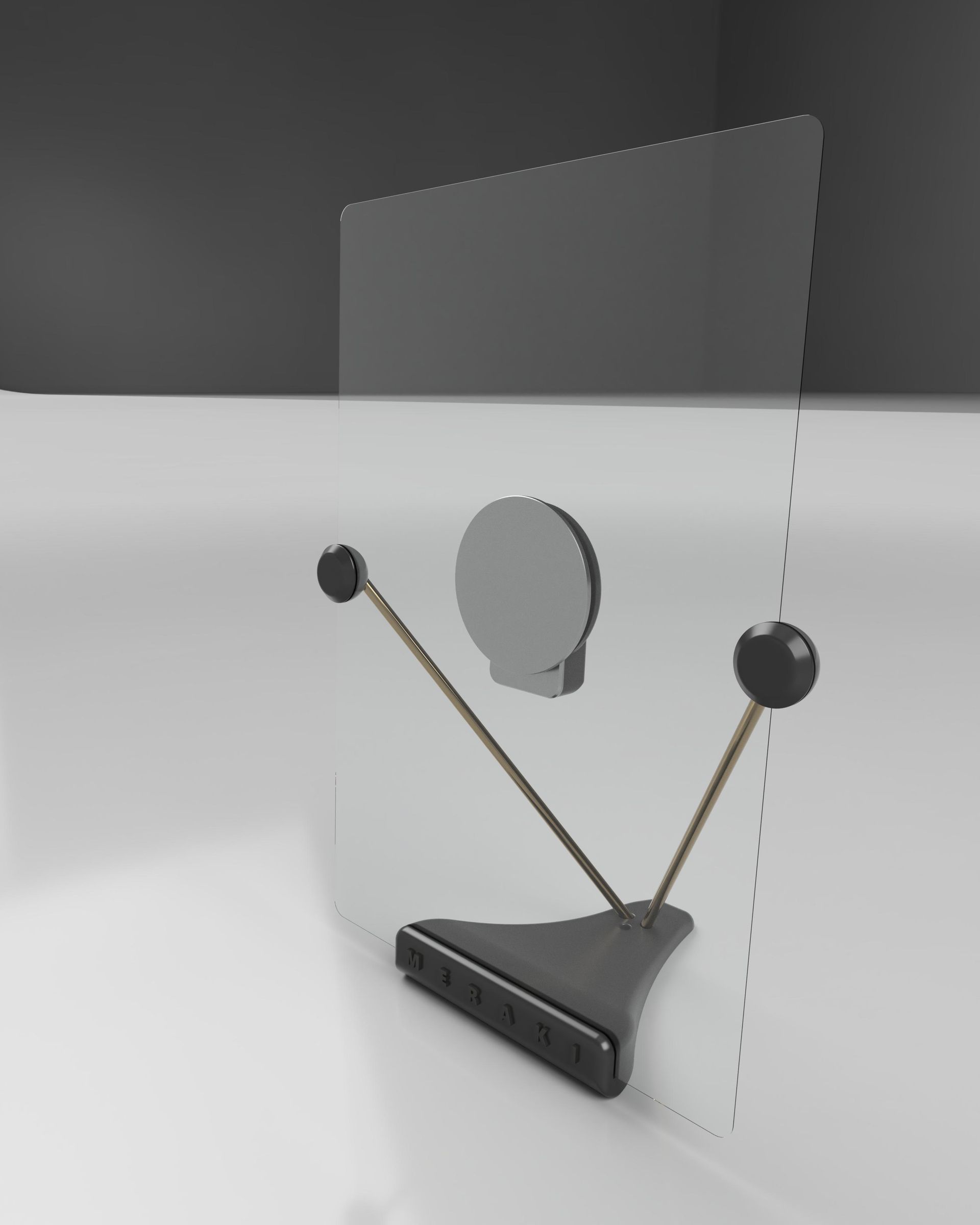

Step 4: Design and Printing the Speaker Components:

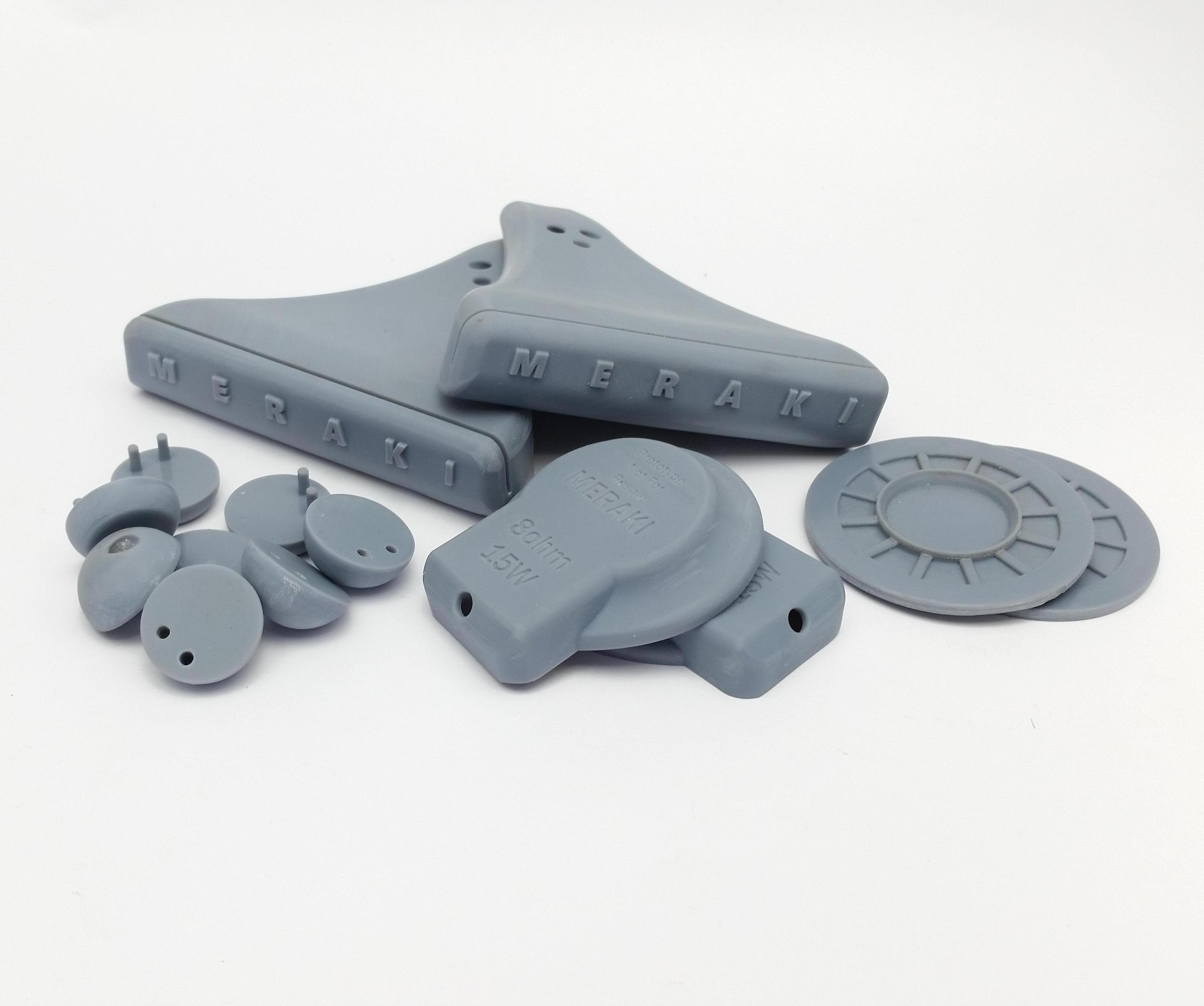

Using my go to design software Fusion 360 I designed a minimalist stand for the glass panel that will compliment the glass.
The design was lead by the need to cover up any notches that was in the screen protector originally intended for the cameras and earpieces of the device.
The final design should work for most designs of screen protectors.
I will include all original design files if you want to make any changes.

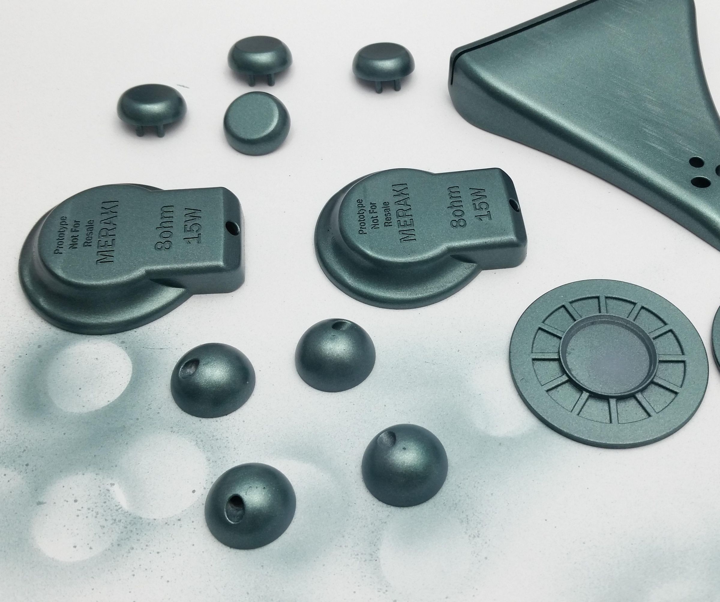

The exciter enclosure is designed around a 44mm 15W Chinese sourced driver but has no direct effect of the DML panels and can be made according to your exciter.
All parts in my build was printed in regular Creality rigid resin.
After printing I sprayed all of the parts in a vintage looking metallic forest green to compliment the brass rods I will use as supports for the glass panel.

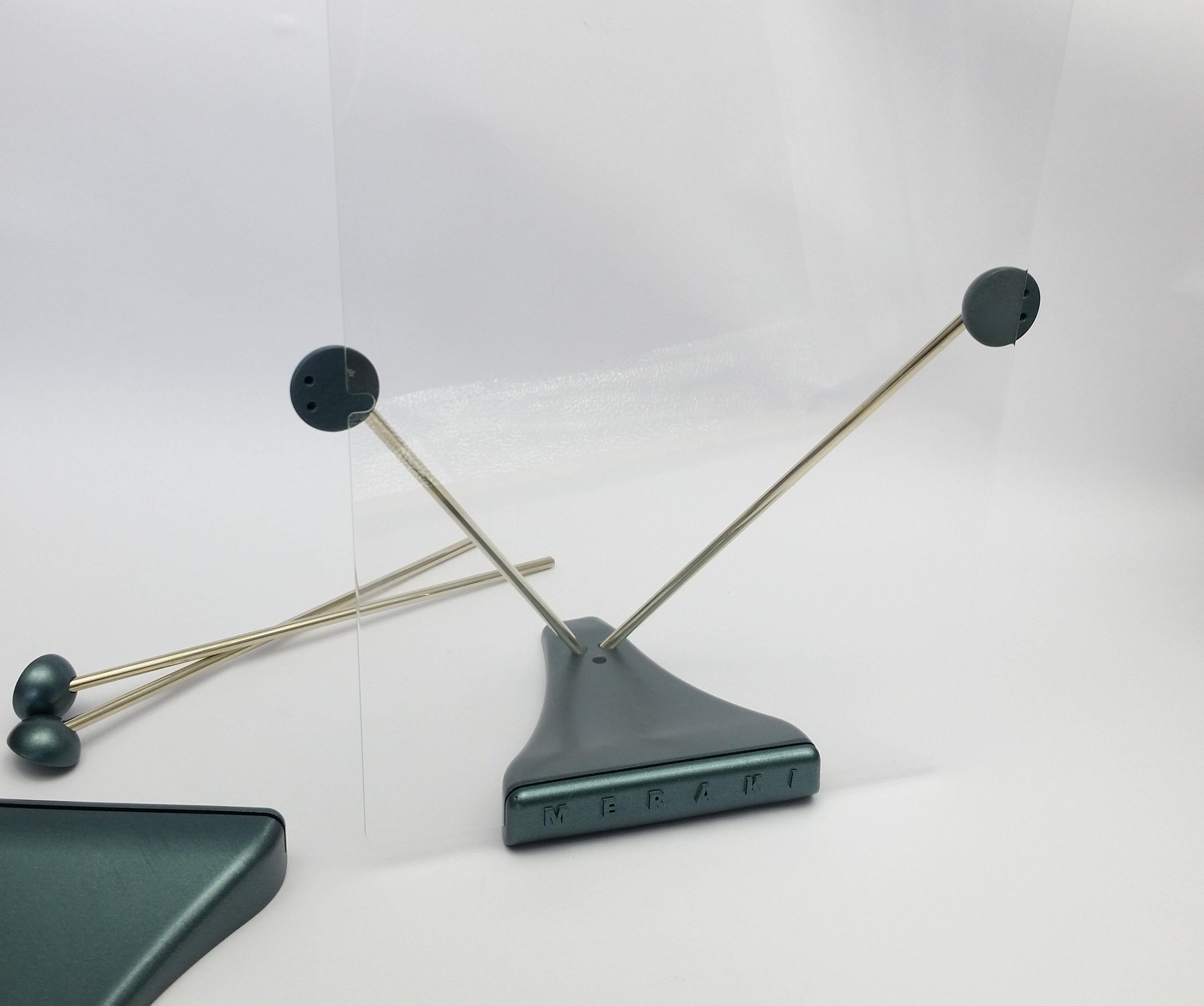

Glass DML
Step 5: Assembling the Printed Components:
With the needed parts printed and painted we can start assembling the parts.

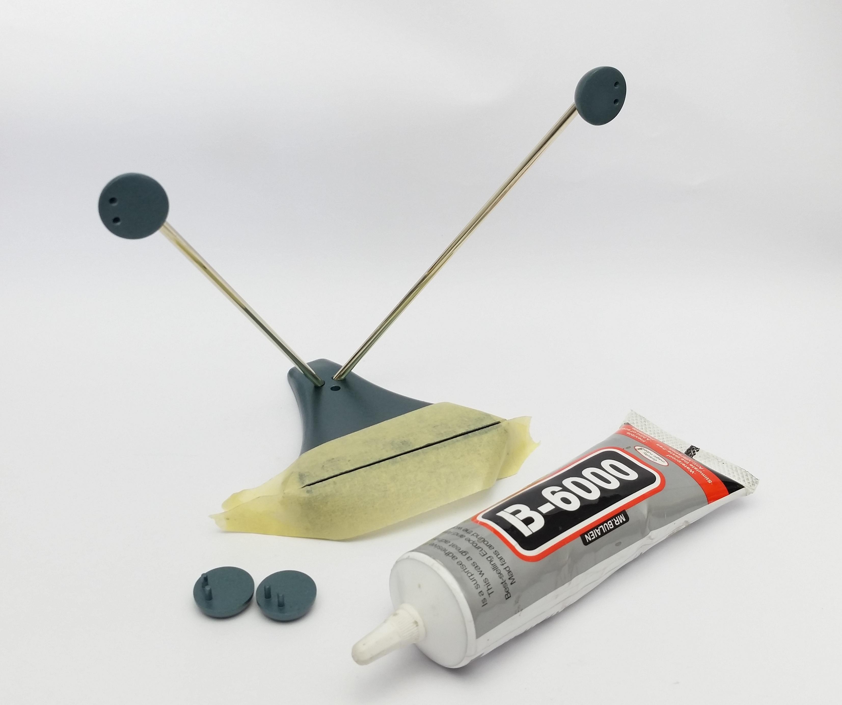

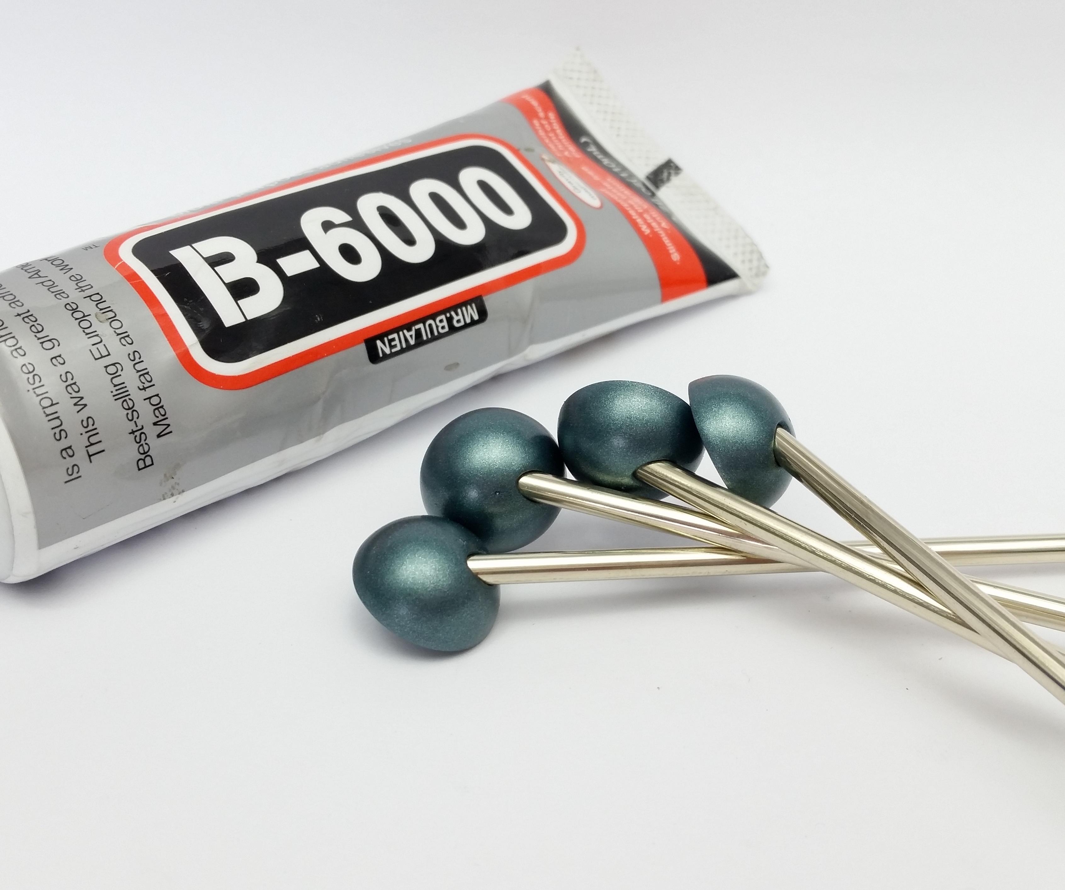

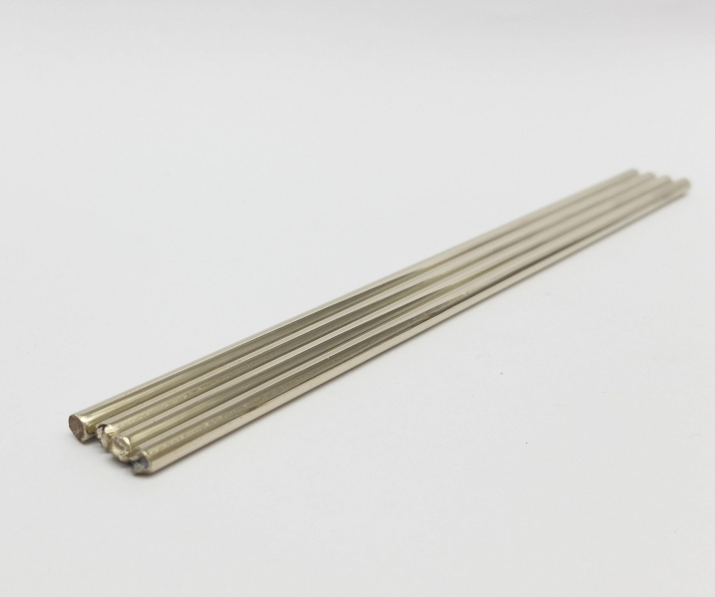

Starting with the stand I cut four 4mm brass rods to 163mm length filed away any burrs and polished them to a shine with some metal polish.
Next using B-6000 glue for its vibration dampening quality and strong hold I added a drop into each of the 4mm holes in the "Glass Back Support" spheres, next I pushed in a brass rod into each sphere.
Now we will press two of the assembled brass rods into each of the bases making sure the two small dots on the back support spheres point outwards.
You can slot in one of the glass screen protectors just to align the rods and make sure the glass lays flat against the supports.

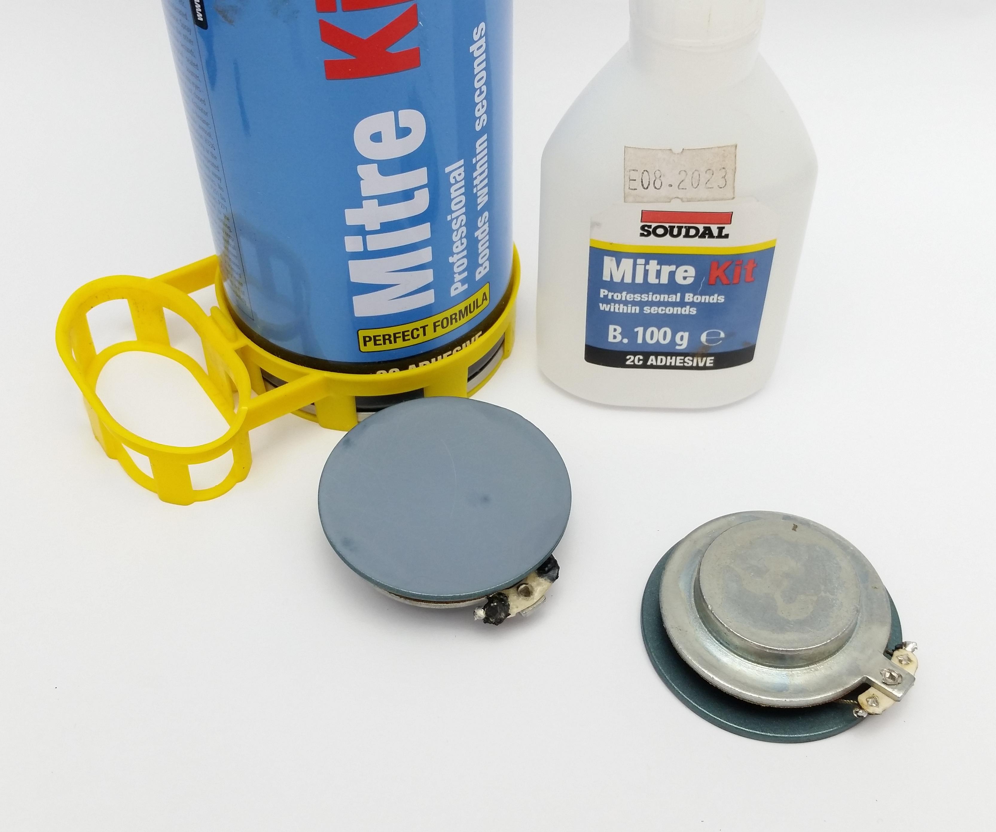

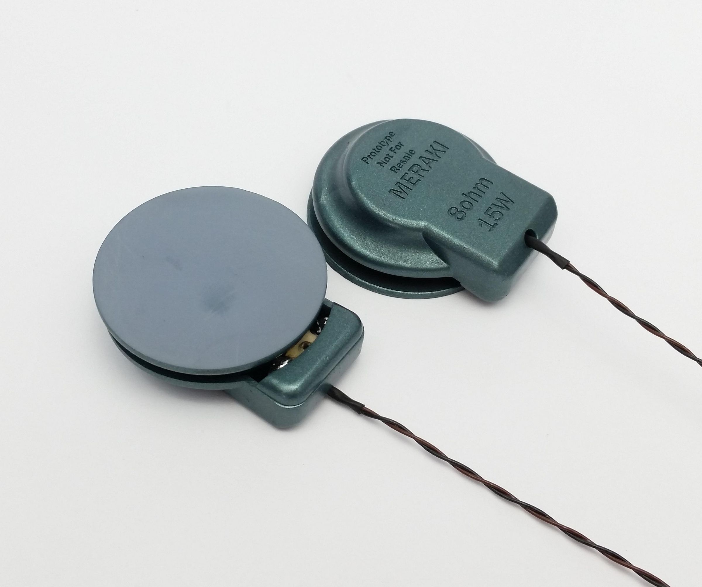

When I originally received the exciters they had a metal plate over the voice coil that you can attach them by, but as I discovered in my previous DML Instructable this metal plate greatly degraded the sound and I stripped them from the voice coil.
To replace these metal plates I printed some new plates that fit inside the voice coils using a small bead of 2 part CA glue around the edge of the voice coil.
From my original Instructable - Plywood DML Speakers

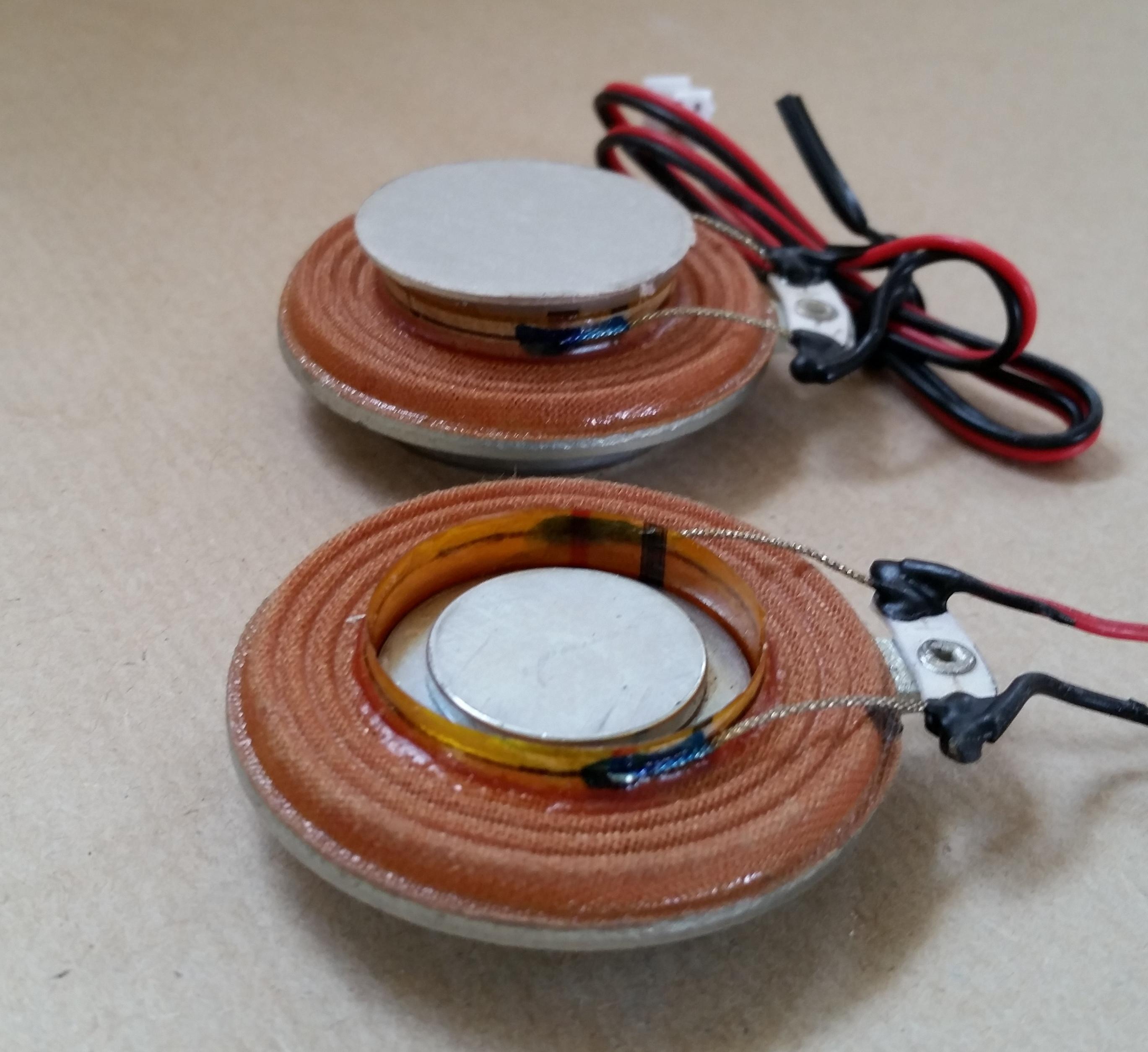

When I received my newest batch of exciters they had a round steel plate on the front of the voice coil for mounting. I thought this was quite neat as it made mounting a lot easier but after mounting them to a test panel I was very disappointed, the sound was muddy and had no output above 500Hz.
At first I thought it might be the panel material so I tried a few different panels, same result every time.
So it was time for a lil dissection...
Removing the plates turned out to be a lot more difficult than I anticipated, I started with a very thin blade and pried between the plate and the voice coil... be very careful!
When I had a small gap I dripped some isp alcohol on the joint to loosen the glue a bit, I was careful not to get alcohol on the rest of the exciter as I didn't want to risk dissolving any other glues.
Unfortunately on both of my exciters the plastic supporting ring below the plate also broke when I removed it so I decided to print a new ring that would then also be used to mount the exciter.
I used the same 2 part CA glue to stick the new ring onto the voice coil.
Placing the exciter with the new mounting ring onto the panel I was relieved that the sound I knew and loved was back.
Lesson learned metal mounting plates degrade the sound horribly.
Solder on two wires onto the terminals of the exciter before glueing them into their enclosure by using the same 2 part CA glue. The final part is the small terminal cover that just hides the unsightly terminal connection we can see from the front due to the transparent panel.

Usually when it comes to DML panels we mount the exciter in a 2/5 3/5 position but in my experience with tiny panels like these I like the reproduction better when the exciter in a central position.
To prevent any damage to the glass screen protector I place it onto the soft foam cover it originally shipped it as it might crack if there is dirt under it when applying pressure in the next step.
To adhere the exciter to the glass panel I started marking out the centre of the glass with a white board, I then marked out a circle slightly bigger than exciter that way we can easily position the exciter inside the circle as you only have about 3 seconds to position it before the glue hardens.
I spray a light most of the 2 part CA glue activator onto the glass then put a pea sized drop of CA glue onto the centre of the exciter mounting plate, position over the circle and stick it down lightly hold it down in place for about 5 seconds.
Next we need to attach the assembled glass panels to the bases.
We will be using B-6000 glue to aid in vibration dampening, I started by masking off the base on opposite sides of the glass panels slot to prevent excess glue from damaging the paint.
Add a bead of B-6000 inside of the slit and on the face of the support spheres then slide the glass panel into the slit and press onto the glue on the supports making sure your panels are centered.
You can then place some glue on the front glass support covers and press them into place.

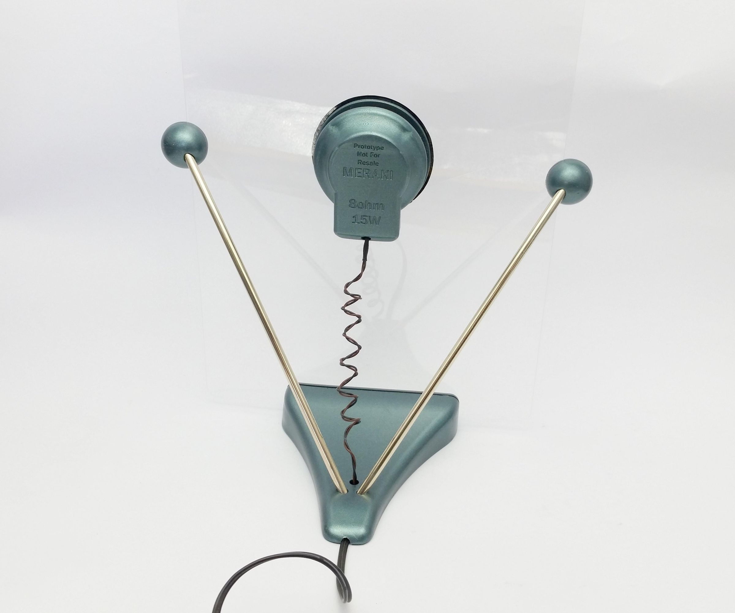

As this pair is simply a prototype to test out the viability of the glass panels I will for now only cover the front where we stuck the exciter assembly to the glass with a matt black sticker to hide the glue, I want this to be removable as I want to test out some whizzer cones in the future to see if it makes any difference.
Otherwise I will just design an emblem that will go on instead of the sticker to make it neater.

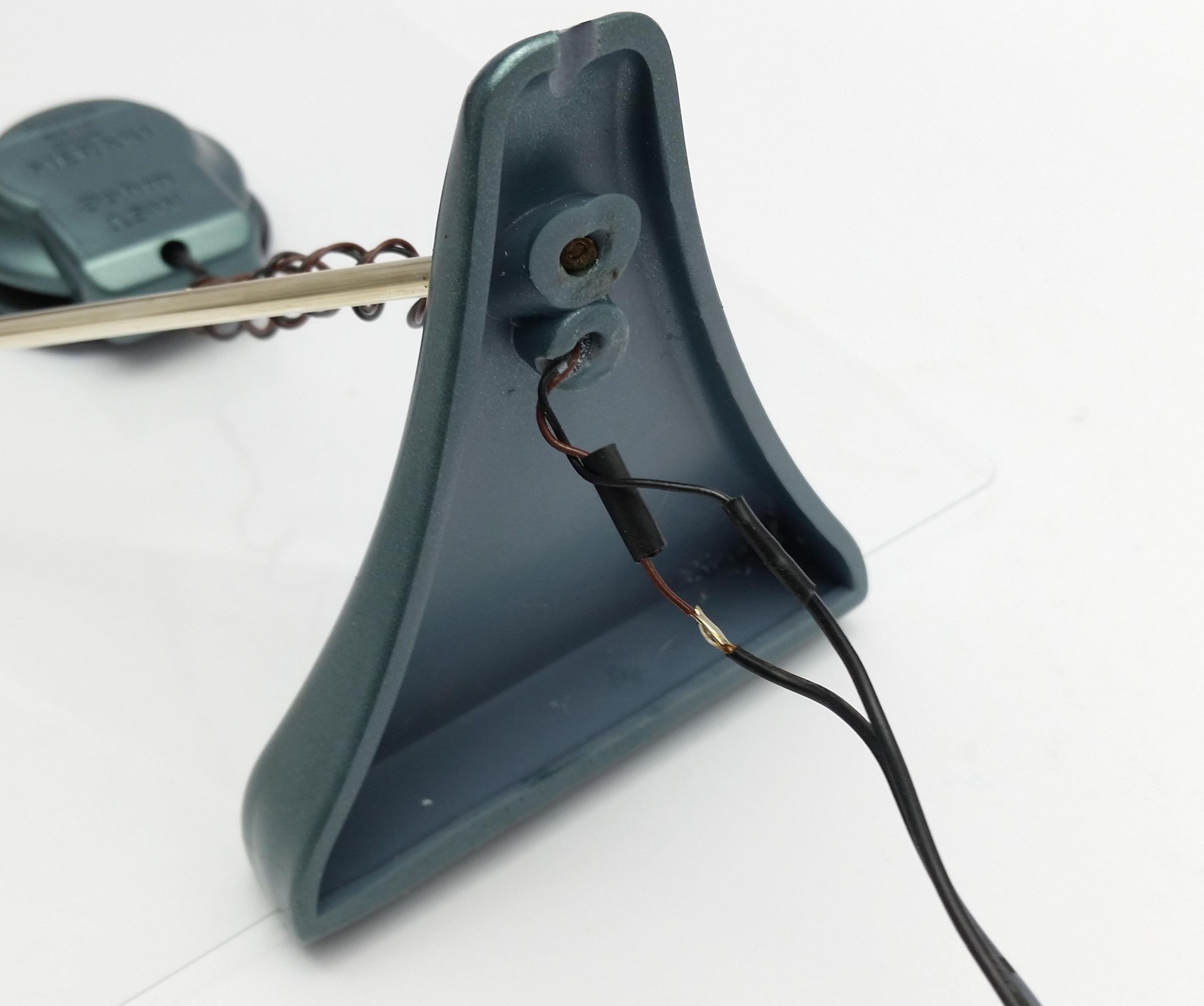

The last step before we get to test out our speakers is to solder on some wires.
Whilst designing the base I completely forgot to add some passages for the wires to run through out the back so I had to use a carving bit in my Dremel to make some slots for the wires but I have fixed the design so you should be ok! 😂
I simply soldered the coiled decorative wire from the exciter assembly onto some regular speaker wire and covered the connections with heat shrink tubing.
I know a lot of people would prefer a connector instead of the wires but it was difficult to find a commonly available connector that will fit the low profile at the back.
