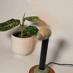

Ever since I saw one of these ceiling fans on Pinterest that are made from salvaged airplane propellers I was in love, unfortunately finding one of these old propellers can be a challenge and if they do pop up for sale they are ridiculously expensive.
This Instructable is my attempt at creating a USB powered desk fan that the look of these ceiling fans by using a wooden propeller from a model radio control airplane.
As you can get these model airplane propellers in a huge variety of lengths and pitches you can customise the fan to suit your needs and with radio control airplane propellers over 30in available you could even make a ceiling fan out of these......future Instructable maybe? 🤣

With the needed measurements made I hopped onto Fusion 360 to design fan.
I knew from the start I wanted the fan to have a vintage fighter plane feel to it, as my fan will be on a shelf far away from any curious fingers I made one without a blade guard but knowing a lot of people would rather not risk it I also made a model with mounting points for a 4mm blade guard.
I printed the parts using a resin printer with ABS-like resin for increased accuracy but they should print perfectly with a 0.4mm nozzle FDM printer set up for high detail and at 100% infill to keep it as balanced as possible.

Continuing with the theme I have in mind for the fan I used my airbrush to spray the printed parts in a vintage looking semi-gloss military green and then also taped off the tips of the propeller and sprayed them with a mustard yellow.

Step 9: Test It Out!
The time has come to plug in your new creation and enjoy the cool breeze!
Because the propellers are so well balanced there is absolutely no vibration from the fan even when going full speed coupled with the very quiet brushless motor makes this fan a real treat to use and I will definitely be making more!
