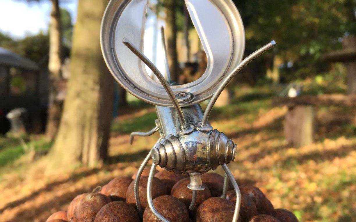

Step 1: What’s Included in Your Kit
1- A recycled empty gas canister - pre-drilled ready for you to rivet into.
There are 6 holes on the bottom for the legs, 2 holes for the eyes, 2 for the antennae on the top, and 2 for the wings at the sides, plus one at the back for the tail.
2- The bottom of an aluminium drinks can - to be formed into the wings.
3- 6 stainless steel washers that have been pre-hammered into a domed shape, (3 different sizes) - which will form the eyes.
4- 10 long rivets - to form the legs, antennae, mouth and tail.
5- 2 medium rivets - for attaching the eyes.
6- 2 short rivets for attaching the wings.
7- (Optional) A short piece of plastic tubing - to cover the ends of the feet etc.

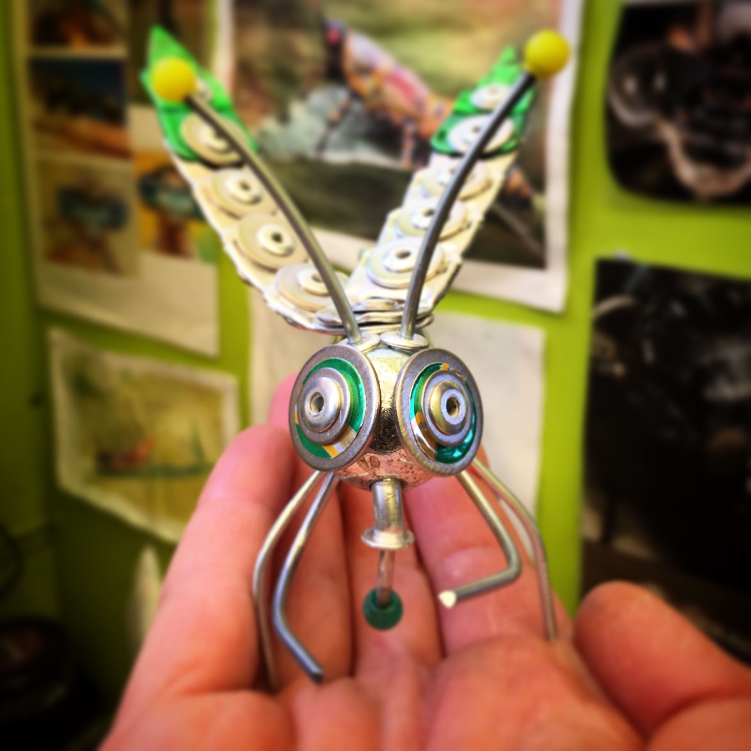

Step 5: Riveting on the Eyes
What you will need:
2 x medium rivets
6 x domed washers
Rivet-gun
-Hold the rivet by the shaft end (stick end) and place one of the smallest washers upside down onto the thicker end.
-Layer it up with the medium, then large washer.
-Put the same end of the rivet into one of the eye socket holes (taking care to ensure it’s the right hole!)
-Holding the washers in place with one hand, place the rivet-gun nozzle onto the shaft of the rivet, ensuring the handles are fully open, and the nozzle slides right down to the bottom of the shaft.
-Start squeezing the handles together.
-You should feel some pressure, and once you’ve started to squeeze the handles together, the washers will start to feel secure.
-Once this happens you can let go of them, and use both hands if you need to, to ‘snap’ the rivet.
-Please note: It can be hard to snap the rivet, especially if you have small hands!
**IMPORTANT:
Keep your fingers out from in between the handles!**
-Just before the rivet snaps the pressure will increase. Be prepared for a loud ‘snap’ as the riveter does its job of removing the shaft, and securing the rivet in the hole.
-If you have squeezed the handles all the way and it still hasn’t snapped, open up the handles all the way until they click, and squeeze again.
-Once snapped, open up the handles, and the stick should drop out.
-Repeat with the other eye.
Step 6: Riveting on the Antennae and Legs
What you will need:
8 x long rivets
Rivet gun
Long nose pliers
-The longer rivets are used for the antennae and legs, as you are not snapping them off - the longer they are the more you have to play with, before they snap.
-Fit 2 rivets loosely into the antennae holes.
-It’s very important you put them both in loose at the same time, so that they both fit.
-Don’t worry at this stage, if they stick out a bit, or are at odd angles, as they will push down as you rivet them in, and you can bend them into place with the pliers after.
-Work the rivet gun as before, but this time you are just looking at getting them securely fixed, NOT going as far as snapping them.
-Be careful as there is a fine line between securing and snapping, but you will be squeezing and opening more than you did with the eyes, as the rivets are longer, so don’t be too cautious at first.
-With practice you’ll be able to tell when to stop, as the pressure increases just before they snap, but for now just take it slowly, checking as you go, and when it feels secure, stop.
-TIP: To check how secure the rivet is, and to take the rivet gun off the rivet shaft, make sure you open the handles fully, and when returning it on, keep the handles open, until the nozzle is at the bottom of the shaft.
-Repeat this with the legs - putting them in loosely in pairs - otherwise you’ll end up not being able to fit the last one in!
-When they are all in securely, use the pliers to bend them into shape.

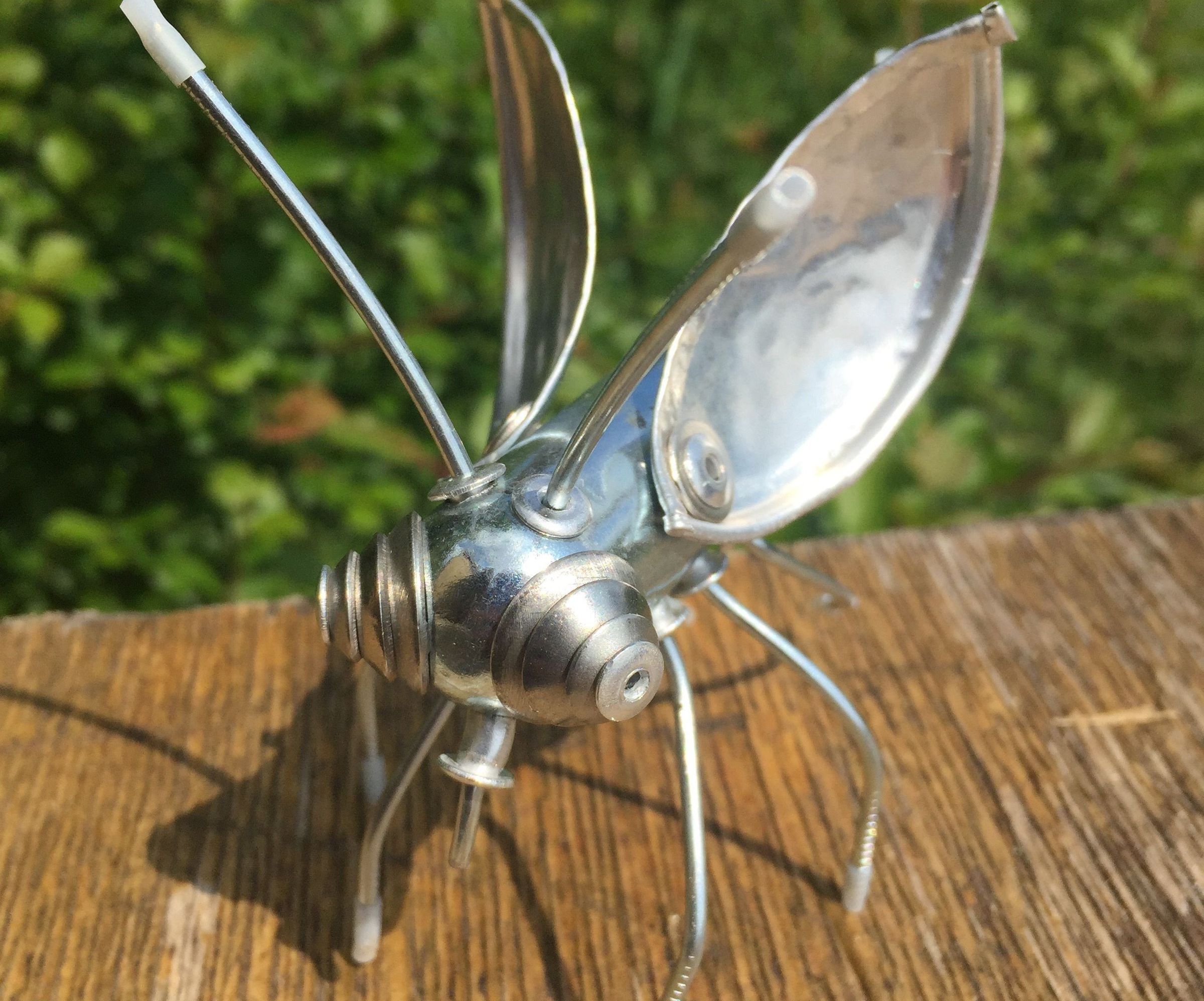

Step 8: Riveting on the Wings
What you will need:
2 x short rivets
2 x wings
Rivet gun
-Rivet the wings in place, snapping them the same as you did with the eyes.
-They’ll snap quicker as they are shorter.
Step 9: Adding the Rubber Feet (optional)
What you will need:
Plastic tubing
Scissors
(If you chose the ‘plastic free’ option ignore this step)
-Push one end of the tubing onto the bottom of a foot, and trim off with scissors.
-Repeat this on all 6 feet, plus the antennae and tail if you like.
*No glue needed!*
And that’s it - your mini bug is complete!
