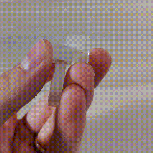

While making many of my projects I find myself in the need for an extra hand. To solve the problem, people have invented 'helping hands', which are mini clamps connected to an adjustable wire. However, these are not really 'helping hands' because they're static - you position them once and they stay that way. It's more for holding than a third hand. But what if you want to be able to move 3 objects at once? Two hands won't be enough. That's why I made the Maker's Ring :)
The Maker's Ring is a 3D printed ring that's designed to be modular - sometimes you'll want to attach tweezers to it, and other times a mini flashlight (why wouldn't you?) or anything other mini tool that comes to mind. It's 100% customizable, and so it'll fit anyone's fingers easily.

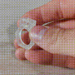

First things first - you'll need a ring. I designed the ring to fit my ring finger. I have a ring whose diameter is 17mm (convert to inches here), so I set it to 17mm. You'll probably want a different sized ring. To rescale the ring to fit the diameter of your finger in TINKERCAD, press the 'Import' button at the top-right part of the screen. Then, set the 'Scale' accordingly:
100 x (desired diameter)/17
For example, if you want a ring with a diameter of 10mm, you need to set the scale to:
100 x 10/17 = 58.8%
Once you have the settings right, print out the ring. If you're using a resin printer like I did, you can see the orientation I chose to print at in the 3rd image. I didn't use any supports or anything and it came out great.

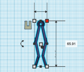

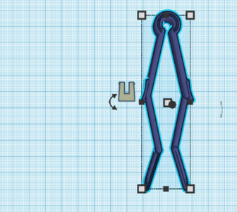

  • Import one of the adapters provided here into TINKERCAD. Make sure to use the same 'scale' you calculated in the previous step, so that the adapters fit your ring.
  • Create or import into TINKERCARD the accessory you want to mount. For this demo I'll be mounting cross-tweezers (designed by pzonyga) to the ring.
  • Rescale the accessory to fit the size of the adapter.
  • Align both parts on top of each other.
  • Select the adapter & the accessory, and group them (Ctrl+G).
  • Export as STL. The exported file will be a merger of both shapes (the accessory & the adapter).

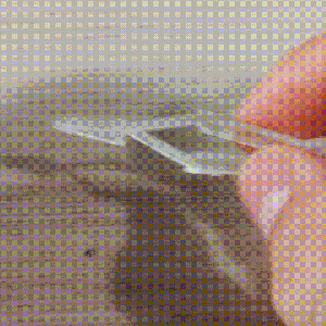

So far I've made 3 accessories for the ring - the cross tweezers from the previous step, a mini flashlight, and a scoring tool. Even though these are mainly just examples, the files are attached here for you to print (remember to rescale as in step 1!).
Once the parts are printed, just push them in place (see GIF). They should snap in place, and you'll have to squeeze the flexible arms of the adapter to change accessories.
** Tip - you may need to adjust the size of the adapter. Different printers / materials have a different tolerance - they shrink differently and have different levels of accuracy. You may need to shrink or enlarge the adapters to fit well. You can do this in TINKERCAD or in any slicer. Feel free to leave a comment if you need help.
