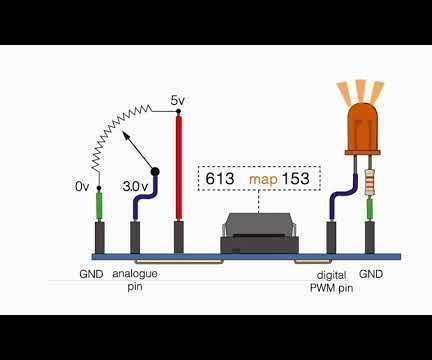

Update May 2020: I've recently published a new ebook called Animated Arduino, an interactive ebook which aims to provide a better understanding of some of the concepts that you will encounter whilst you learn to program the Arduino, giving you the confidence to progress in writing more ambitious code for your projects. It's available to download now from www.animatedarduino.com
