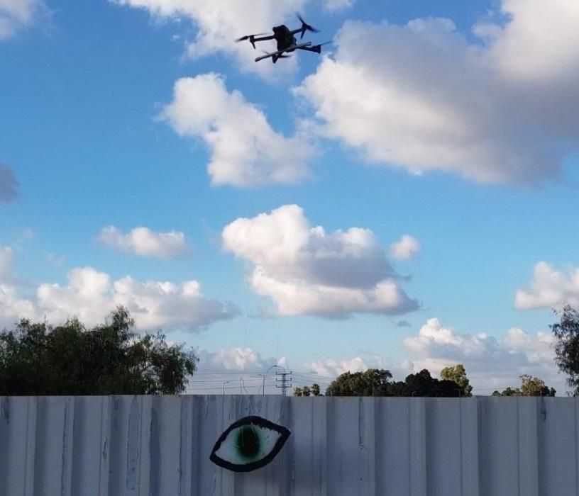

Step 11: Going Higher Using Drones
Using stick will only take you 5-6 meters high. If you want to get higher you need to use drones but that for another time.
