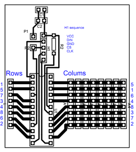

Heres the final schematic of my V4 of the PCB
This is pure n simple keeping in mind my soldering skills and limitation to a single sided PCB
P1 and P2 needed to be short i didnt find a way around to skip this one jumper apart from that m very happy theres no jumper or overlapping on my PCB having a 24 PIN IC with sequence all over the palce

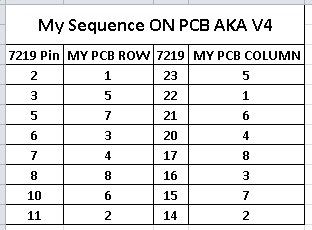

I would have shared an excel if instructables allowed no issue though
this PCB or sequence is good with arduino library "LedControl.h"
let me give small example here just so that theres no confusion left.
The following piece of code from my truck will light up Row 1, 4 LEDs placed in column 3456
if (RemoteXY.HL!=0){lc.setRow(0,0,B00111100);}else{lc.setRow(0,0,B00000000); }//headlight
How can i wire em up ??
Please note the numbers mentioned on the PCB snap above
Merge the cathode of all 4 LEDs on Rows pin numbered as 1 and anodes on column mentioned as 3 4 5 and 6.
