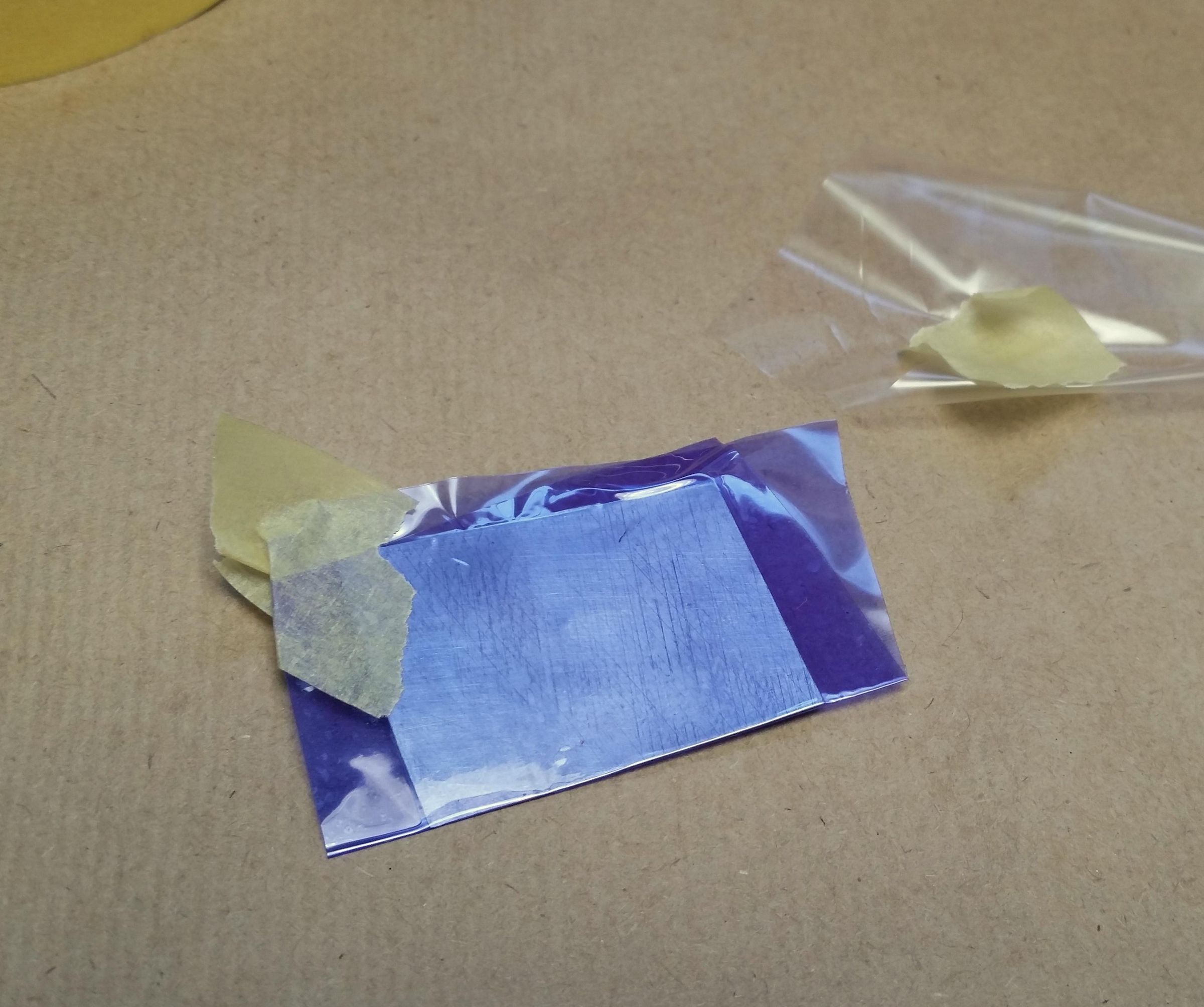

Next in a dimly lit area away from natural light you can cut off a piece of the photosensitive film that is large enough to cover the front as well as the back of the aluminium sheet.

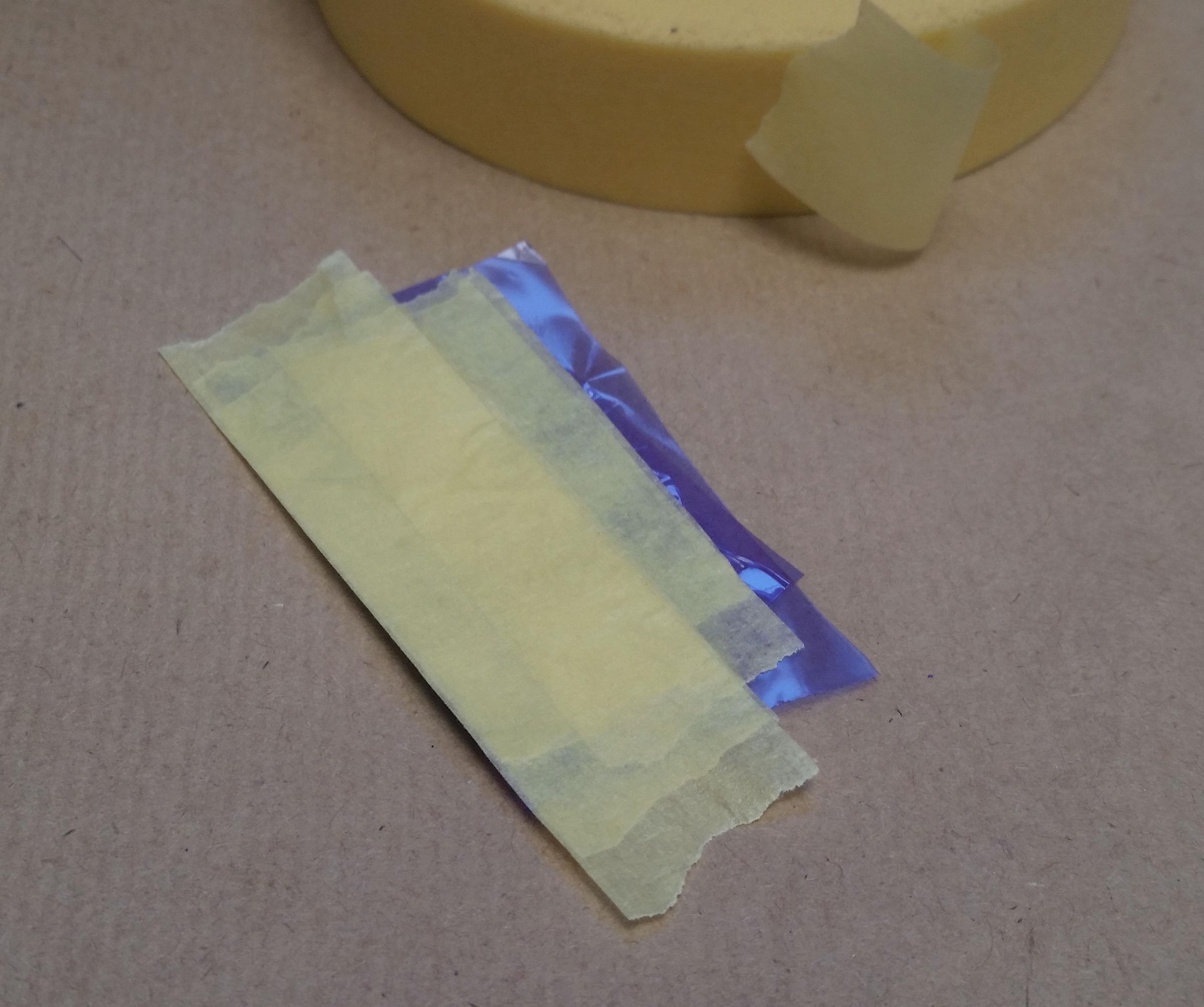

The photosensitive film has a protective film on the front and back of it, to remove simply take two pieces of painters tape and stick them on the corner of the film both sides. Then peel the tape off and the back protective film should come off with it.
Keep the front protective film on.
Now apply the film onto the front of the sheet first making sure to push out any air bubbles then wrap it around and do the back as well. I always do the front face first as the back does not need to be as perfect.
You will notice that the film doesn't really stick that well to the surface, for it to adhere we will need some heat. Simply heat it with a hairdryer or a heat gun and rub down the film well once hot.

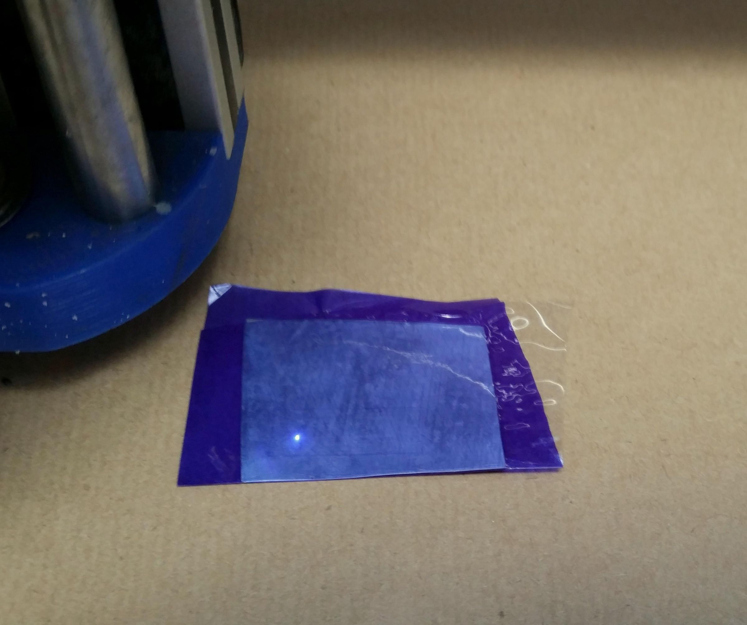

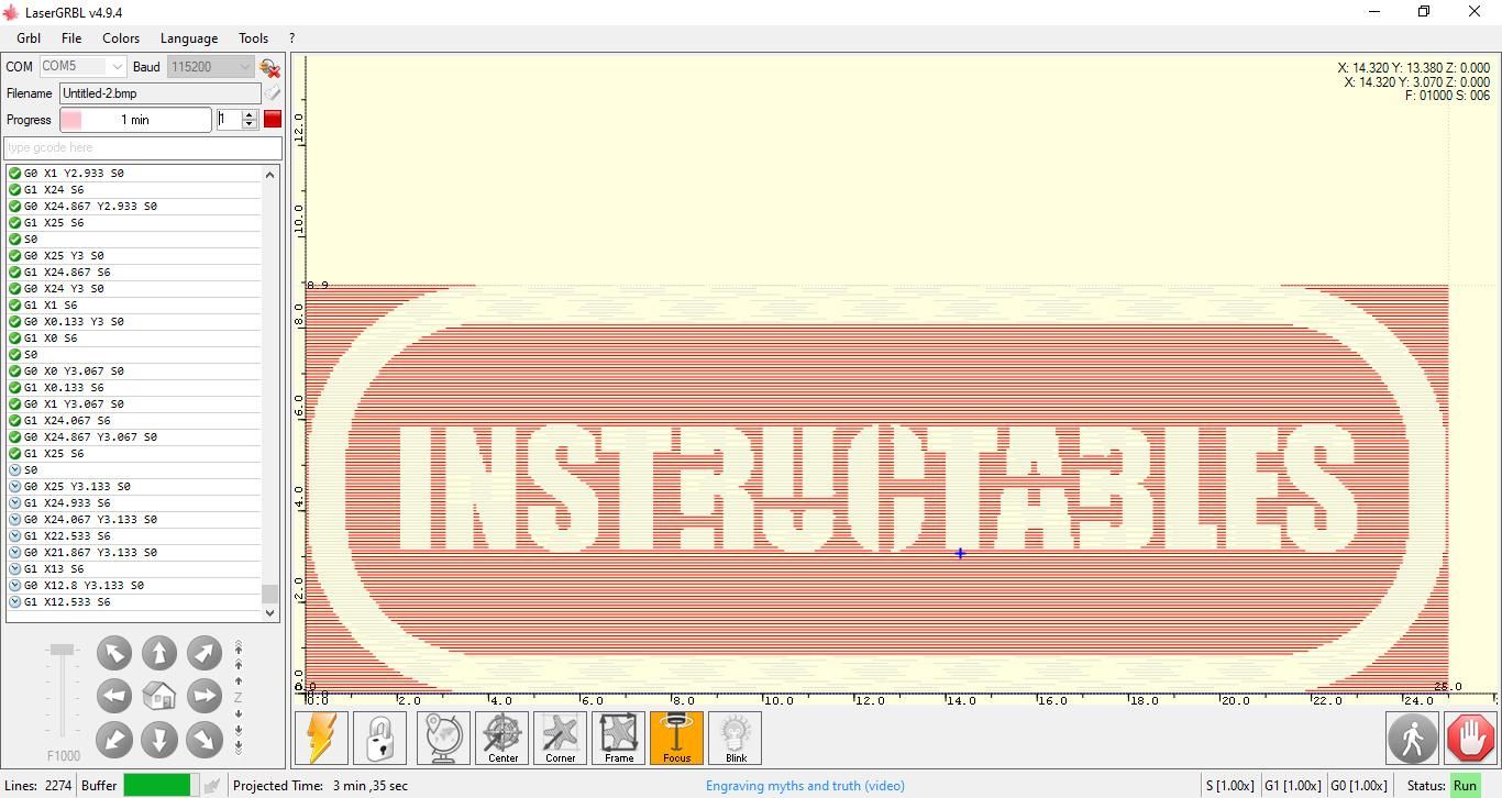

Using a very inexpensive 405nm diode laser engraver module from Amazon usually used for engraving on wood we will "engraving" with it at about 1% of it's power onto the sensitised aluminium sheet.
The 405nm UV light emitted by the cheap laser modules are exactly what is needed to expose our film.
Using LaserGRBL as my preferred laser engraving software I set the output power at 8 (it goes from 0-1000) and my engraving speed is set to 1000mm/m using line to line tracing and 15 lines per mm resolution.
These settings give me a light exposure with no bleeding of the light onto areas that shouldn't be exposed and it also develops quick and crisp.

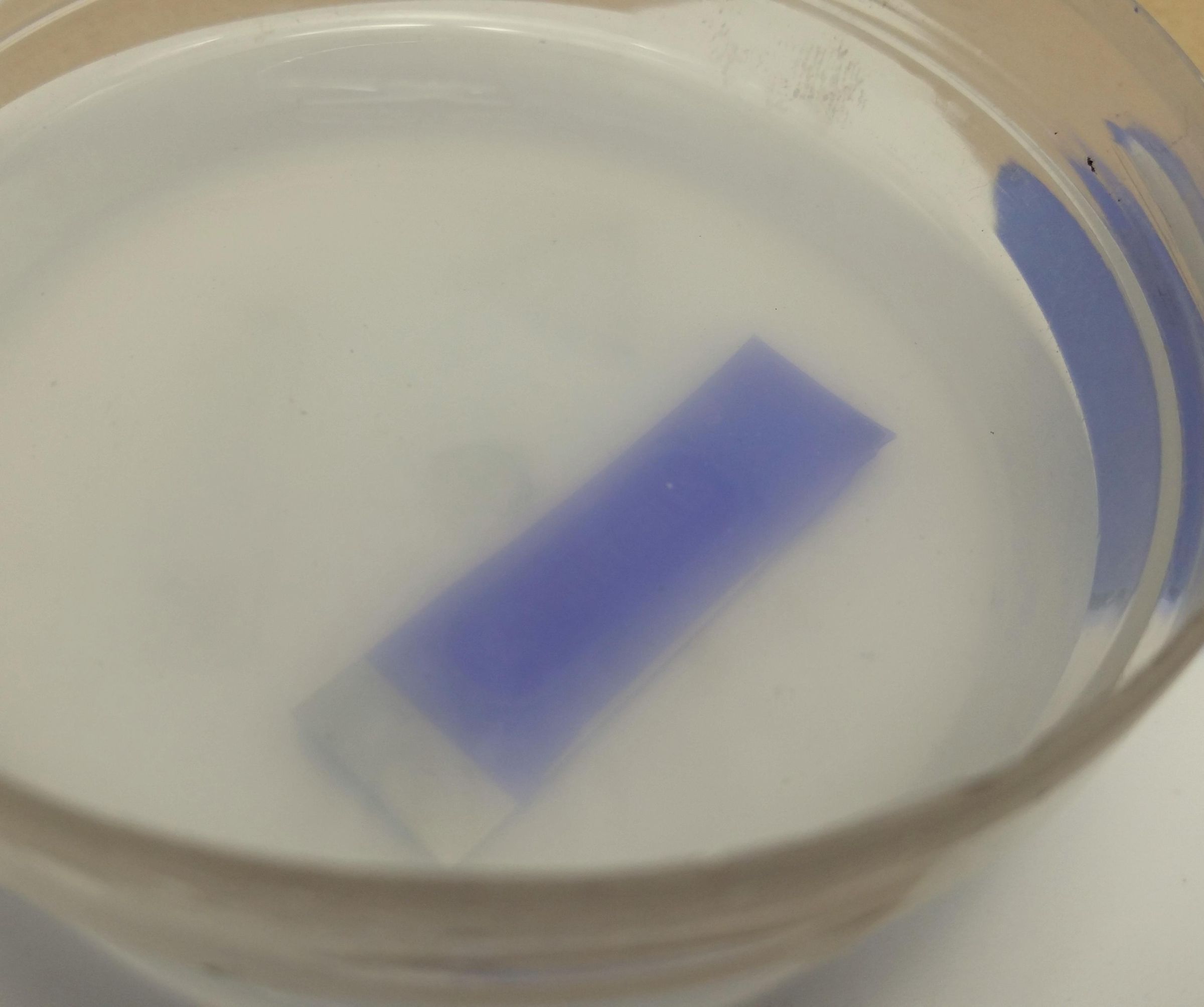

Step 6: Develop the Negative:
To remove the unexposed film we need to submerge the piece in a development solution:
Add 1 teaspoon of washing soda to about 200ml of water, you want about a 3% solution. Adjust this according to your specific brand of photoresist film. It's best to first try with a spare piece of film, you want it to take about 3 minutes to dissolve. If your mixture is too strong you'll also dissolve the developed film.
Now remove the top protective film and submerge your aluminium sheet with the film into the solution.
You will see the undeveloped film starts to get opaque and dissolve into the water. Using a soft bristle brush you can gentle brush away the dissolving film until you are just left with the dark blue developed resist.
If there are small areas that did not develop correctly or wiped away you can use a PCB touch up marker to correct it. If large areas lifted while developing I will recommend repeating the steps above as your film might have not adhered correctly.
Rinse well with clean water.

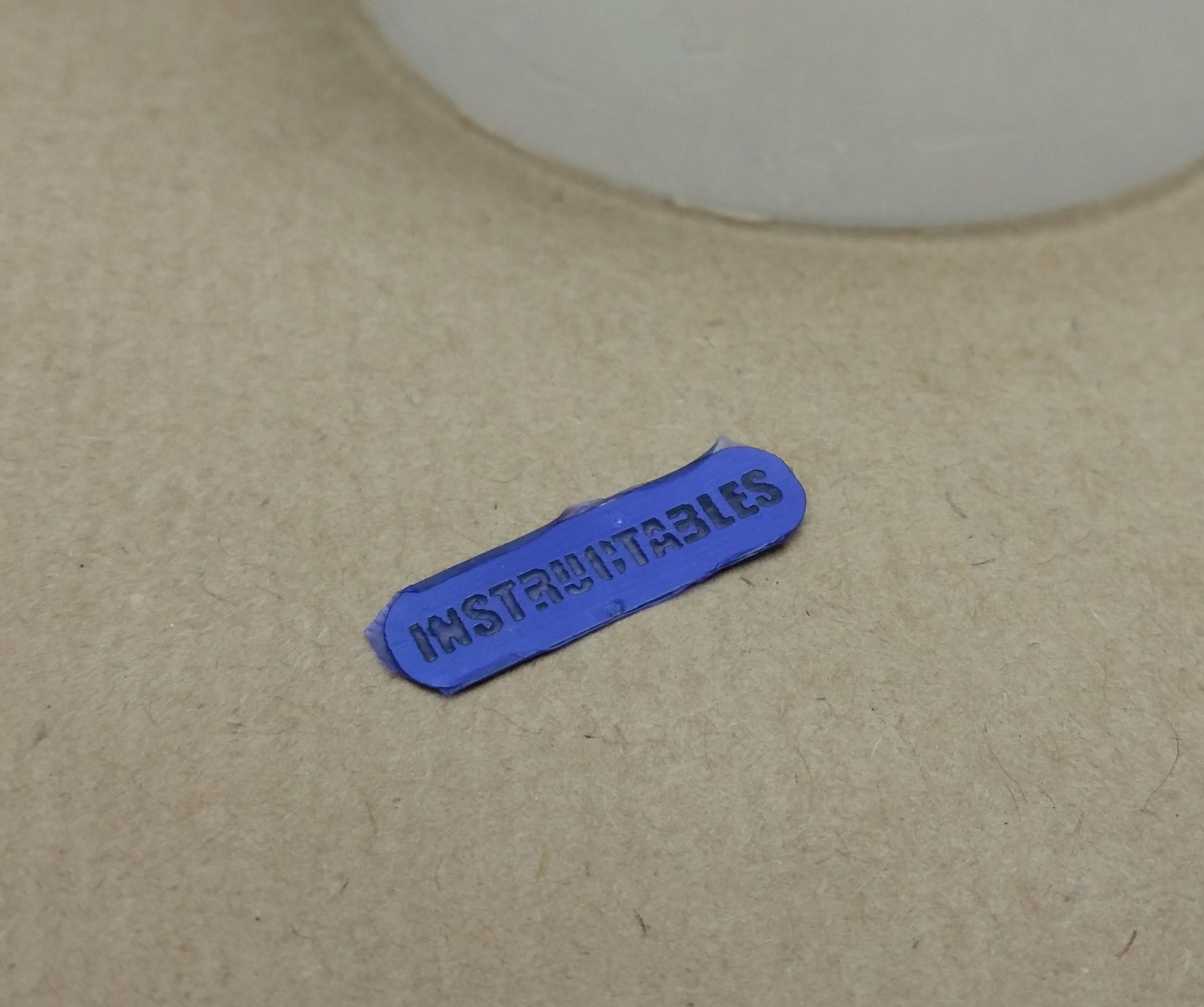

Step 8: The Results:

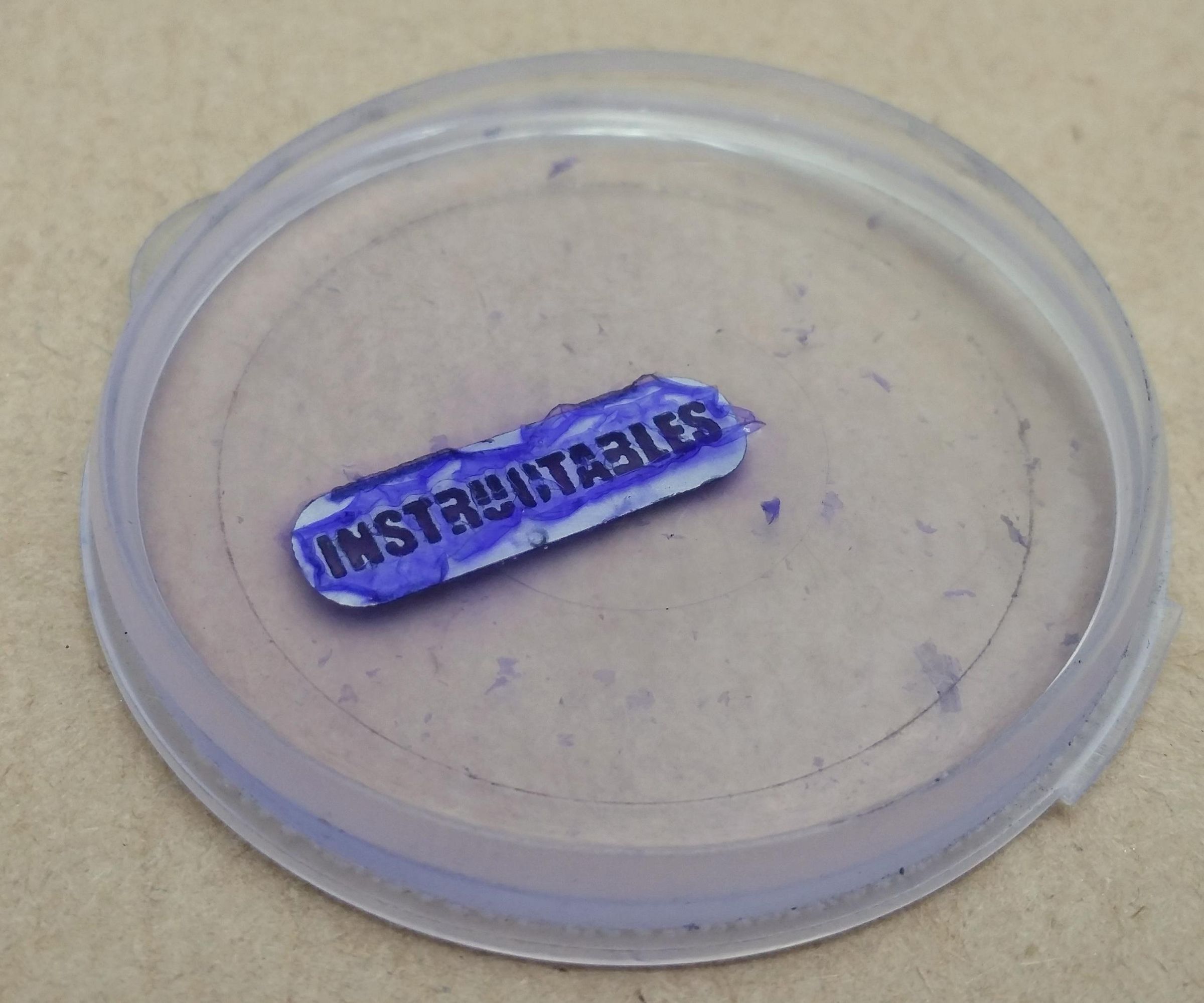

Here are the results I got from this process.
The photochemical machining was done on 0.13mm thick aluminium which my CNC would have destroy at first touch with regular machining
Under a microscope you can see that the 0.3mm holes in the sieve are pretty well defined and accurate throughout and much smaller holes are also possible with a printed transparency negative as there is less light bleeding.
Overall I'm super happy with the results I get from this process and it opens up loads of new possibilities being able to manufacture parts on this scale.

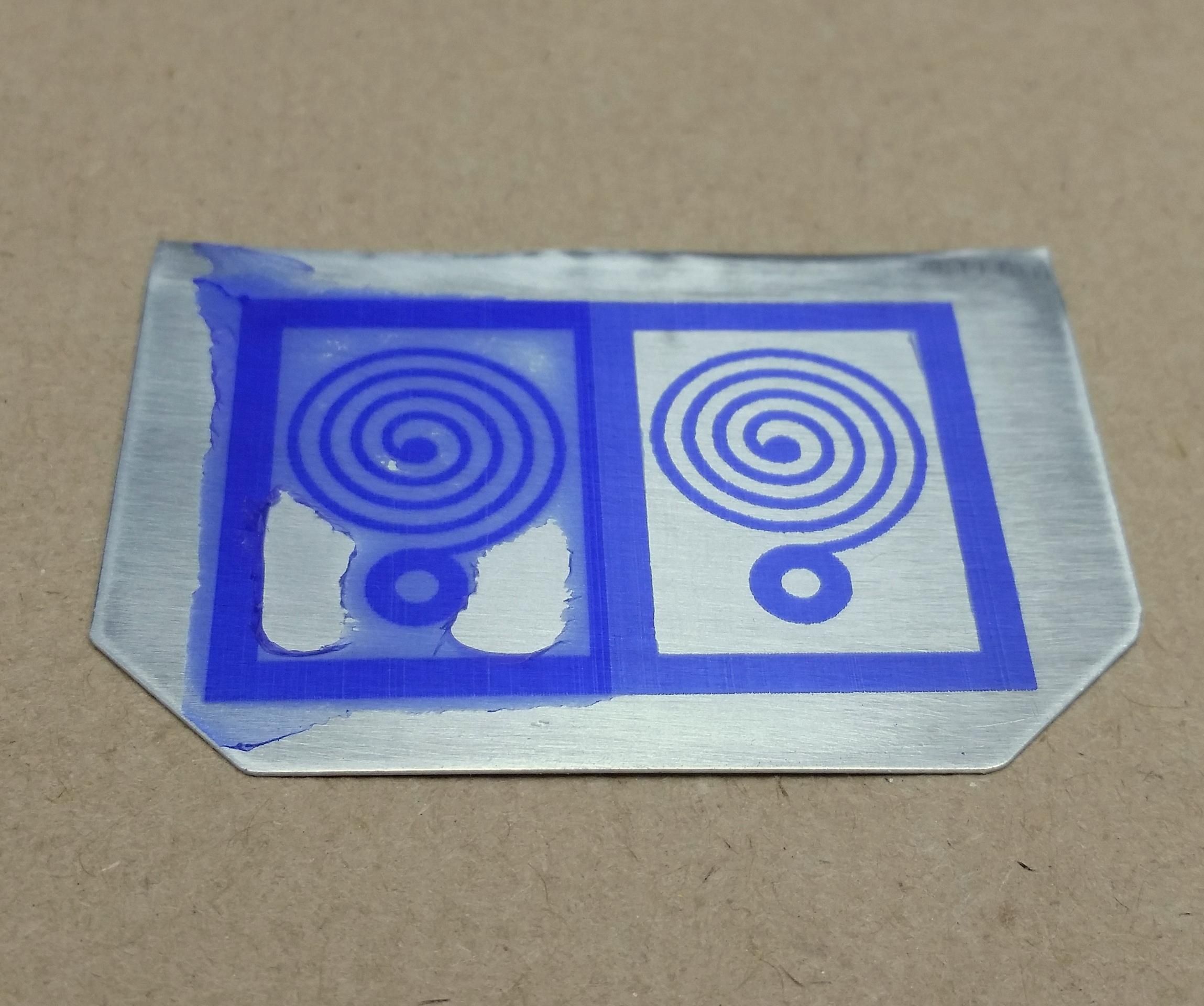

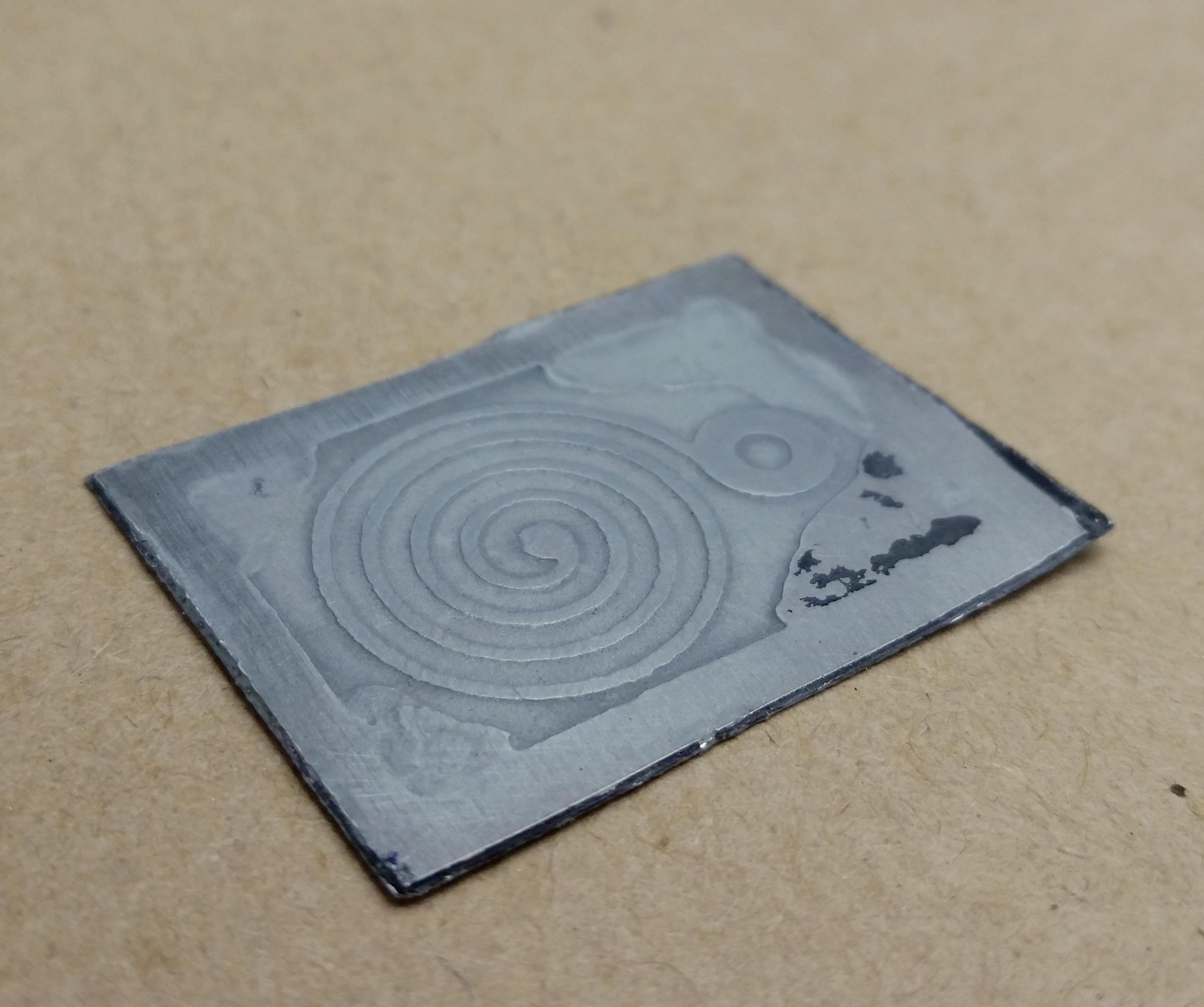

Metal not prepped properly:
Halfway through etching this piece the resist started coming loose and eventually completely separated, this was due to not sanding the surface with 400 grit sandpaper first and also I simply washed it and did not wipe it down with acetone before applying the photosensitive film.

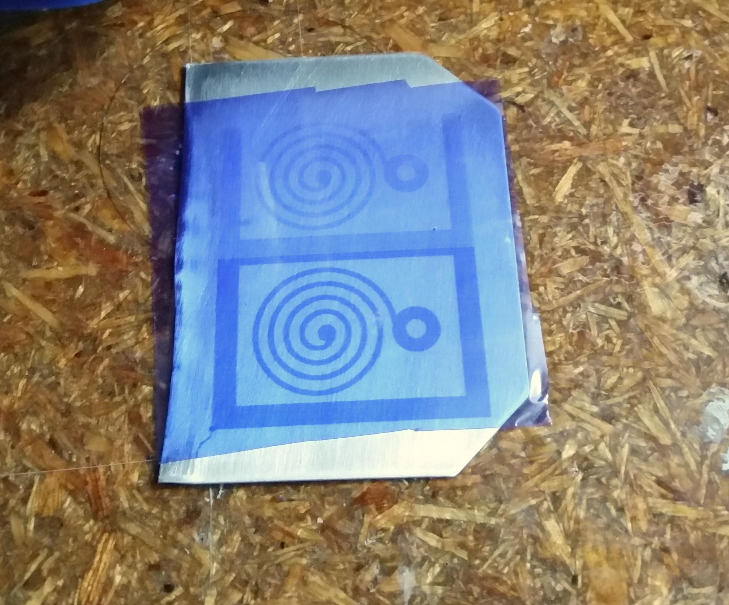

Overexposure and light bleeding:
With this piece I was testing out the power settings of my laser.
You can see by looking at this picture of the developed film that the one on the left was overexposed and caused the light to bleed and expose the areas next to the design.
By looking at this picture after it was exposed but before development you can see that the design should be just barely visible like the top and not a dark blue like the bottom.
