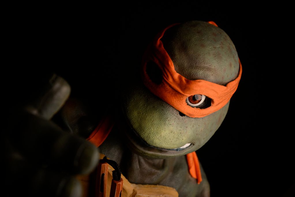

Step 5: Casting
Now that the molds are finished it is time to cast in the desired material for the final product. For my build I used dragon-skin fast silicone. The material is flexible and long lasting. Perfect for all the ninja moves that Mikey will be performing!
Casting
1) Apply a good coat of releae agent to the inside of the silicone mold.
2) Mix and SLOWLY pour the dragon-skin material into the molds. (Helps remove in air intraptment)
3) Continuosly rotate the mold until the dragon-skni material evenly coats the entire mold.
4) Add more dragon-skin until a good even thickness is achieved.
5) Open the mold and gently remove the dragon-skin cast!
*Same process is used for the foam shell, just different materials*
Casting
