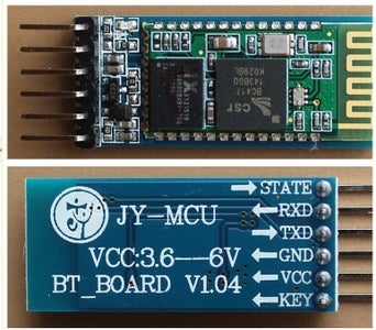

  • Bluetooth Module(here HC-05)

Note: connect VCC and GND of bluetooth module to 5V and GND of Arduino respectively.
