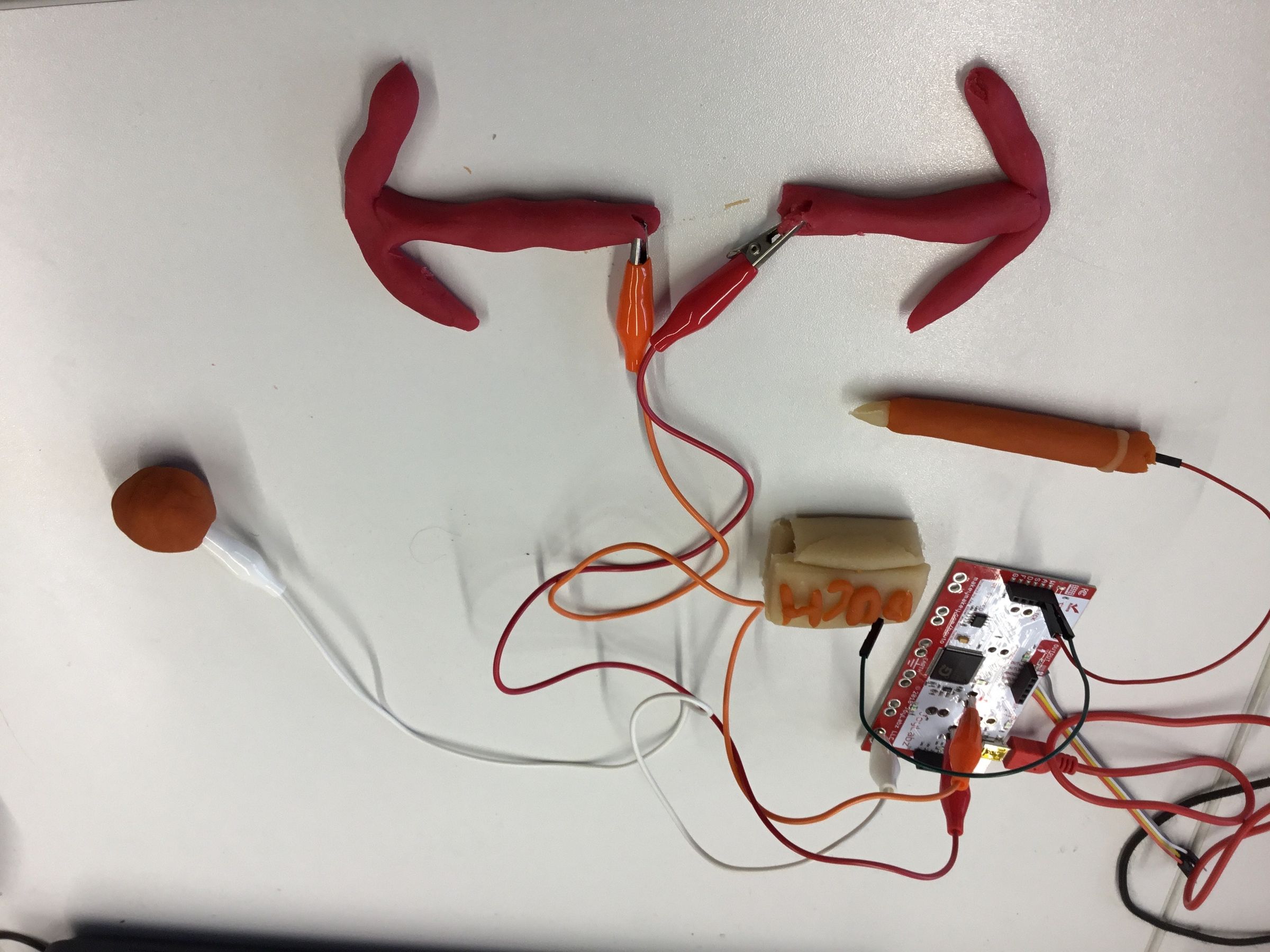

Step 3: Kneading and Tinkering
Now the desired shapes and figures are kneaded, also mixed with other materials and things.
It is important that a piece of dough remains open so that you can touch it later.
Step 4: Connecting With the Makey Makey
In the next step the dough is connected with the Makey Makey. Attention: Do not forget the connection for the earth. Now the Makey Makey is connected to the computer.
