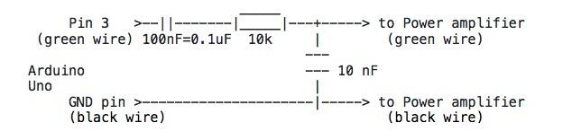

To avoid clicks during the speaking, a low pass filter connects the power amplifier. The circuit is in the photo.

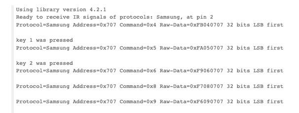

  6. Turn on the Serial Monitor (click “Tools” and then click “Serial Monitor”).
To see the signal codes of the TV remote control, point the TV remote at the IR sensor and press a key. The data for that key should appear on the Serial Monitor. The photo is a screen-shot of the Serial Monitor, showing the codes for keys 1 to 5 of my Samsung TV remote control.
“Command” is the signal code. The codes for my Samsung TV remote are shown below:

After you have the signal codes for your TV remote, the project sketch needs to be changed to use those codes instead of the Samsung codes.
