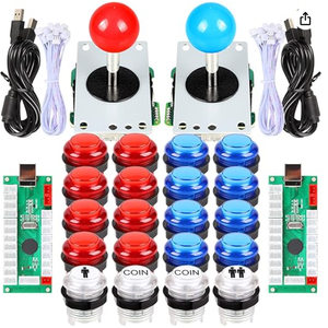

https://www.amazon.nl/gp/product/B01N43N0JB/ref=ewc_pr_img_2?smid=A1N1MN91UPB9Z0&psc=1

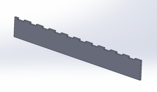

Alright, let's begin! First up you get on a 3D drawing program, we used solidworks, to design the the wooden plates used to make the cabinet. depending on which laser-cutter you're using you'll need to split some parts into two pieces since they'll be to big for most laser-cutters. In the mean time you'll get started in the programming for the Raspberry Pi.

Lasercutting: Good, you've finished the Cad drawings for the cabinet. This part is pretty straight forwards. Make sure to save them as dxf files, since pretty much every laser-cutter needs your files in .dxf. Make sure to follow the correct operating procedures of the laser-cutter you're using and let the machine do the work.

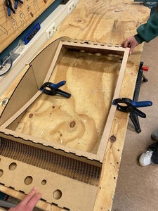

Once the parts are laser-cutted you start assembling the cabinet. we used epoxy since MDF reacts nicely to it, but feel free to use whatever glue you like. When the cabinet is is drying, you can start assigning button's, since the button's have to be in place for the wiring to be connected, allowing for assigning of the button's. Once that's done you put the screen in, then each component after another with the Raspberry Pi in the middle & the wiring neatly routed.
