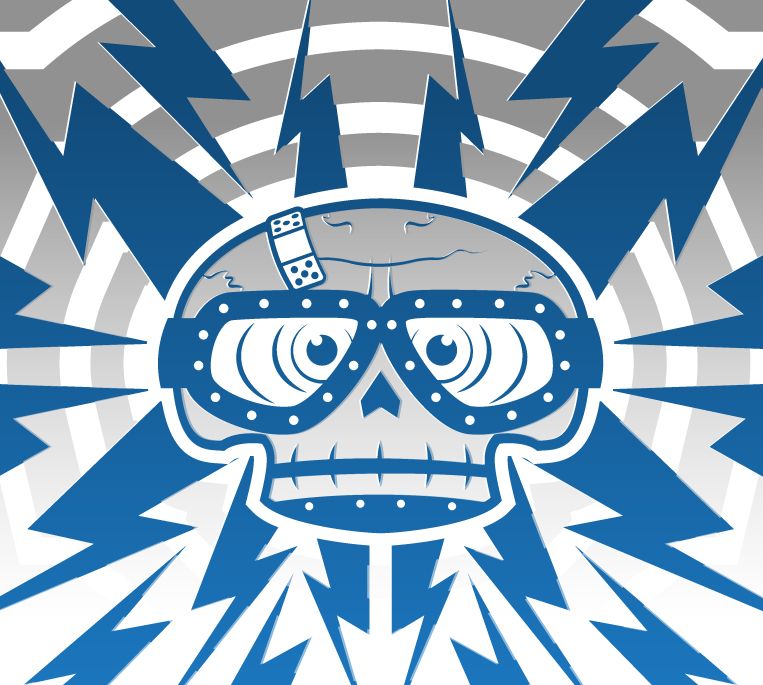

Step 1: Step 1: the Design
This is not meant to be a lesson in graphic design. A basic knowledge of Adobe Illustrator, Photoshop, or Corel will be about all you need.
