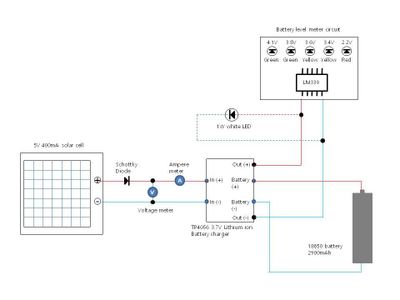

Step 1: Schematics
As shown in the schematics above, the solar power generating circuit itself is simple.
As I'm interested in the operational scheme of the solar cell, several measuring circuits are included such as a voltage meter, ampere meter, and battery capacity level meter.
I'll explain each measurement circuit one by one in the later step or at the other instructable as each device is a little bit complex.
The operational scheme of this solar circuit is simple like below.
-     Solar cell produces about 50mA current when it receives sunlight (Although the solar cell specification claims a maximum of 400mA, the actual current I got under the sunlight through windows is 50mA)
-     TP4056 lithium-ion battery charger circuit storing electric energy from the solar cell to 18650 battery (This module prevents overcharging and over-discharging of 18650 battery while operating)
-     The 18650 battery storing energy from TP4056
-     Battery level indicator circuit showing the capacity level of 18650 battery (This circuit was explained in other Instructables)
-     1Watt LED circuit is a load of this solar circuit and consumes energy stored in the 18650 battery
As this kind of solar circuit that charging battery is very common, maybe no further explanation will be necessary.

As the circuit is simple, no additional wiring diagram will be necessary for explaining the part connection details.
The solar panel is connected with the TP4056 charger via the Schottky diode.
The diode prevents current flow from the battery to the solar panel during night hours.
The 18650 battery is connected to the Battery(+/-) pin and the TP4056 charge current to the 18650 with a regulated 4.1V level. (So output power from the solar panel is less than 4.1V, actually charging seems not occurring)
For a load of battery (Stored energy consumer), 18650 battery level circuit and 1W power LED are used as details explained in the following instructable.

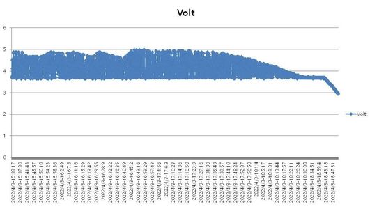

Step 4: Measuring Voltage Produced by Solar Panel
Firstly I'm supposing 5V is produced by the solar panel I bought.
As the specification of the solar panel is rated as 5V and claims to produce 400mA, I naively assume that a constant 5V can be observed when the panel is exposed to sunlight.
But to my surprise, during the daybreak and sunset, the output voltage is less than 3V as shown in the graph above.
Even under the sunlight, the voltage produced continually changes from 3.3V to 4.9V.
The voltage measurement is conducted from 3:30 pm ~ 6:40 pm under the sunlight on a very bright day.
I don't know why the voltage is changing continually under the clear and bright sunlight. (Really that day is very clear and without any cloud)
The output voltage is measured every 5 seconds with an Arduino voltage meter which will be explained in the next step.
Anyway, I can see the actual solar panel operational scheme with the voltage meter.

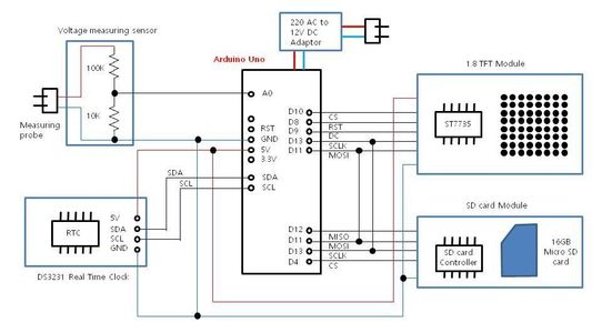

Step 6: Voltage Meter Schematics
Without this Arduino voltmeter, you can measure voltage with a simple tester that can measure DC voltage.
But to know more detail about voltage change trend according to the sunlight condition changes, RTC (Real Time Clock) and SD card data storage is essential.
By collecting timestamps and measured voltage results, you can understand the actual working details of the solar panel.
That's why I'm making this device as part of this solar circuit project.
This is typical data logging Arduino circuit using DS3231 RTC and SD card break-out modules.
As a result, I can understand that the solar panel produces less than 4.1V output voltage during quite significant times.
As the TP4056 is charging the battery only at the regulated 4.1V level, the charging circuit is idly stand-by about 1/3 times of solar panel operation.
Therefore, the 18650 battery level increased by less than 100mAh for all day long. (Increasing battery voltage from 3.5V to 3.6V)
This is a quite disappointing result with the 128mm x 128mm size solar panel.
Maybe I need a bigger and more efficient solar panel for fully charging the 18650 battery within 8~5 daylight hours.
Step 7: Arduino Sketch Program of the Voltage Meter
As measuring voltage is not complex by using a voltage divider circuit, the sketch program logic is also straightforward.
Per 5 seconds, Arduino is measuring the changed resistance value from the A0 analog port by the variance of input voltage.
Then data is stored in the SD card with a timestamp created by RTC.
This voltage meter can be a useful device when you are necessary to measure any voltage change on a long-term base.
