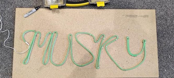

Now you've got the design on the board, youre going to choose where to start and grab your hammer and nails. Roughly look at the width of your neon rope and youre going to start nailing into the board with enough space to then fi the rope between the nails but it fits quite snugly.
Continue pulling the rope, marking out 'pin points', nailing them in and then wrapping the rope around/through. You'll find you actually need less than you think but if you do extra, it doesnt matter, you can just pull them out. Make sure your nails dont go all the way through the board! They should not poke through the back side and should have about 10mm sticking out the front side.
Be patient and take your time getting each letter before moving on.
When you're done, it should look something like what I have attached. (Use my nails as reference points for specific curves)

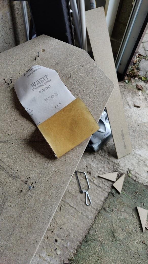

Any saw here will do, just trim the backboard to your desired size.
Now you're going to sand the edges and this is important! It will make a big difference in the end so just try and smooth it over.

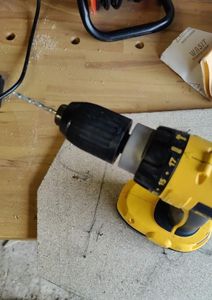

I also knew i wanted to screw this into the wall so i drilled my holes here too. Consider how you will mount it so we dont stick anything ugly on the front of this.
