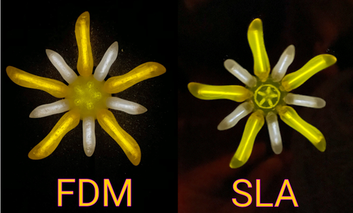

Each version I made is slightly different. The first version used my FDM 3D Printer. FDM (Fused Deposition Modeling) printers use a spool of filament, such as PLA. I made the second version with my SLA (or Resin) printer. The steps (and results) are slightly different depending on which printer you use, so I will provide separate FDM and SLA instructions where necessary.

I've made one Night Blossom using filament, and one using resin. Personally, I like certain aspects of both. I like the more diffused light of the filament version, but I like the way the bud looks on the resin version. It's up to you! Now that I think about it - you can even do a mix of both methods if you want.

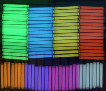

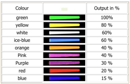

Next, you need to decide what colors you will make the petals and bud on your flower. Tritium vials come in many different colors. You can use whatever ones you want, as long as your purchase follows the size guidelines I listed in the Supplies step. Keep in mind that some colors are not as bright as others, which is why I opted for White and Yellow in my design.

FDM
Print all the parts in clear PLA. We'll discuss finishing them in the next step
SLA
Print the parts using clear resin... but we're going to tint the resin using the epoxy pigments from the Shopping List. I recommend tinting the resin before you add it to your printer's tray to ensure it's mixed thoroughly.
You can use whatever colors you want, but I suggest matching the colors to the Tritium vials you have chosen. For example, since I used Yellow for my long petals, I printed those with a Yellow tint. My shorter petals use White vials, so I tinted them white (don't use a 'factory' white resin: it will be too dark). The stem is printed with a green tinted resin.
This is a little wasteful - you probably won't use all the resin you pour. If you want to save on material, you can print the parts in clear, and follow the next step (which is normally only for FDM printers).
