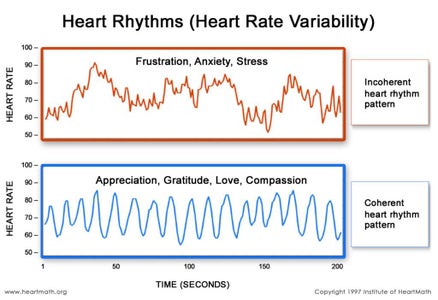

"A healthy heart is not a metronome." (source)
I was shocked to learn this. Growing up, I had always heard that 60bpm (beats per minute) was a good thing. But as I learned more about stress and meditation, I discovered that Heart Rate Variability (HRV) was the real indicator. HRV is the change in the time intervals between adjacent heartbeats.
Think about it: When you reach for that jar in a tall cabinet, or bend over to pick up that Lego you just stepped on, your heart must make minor adjustments because you are suddenly calling on your body to perform more work. It's not heavy cardio, but it is different than just sitting sedentary on a couch.
As I learned more about HRV, I discovered that scientists have known about it's importance since at least the 1960's. Based on multiple studies, poor HRV can be correlated to disease, obesity, and even mortality. Good HRV on the other hand, has been correlated to all kinds of positive outcomes including weight loss, increased concentration, and even success quitting smoking. I'll link to a few helpful studies below.

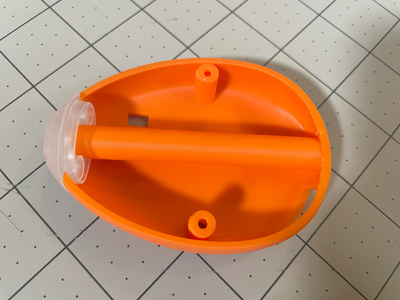

Step 2: The Case
The case is designed to be 3D printing using either an FDM (filament) or SLA (resin) printer. For the cleanest results on the body (for an FDM printer), I find the orientation in the attached image to be the best approach.
Feel free to use different filament colors for the body, or apply a coat of paint to customize it to your liking.
I usually print the nozzle in the orientation shown, which means some clean-up sanding after I remove all the support material. Feel free to print it whatever way gets you results you are satisfied with. It's very important to print the nozzle in clear filament (FDM) or translucent resign (SLA) because the glow from the LEDs needs to be visible to the user. If you print it in a solid material, the soft, pulsing glow which encourages proper breathing won't be noticeable.
Once you've printed the 3 pieces, you can glue the nozzle to the bottom of the case using some superglue.
Bonus: I made an alternative "Iron Man-style" version of the top. You'll have to hand-paint it (and it screws, rather than snaps to the bottom), but I thought kids might like it.

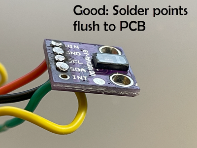

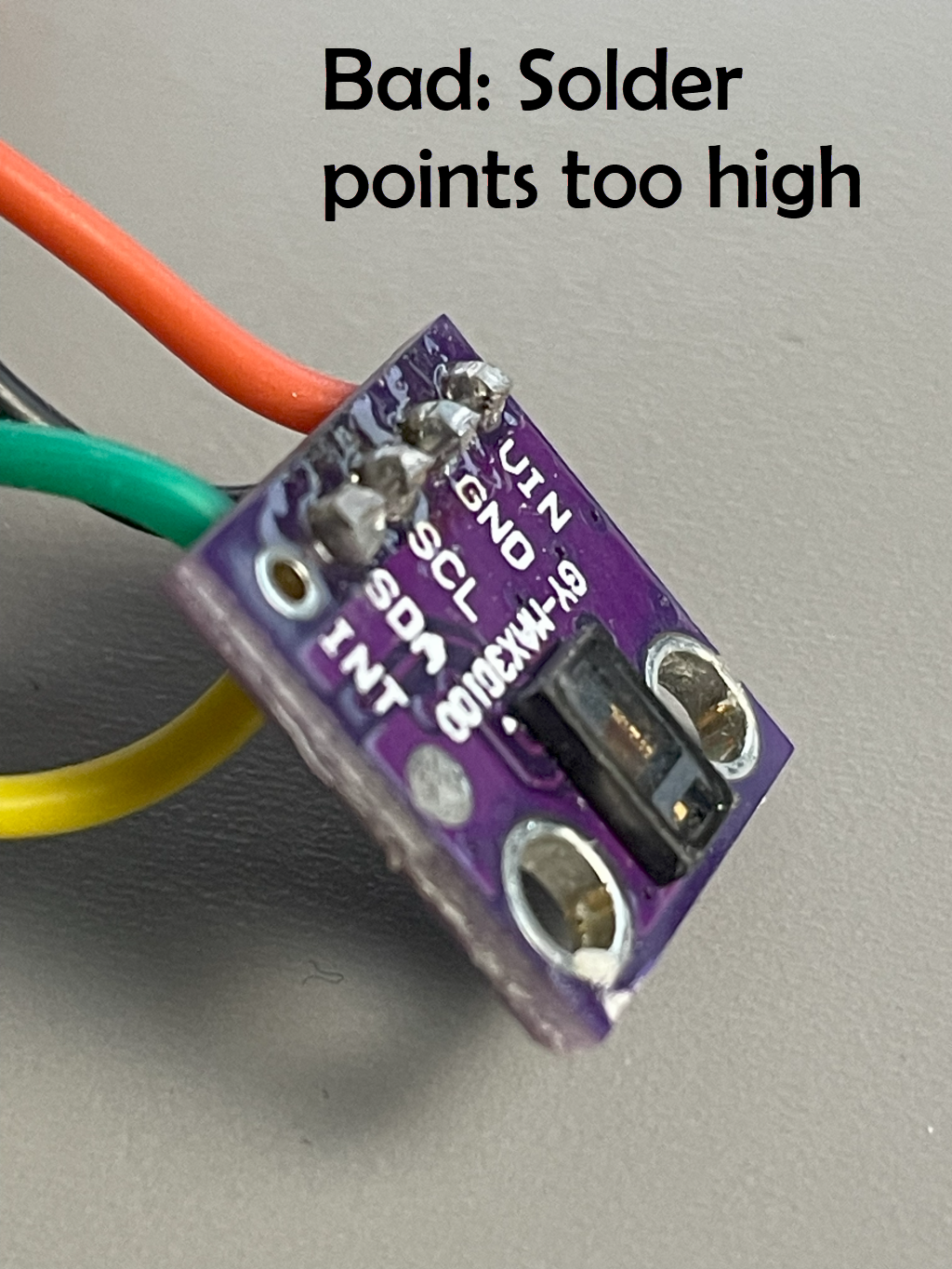

Now let's connect the MAX30102 sensor. The VIN contact on the sensor connects to the VCC contact on the Pro Micro. GND on the Max30102 connects to GND on the Pro Micro. SCL on the Sensor connects to Pin 3 on the Micro. Finally, SDA on the Sensor connects to the Micro's Pin 2. The INT contact on the Sensor is not used.
We need the sensor to stick out in the case as much as possible - so look at the attached images for good and bad examples. If your solder connections are higher than the sensor itself - that's going to prevent the sensor from detecting heartbeats accurately. You can always grind down a tall connection using a nail file or a Dremel. You want it almost flush to the circuit board.

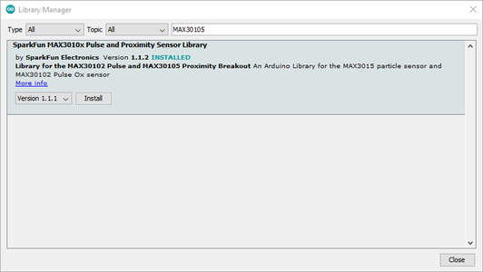

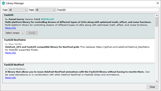

Once you have set up your Arduino environment to program the Pro Micro, you need to install two additional libraries to work with the ZenPen: The SparkFun MAX3010x Pulse and Proximity Sensor Library and the FastLED Library.
Generally, the process for installing a library on the Arduino IDE is very simple. Under the Tools menu, select Manage Libraries and a dialog will display with a Search box. Type in "MAX30105" in the search field, and from the list of results, click the latest version and press the Install button.
Next, type "FastLED" and from the list of results choose the latest version and click Install. There are lot of results for this search; you want the basic one written by Daniel Garcia.

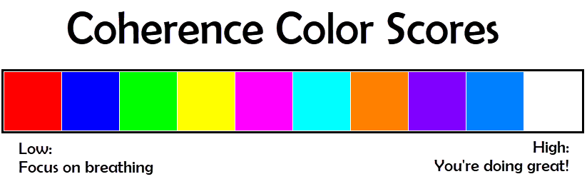

As your Coherence score improves (or declines), we change the color of the nozzle's LEDs according to this scale (from worst -> best)
  1.  Red (or, no reading)
  2.  Dark Blue
  3.  Green
  4.  Yellow
  5.  Light Purple
  6.  Cyan
  7.  Orange
  8.  Dark Purple
  9.  Light Blue
  10.  White
It's not critical to memorize the order of the colors. With regular use you'll start to associate particular colors with being more relaxed and know when you are making progress or falling backwards. Initially, you'll probably get excited when you see the colors change and that may undo some of your progress! Stick with it and you'll be able to predict the color changes based as you feel yourself become more relaxed.
