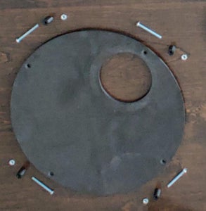

This off-axis mask is designed for an Explore Scientific ES10 Hybrid Dobsonian telescope. The port is a nominal 4” diameter positioned to allow an unobstructed pathway past the secondary. The port can use an insert to hold a solar filter cell as well.
With the large diameter the mask is printed in quadrants which are then bonded to a support strip with cyanoacrylate glue. The mask is then covered with a 2mm PVA foam sheet to act as an insulator from solar heating as well as a second light blocker on top of the mask itself.
The mask is then attached to a 3d printed collar to secure it to avoid any movement when viewing. Spacers are used to ensure it stays level without bowing when secured over the rim of the secondary assembly.
A cell to install in the port allows for quick pressure fit assembly of the solar cell, or whatever medium you may be using for other non-solar viewing.

Step 1: Mount Ring
Print the 4 pieces of the mount ring. Use a the #10-24x3/4” Machine Screws and nuts to connect 2 of the ring segments together. Repeat for the remaining 2 segments. Place the 2 assemblies at the top of the secondary holder and attach together with the remaining screws and nuts.
Step 2: Mask Assembly
After printing the 3 pieces of mask and the port section, they will be joined with CA glue using the Solar Cap Seam support and the supprot tabs. They should fit snugly but easily without creating a gap between the quandrant edges. Some fine sanding may be required to get his to fit snugly.
After the parts are bonded, a covering of white PVA faom can be applied with spray adhesive to create a thermal abrrier to reduce the chance of deformation from solar heating.
Step 3: Filter Holder Assembly
Print the grommet, grommet nut and filter base. These will be inserted into the port to allow for the placement of the solar filter.
I used Thousand Oaks Optical Solarlite film for this application, but use the material of your choice.
The round ring caps will sandwich the filter material and the perimeter of the part with EVA foam to make a snug pressure fit for the cell into the filter base.
