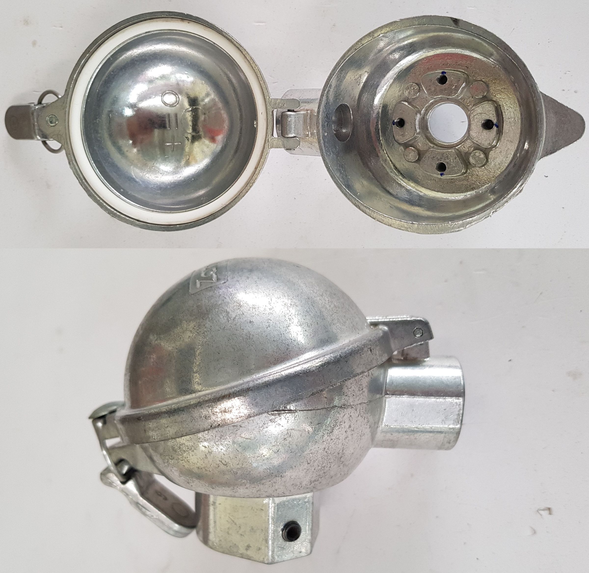

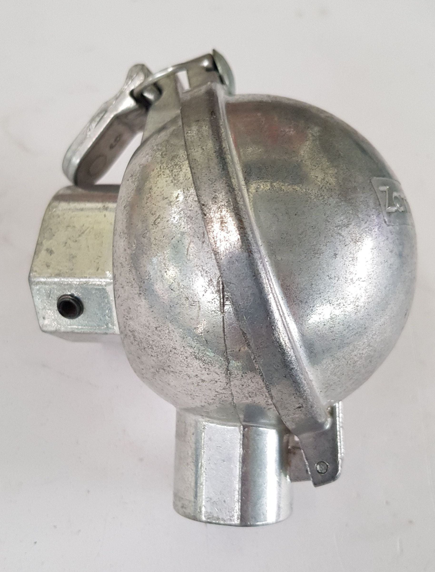

- Broken industrial thermocouple: I reused a broken thermocouple head cover as picture below. It is in spherical shape and can contains a Neopixel Ring 16.

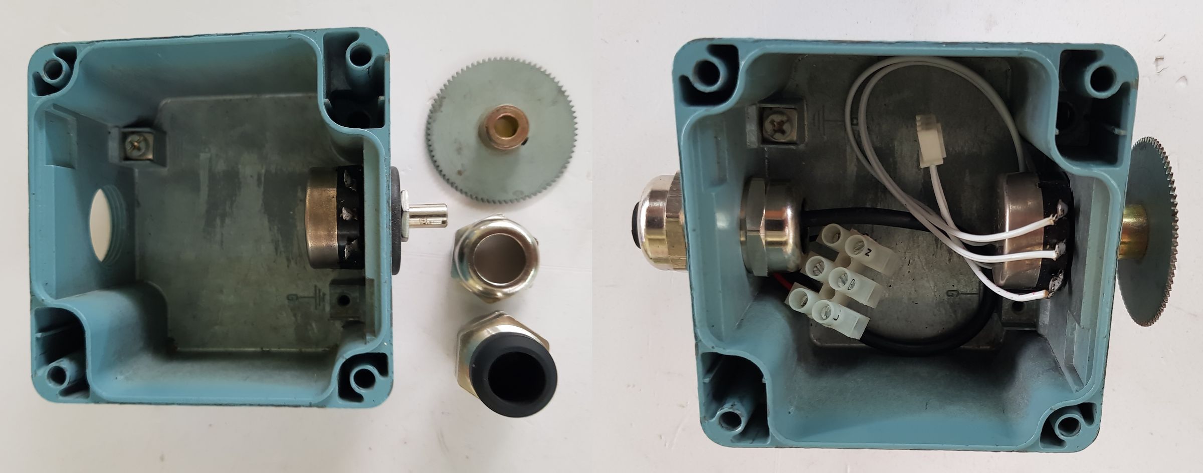

- Local box: I used Schneider’s local box with specification XAPM1501H29 - Metal Enclosure, 22mm, Control Station, Control, Zinc Alloy, 80 mm, 80 mm, 74.5 mm, IP65. LINK

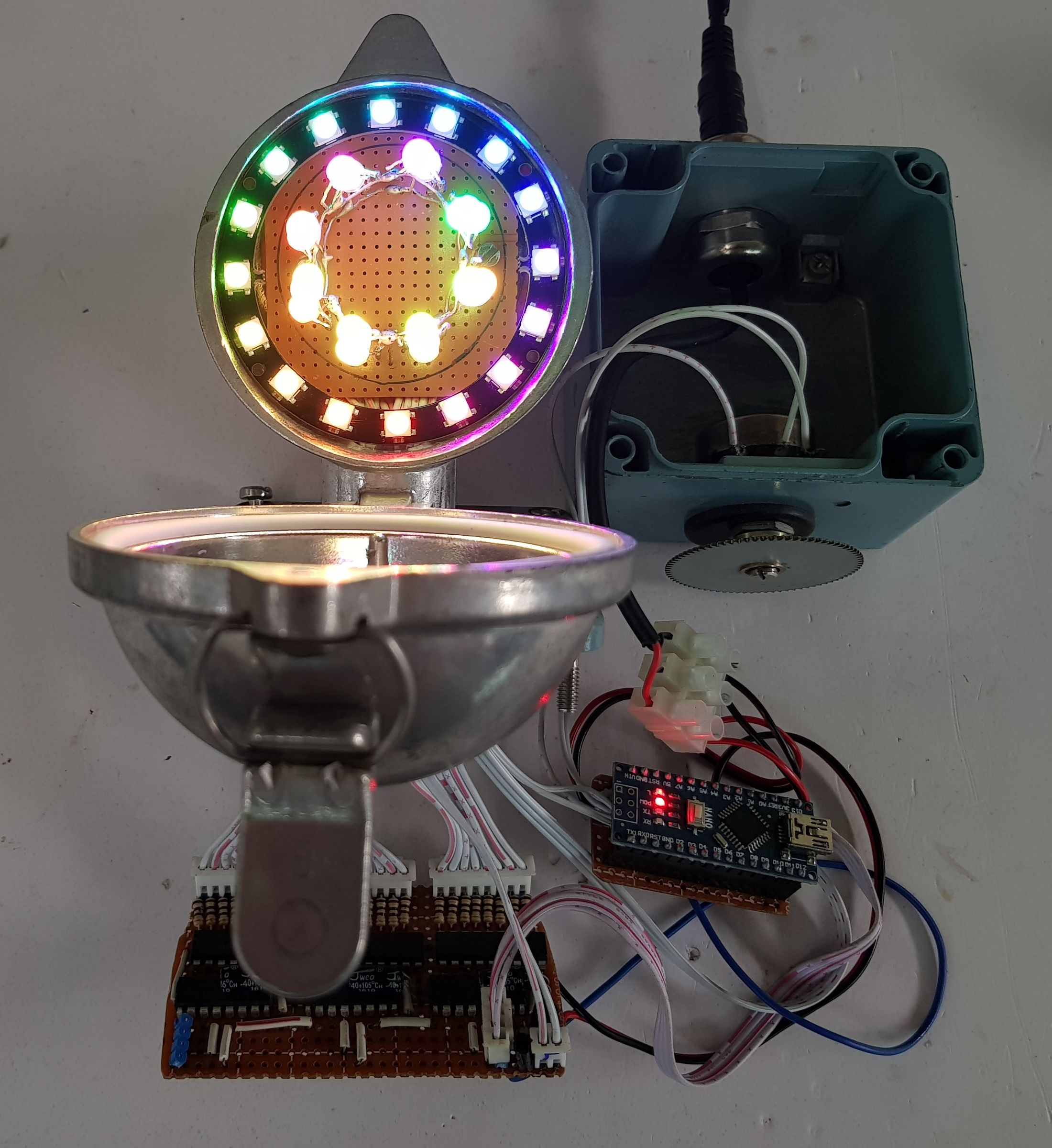

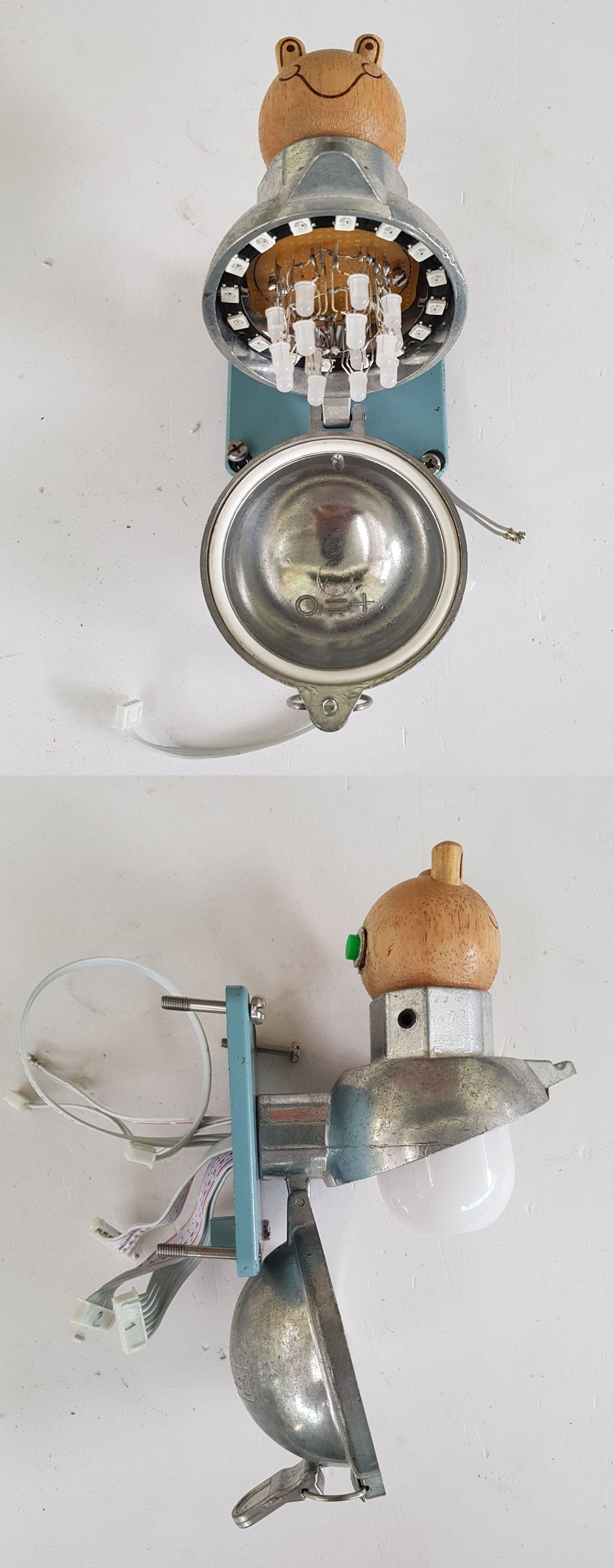

1. Build LED bulb and Neopixel Ring 16
- Prepare broken Thermocouple head: It has 2 holes, one with diameter 21mm will be connected to local box and the other with diameter 32mm will be connected to snowman head with push button. Let's see on next step.

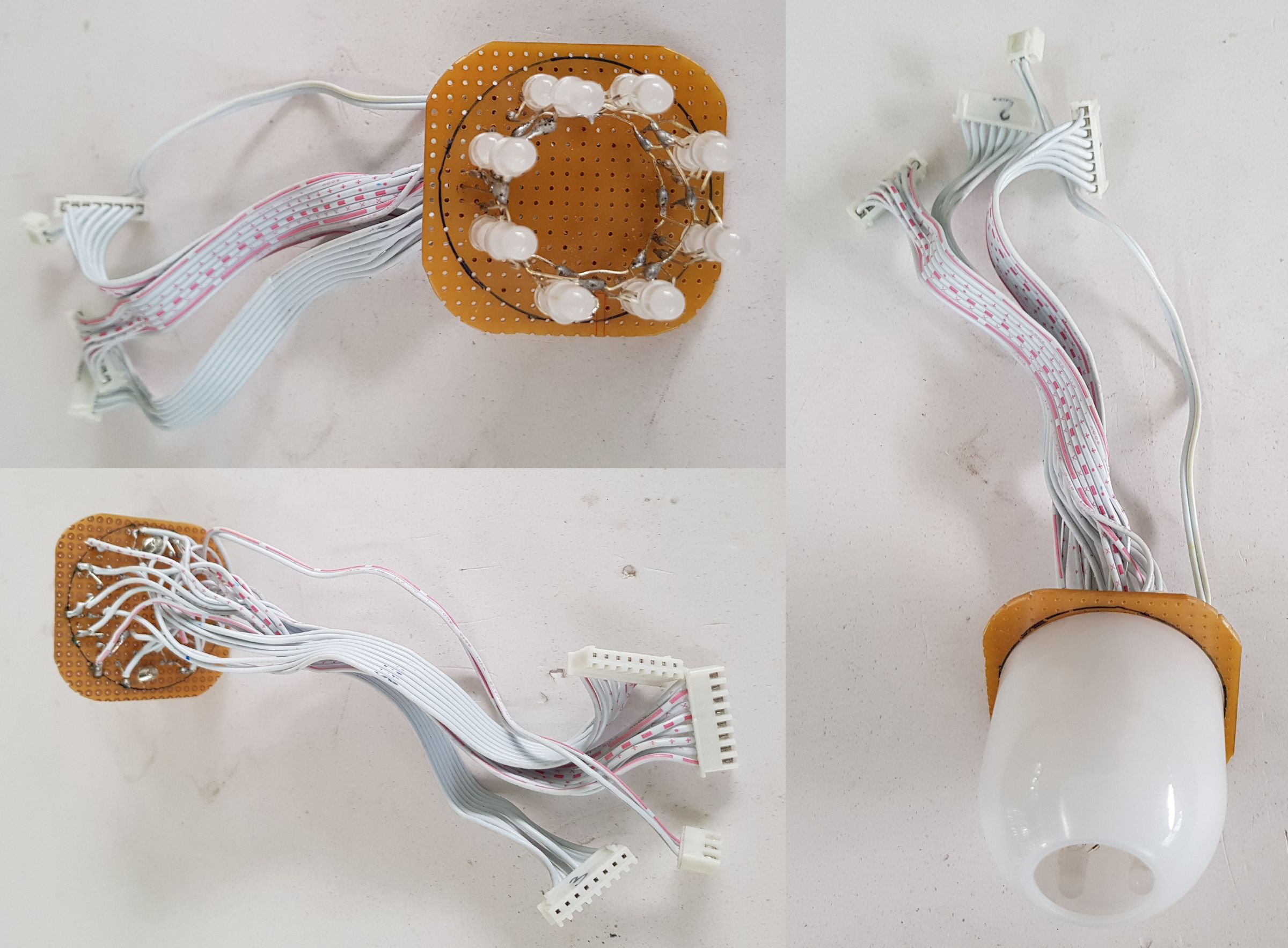

- Soldering the RGB LED bulb: 16x RGB LEDs - common anode were soldered on small Prototype DIY board with 2 layers and in cylindrical arrangement. Later it will be putted inside the bulb cover.

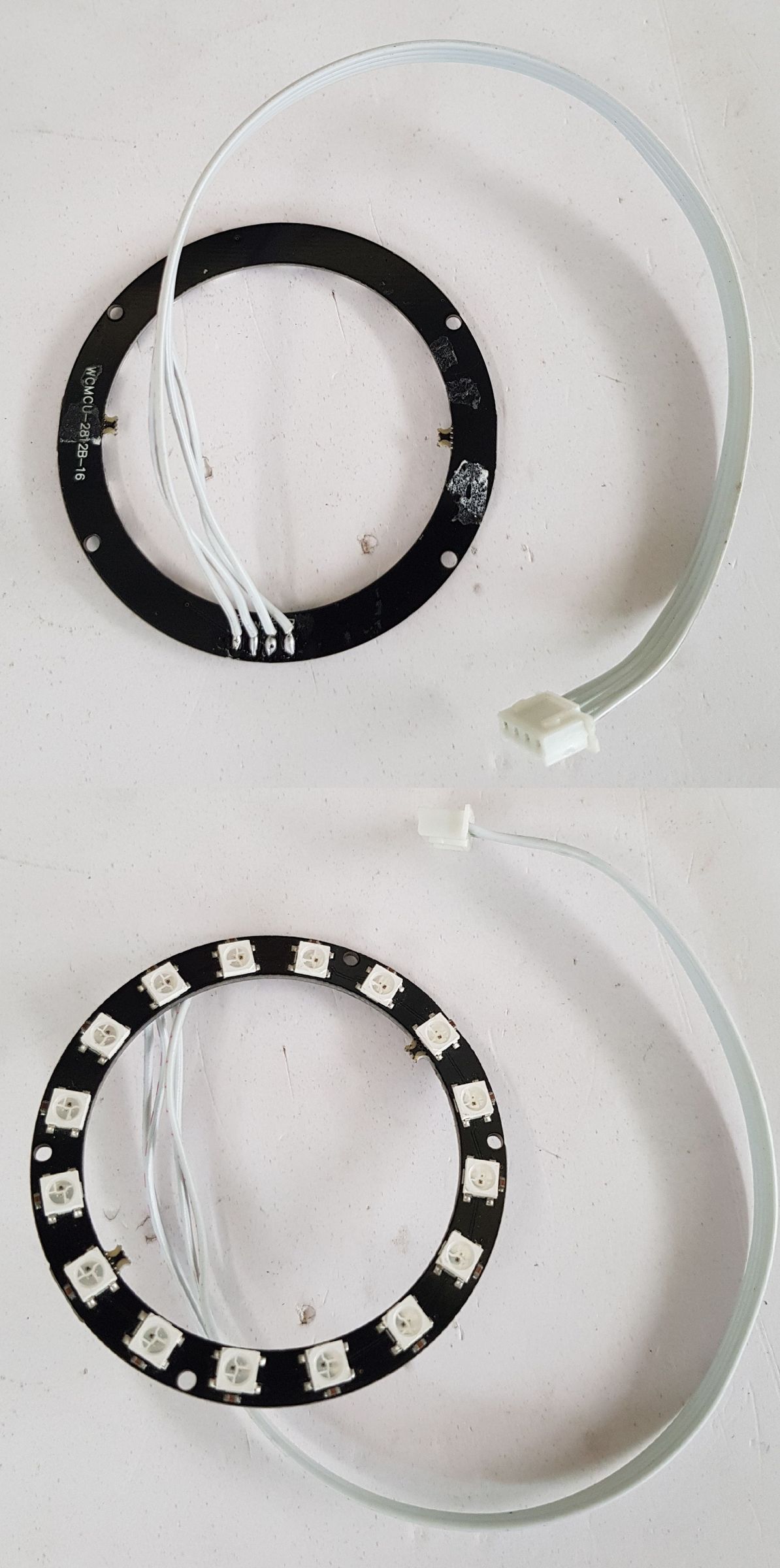

- Prepare Neopixel Ring 16: This RGB LED fitted just fine when placed inside thermocouple head above.
2. Build shift register board and Arduino Nano Adapter

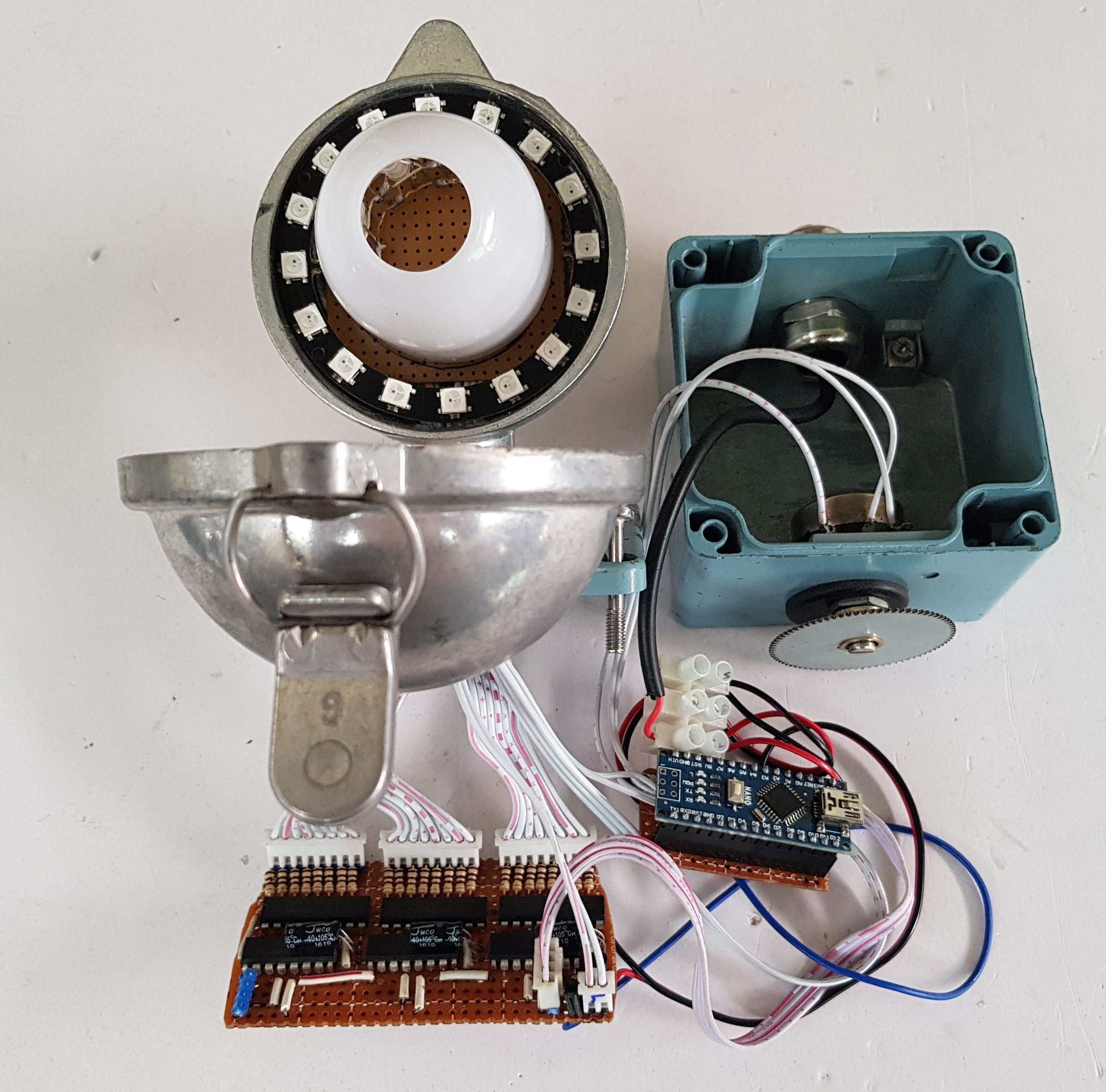

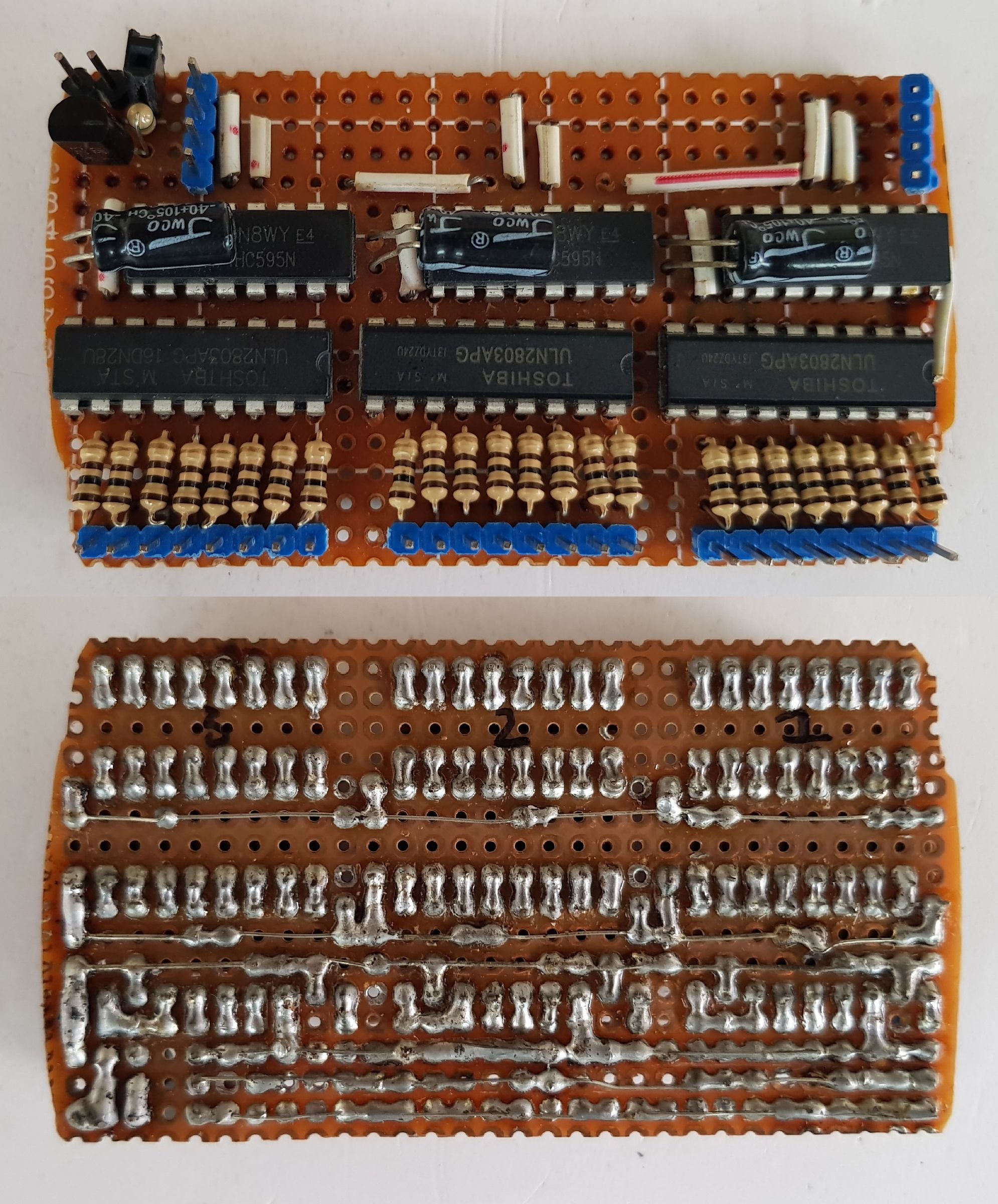

- Shift Register Board: Following project schematic, I installed 3x 74HC595, 3 x ULN2803, 24 x 100Ω resistors, 3 x 0.1uF capacitors on prototype board and did soldering work. Each shift register 74HC595 + ULN2803 will control one color, so we have totally 3 shift registers for handling: Red, Green, Blue colors. Arduino Nano pins are assigned for SPI controlling as follow:
- BLANK PIN (ENA) ------------> 03
- LATCH PIN (RCK) ------------> 02
- CLOCK PIN (SCK) ------------> 13
- DATA PIN (MOSI) -------------> 11
For anode layer of RGB LED, I used Trasistor A1013 and it also was soldered on this board.

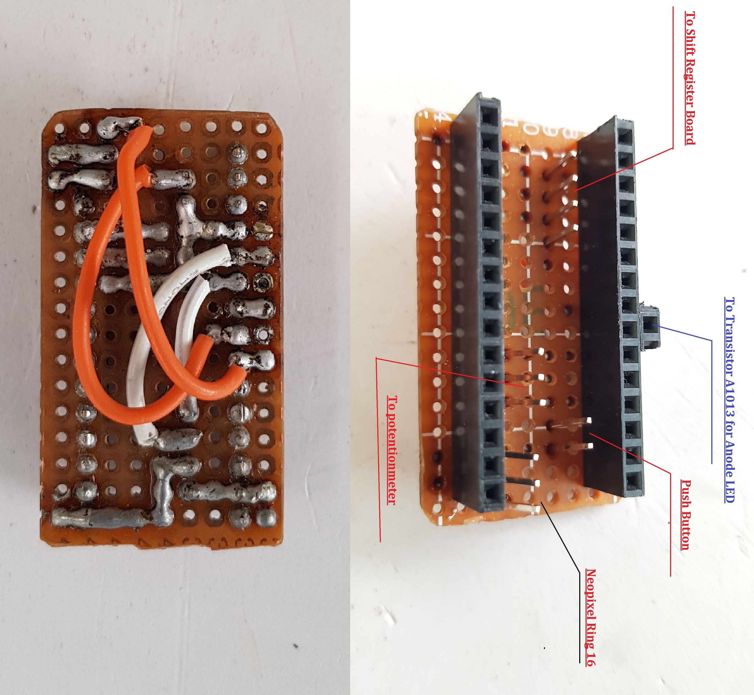

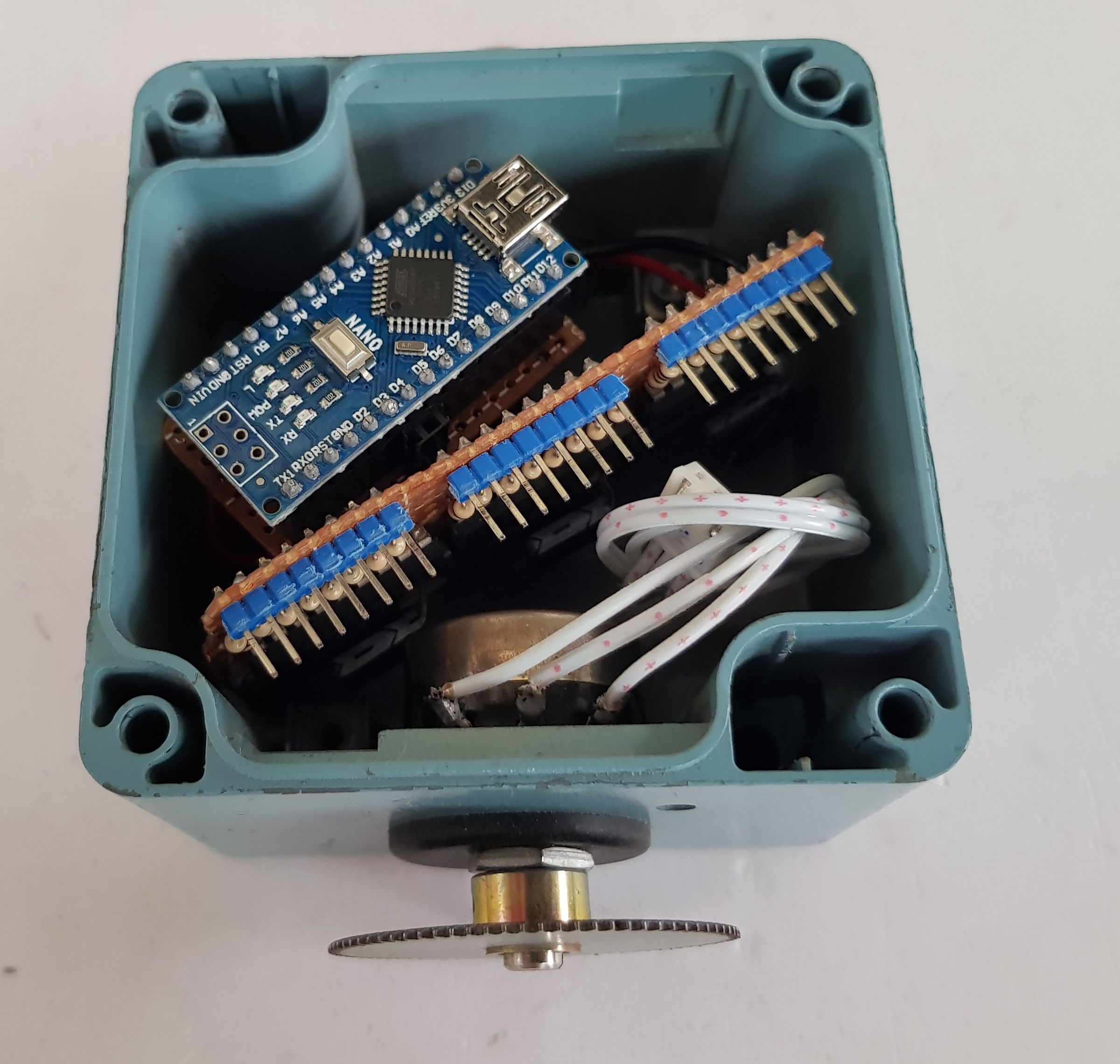

- Arduino Nano Adapter: Soldering some male headers as picture below after connecting Arduino pins following project schematic shown on previous step.
3. Box assembly

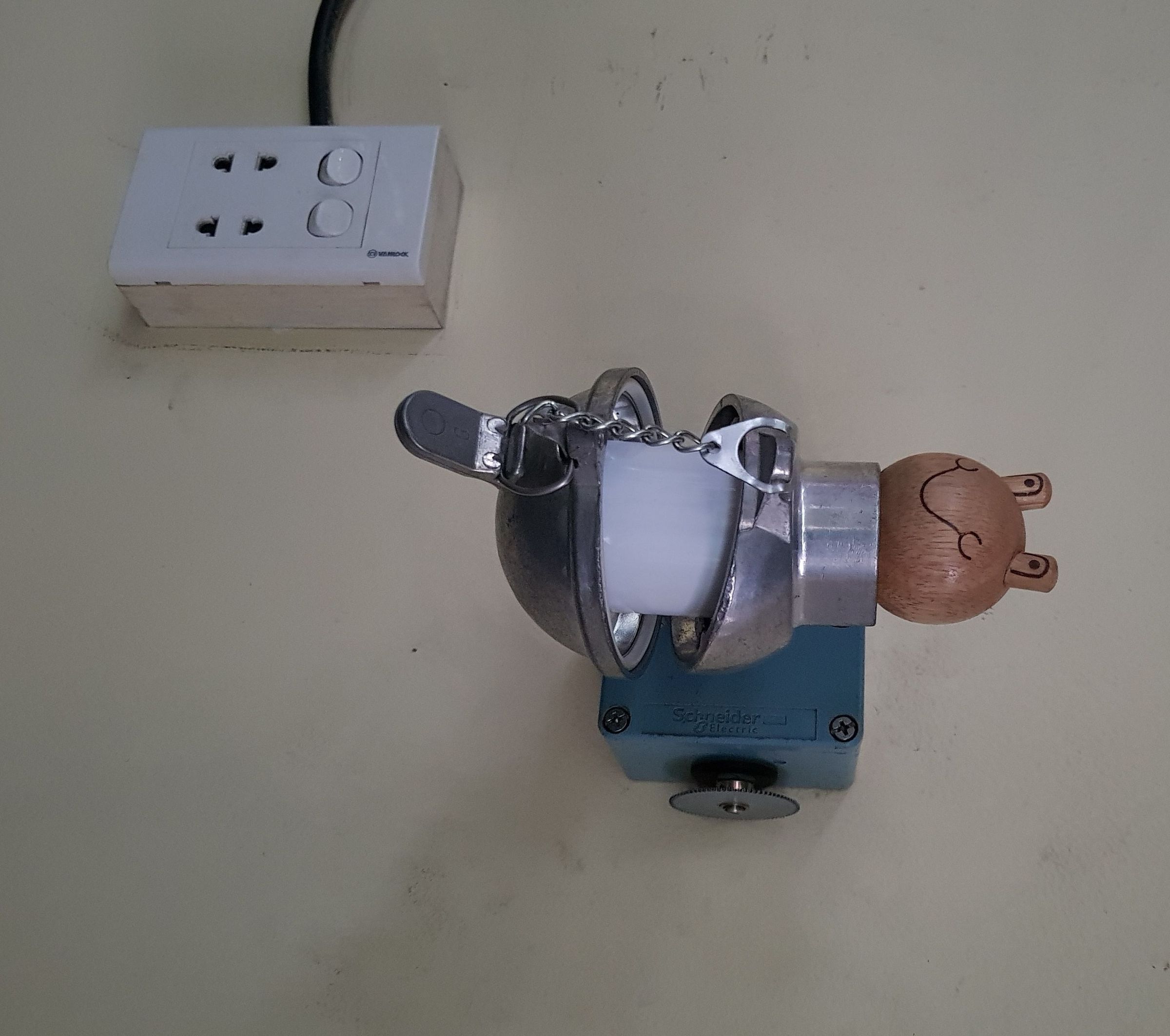

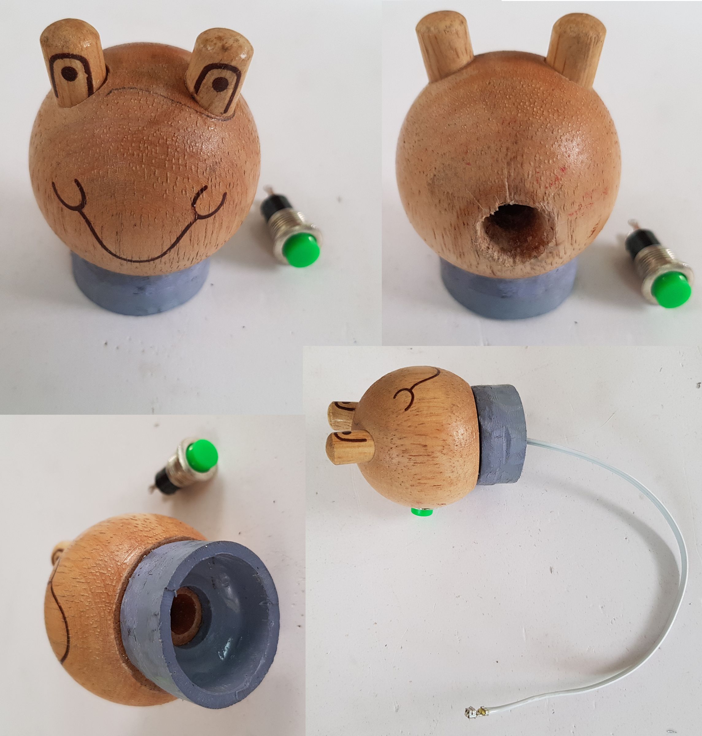

- Prepare OLAF head - snowman for Christmas: To connect snowman head with push button to thermocouples hole, I used PVC pipe with diameter 32mm and glued them together. Actually, I don't know whether it's like a snowman or not :-)

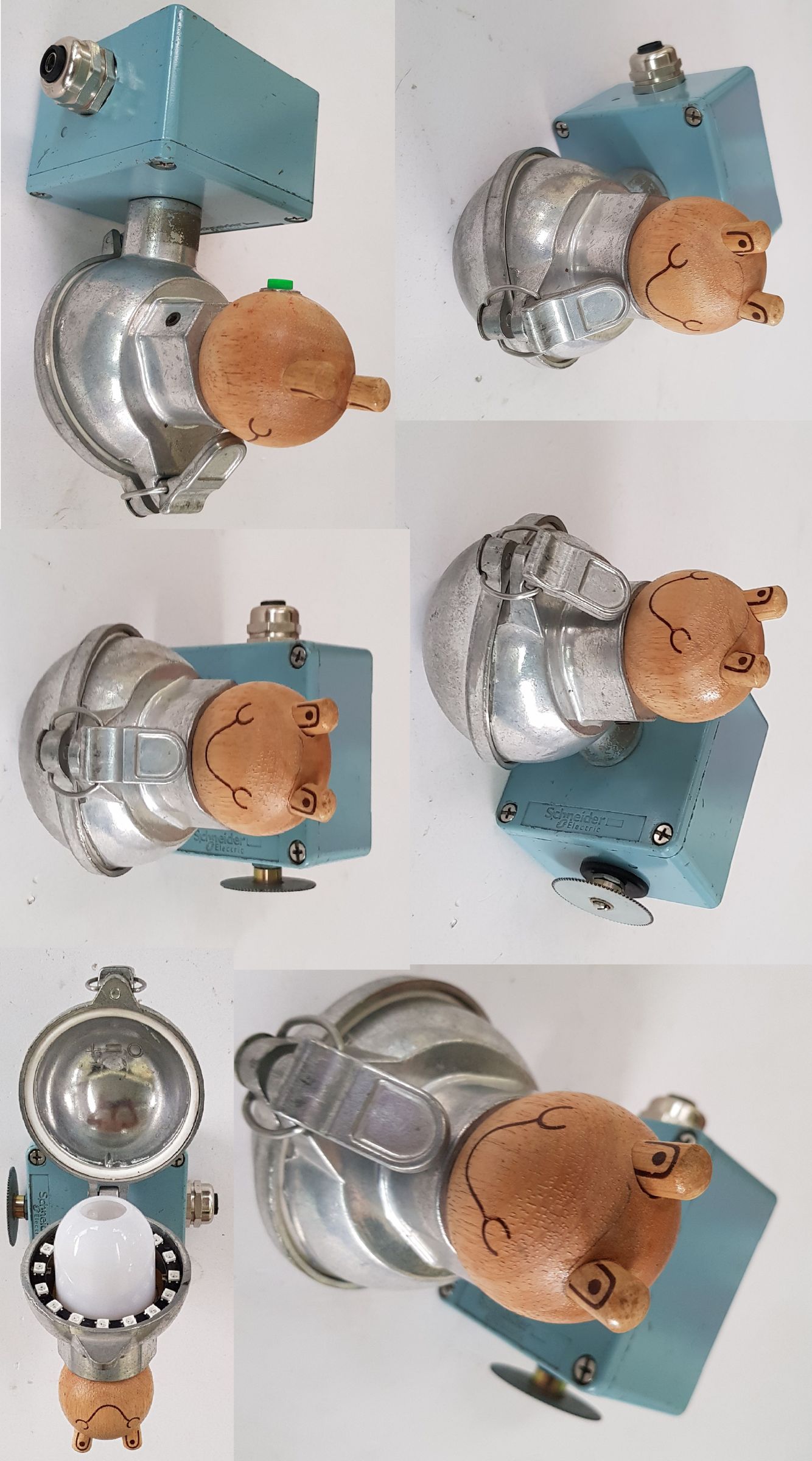

- Connecting OLAF head, LED bulb and Neopixel Ring 16 on top of local box.
- Power supply and Potentiometer assembly.
- Putting Arduino Nano and Shift Register Board inside the box to make sure everything OK.
- Connecting all components.
- Do testing before final assembly
- DONE
- Mounting local box on the wall for decoration

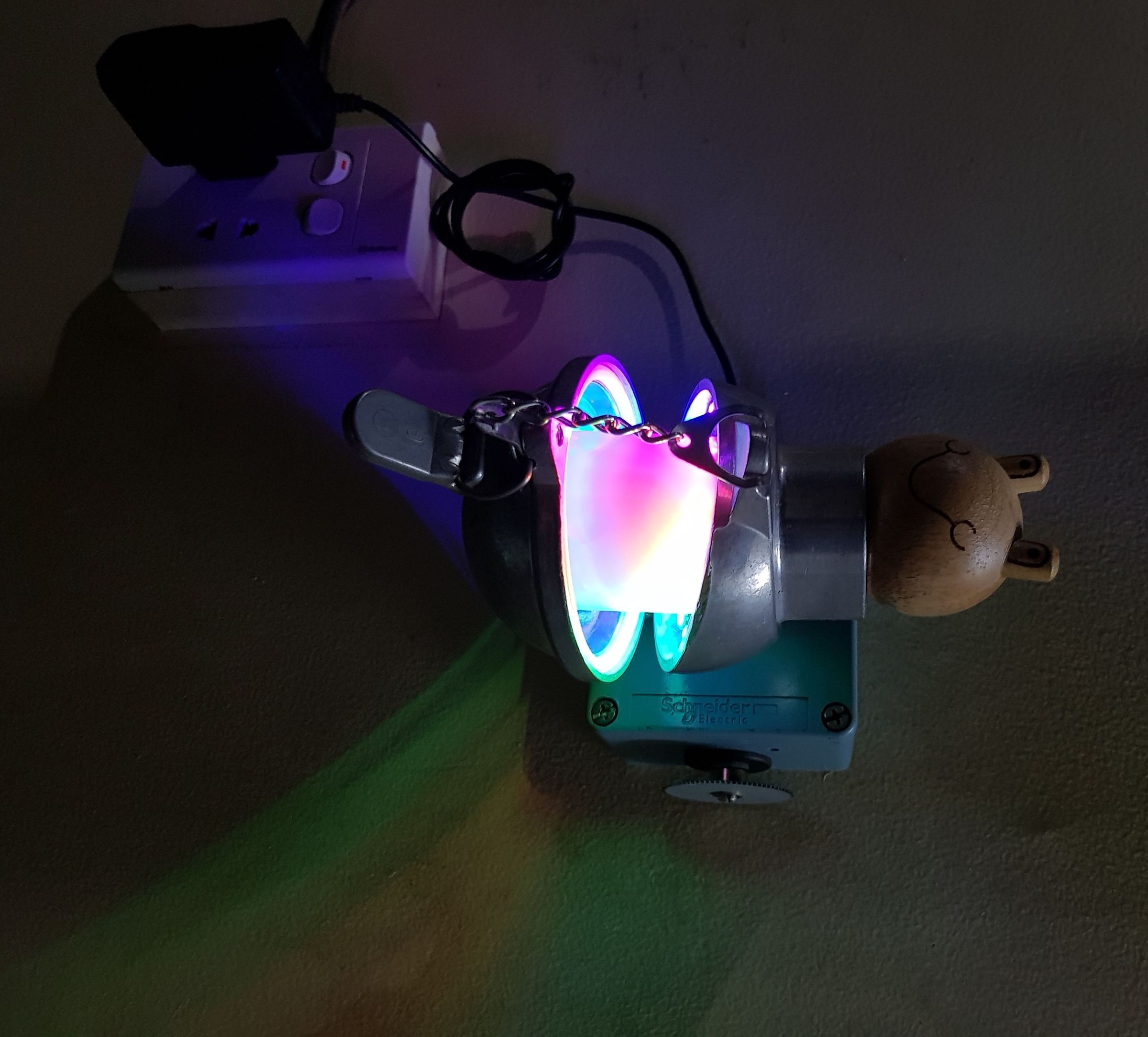

Please see video below for my first testing:
This "Open, sesame! LAMP" has 4 working modes that is selected through push button as follows:
- Bulb + Neopixel Ring Colorwheel mode.
- Bulb + Neopixel Ring Single color mode.
- Only Bulb single color mode.
- Neopixel Ring Colorwheel mode.
