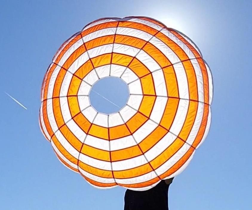

Introduction: Orange and White Apollo-Style Model Rocket Parachutes
This Instructable covers how to make orange and white multi-gore, domed cloth parachutes for mid- to large-sized model rockets.
In 2019, I built a 1/70 scale model of a Saturn V moon rocket. The kit came with parachutes but they were simple flat parachutes with the manufacturer's logo. While functional, they lacked the visual impact of the rocket itself. Given the amount of detail on the model, I wanted to fly it with multi-striped, domed orange and white parachutes similar to what NASA used for the Apollo moon missions. Several manufacturers were offering parachutes like this but at quite steep prices, especially since I wanted four of them (one for the capsule portion and three for the rocket body). Having made nylon kites for years, I knew I could make what I needed for a fraction of the total cost.

The white fabric I had was not fully opaque so I elected to fold my gore seams in alternating directions so that they all folded over onto the orange gores. This gave me a very uniform stripe width between the white and orange gores as seen from the outside of the canopy.
Once all the gore seams have been finished, the final step is a 1/4" rolled seam all the way around the perimeter of the canopy. Your canopy is now complete except for the shroud lines.

And there you have it, a completed parachute. It took me the better part of a day to cut and sew each of the four parachutes I made for my Saturn V. Obviously, fewer gores will greatly reduce total time!
Step 6: Finished Chute
Now that the shrouds are all attached, gather them up and draw them all to the same length from the canopy edge to the gathered apex of the line bundle. I like to tie a simple overhand knot in the end of the line bundle to keep the lines from shifting. You want all the shrouds to the be the same length so that your canopy inflates evenly all the way around.
You can attach the parachute to your rocket with a heavy swivel if you like. I just tied the riser from the rocket components directly to the loop at the end of the parachute shrouds for this project.
For this rocket, I put one chute on the capsule and three chutes on the main body. I flew the rocket on July 4th, 2020, to an altitude of around 500'. At apogee, the ejection charge pushed off the capsule and deployed the parachutes. I had a small keychain camera attached to the rocket body and aimed upward. The last shot (ignore the default date stamp...) shows the three body parachutes fully deployed and also the capsule and its chute higher above.
I hope you enjoyed this project and are inspired to create your own fancy parachutes. This method can be scaled down to tiny chutes if you like (I've guided high school students through building 8-gore x 9" chutes) up to 10 feet and larger. These chutes can be used not only for rockets but for other applications like model airplane recovery, instrument packages from high-altitude balloons, etc. And while I chose orange and white here, the colors are limited only by your imagination, fabric availability, and numbers of gores. Some manufacturers will even segment individual gores into different colors for a truly spectacular rainbow effect.
