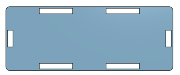

Step 3: Create the Bottom of the Box
  1. Create a rectangle that is 80mm x 210mm.*
  2. Create four boxes that are each 6mm x 42mm as shown in the picture. Make sure they are 2mm away from the top and bottom.
  3. Extrude this sketch 5.6mm. It should leave the four added boxes as holes..**
  4. Create a new sketch with the top side of the box as your new face. Create a rectangle 6mm x 21.1mm on this box and make sure it is 2mm from one of the short edges of the box.
  5. Repeat this step for the other short edge.
  6. Extrude this sketch as a hole through the entire model.
  7. Lastly, for aesthetics, fillet all four corners using the fillet button on the top toolbar.
*All measurements in this design are in mm unless otherwise specified
** Anytime you are sizing something to 5.6mm (1/4") it is just the thickness of the wood you are cutting into. If your wood is a different thickness, make sure to size the models to that thickness instead of 5.6mm.
Step 4: Final "Bottom" Product
This is going to be the bottom piece of the box.

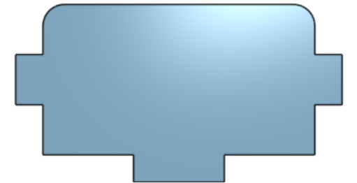

Step 5: Create the Short Sides of the Box
  1. Create a rectangle that is 35mm x 63.3 mm.
  2. Extrude it 5.6mm
  3. Create a new sketch and select one of the long sides as your plane. Create a rectangle that is 21.1mm long and that is the same width as the previous rectangle (5.6mm). Place this rectangle in the middle of the side (21.1mm from either end).
  4. Extrude it 5.6mm
  5. On both shorter sides, create a rectangle that is 11.667mm long and the same width as the rectangle (5.6mm).
  6. Extrude both rectangles 5.6mm.
  7. For aesthetics, fillet the two corners that are not on the side as the long rectangle that you made. (See the image below for clarification).
Step 6: Final "Short Side" Product
This is going to be the two short sides. You will end up laser cutting two of these.

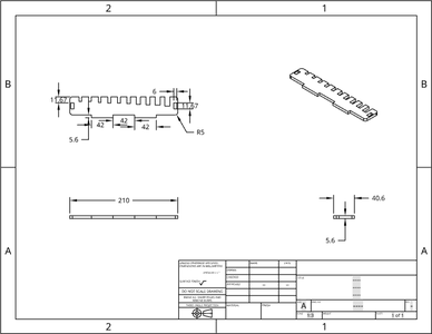

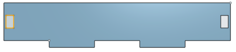

Step 7: Create the Long Sides of the Box
  1. Create a rectangle that is 5.6mm x 210mm
  2. Extrude it 35mm
  3. Create a new sketch on the bottom of the piece and make two rectangles. They should both be the same width as the rectangle you just made and should have a length of 42mm. See the picture above. They should also each be 42mm from the sides.
  4. Extrude it 5.6mm
  5. Now create two rectangles on either end as we did in step 3. Each rectangle should be 6mm x 11.667mm and should be 2mm from either end. They should also be centered vertically.
  6. Extrude them as holes so they go all the way through.
  7. This is the basic shape of the long sides.
Step 8: First Part of the "long Sides" Completed
This is the basic frame of the long sides. Continue reading to learn how to complete the long sides
Step 9: Add the Holes That the Wrenches Will Fit Into
This step will take a bit of time because each hole is a different size. The picture above shows where all the holes should be located, and the dimensions of each hole. Keep in mind that all measurements are in mm.

Once you sketched out all 10 rectangles, extrude them all as holes so they go all the way through.
Step 10: Final "Long Side" Product
This is what the long side will look like. You will need to laser-cut two of these.
