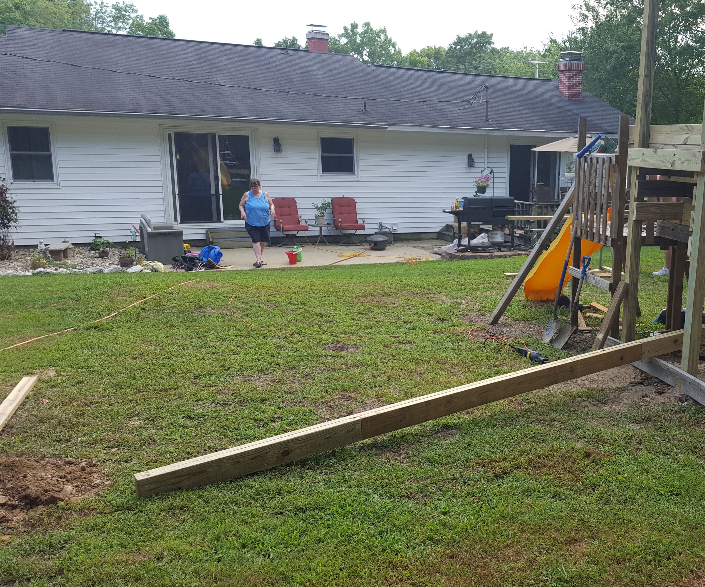

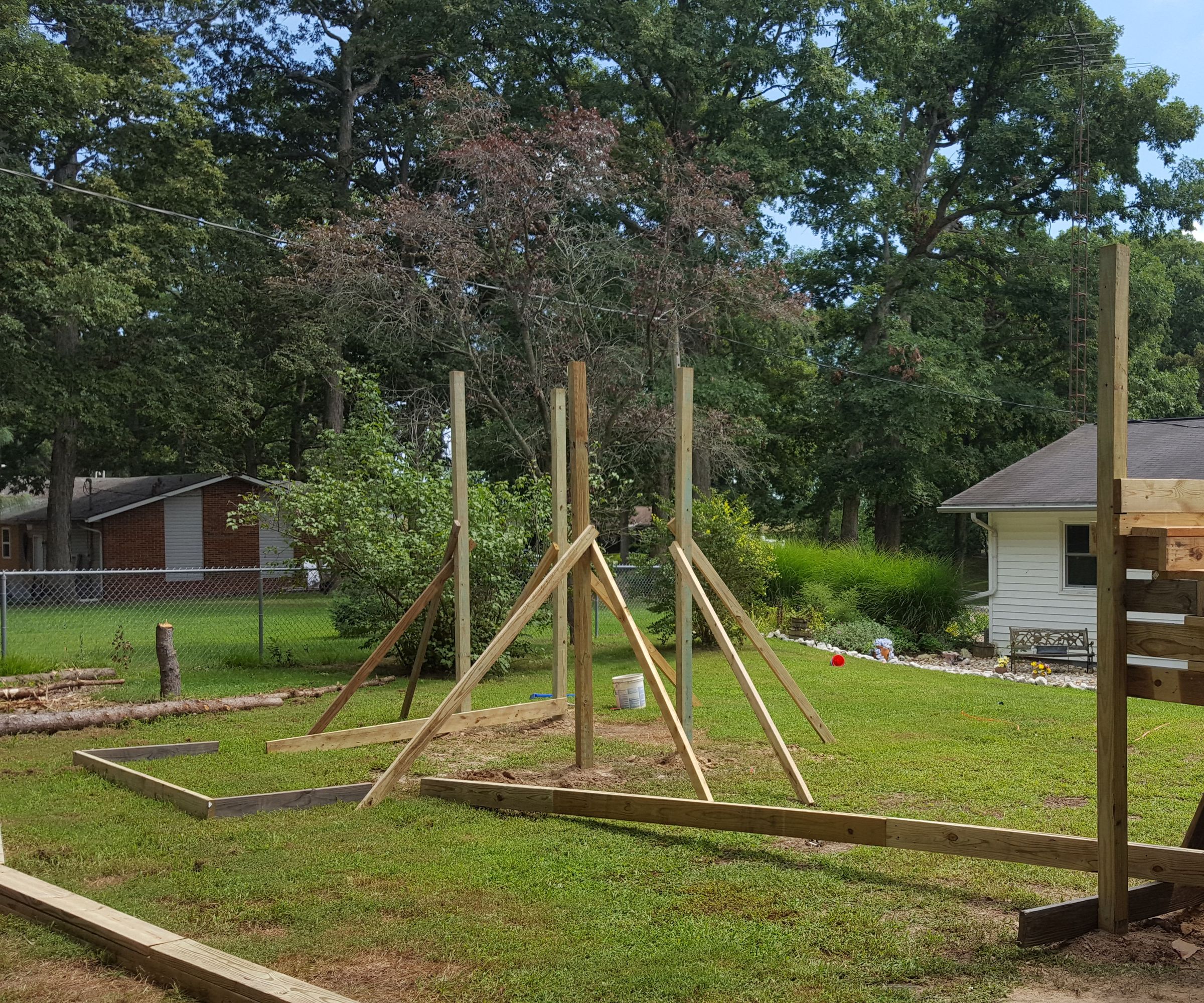

Step 1: Foundation Day 1
Dig four holes for the foundation.
The four holes are 6 feet apart outside edge to outside edge, creating a six foot square.
Dig the holes two feet deep and one foot in diameter.
Place a 4x4 post 10 foot tall into the holes.
Attach two 2x4 timbers to each 4x4 post perpendicular to one another. Approximately 5 feet above ground level with one screw each. Level the post and shove the 2x4s into the ground to keep the post from shifting.
To ensure the posts are level and square construct a 6 foot square to be attached at the midpoint of the posts, five feet from the top, three feet above ground.
Once all posts are squared within the 6 feet from one another, level, and secured begin mixing concrete. 6 bags allows for 1.5 bags per hole. This should fill each of the holes between 2 and 4 inches below the ground level.
Let the Concrete set for 24 hours.
