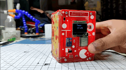

So here's something OverEngineered and different: a Pen Stand or Holder made completely from PCBs and 3D-printed parts.
The goal was to create a pen stand that was entirely different from the typical pen stand. It would have a number of features, such as a room temperature and humidity meter, an onboard light for aesthetics and illumination, and a USB port that could supply 5V to power various devices, including smartphones.
Version 1 of the PenStand I constructed last year was large and heavy; Version 2 is more compact and has an additional ESP8266 Setup that is connected to an SSD1306 OLED and an AHT10 Sensor.
https://www.instructables.com/OverEngineered-Pen-Holder/
This New Setup is a pen holder that measures the temperature and humidity in the room and shows the data on the SSD1306 display to keep us informed about the current room climate.
This Instructables is about how this device was created, so let's get started with the build.

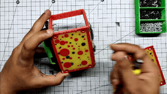

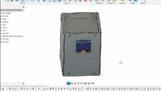

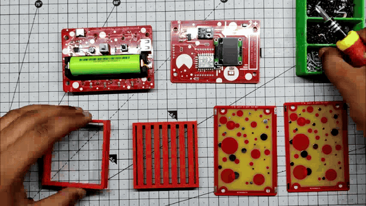

First, the 3D model was created in Fusion360, and it consists of four identically sized rectangular Boards arranged in a cuboid shape. To hold these PCBs together, we designed two inside holders with screw mounting holes. We will add screws to keep the PCB connected to the internal holder.
Internal holders are located on both the top and bottom of the penstand; the bottom holder acts as the lid.
The display, ESP configuration, and AHT10 sensor will be located on the front PCB, while the lithium cell and power management IC arrangement will be located on the bottom PCB.
PCBCAD software was used to generate the outline after exporting the PCB shape DWG file.
Step 2: PCB Design
The first step in PCB design is to create a total of three different boards: the power management board, which houses an IP5306 IC with a lithium cell, the side PCB, which only acts as a connection board to connect the front PCB's VCC-GND to the power management board, and the front board, which includes an ESP12F setup with an SSD1306 display and an AHT10 sensor.
The Power Management Board consists of an IP5306 IC with all necessary parts, such as input and output capacitors, an inductor, etc.
The battery has an 18650 SMD holder footprint added, and we used a Type C connector for Power IN. Moreover, 10 red LEDs were added in parallel using four 1206 resistors with the IP5306's 5V, and there is a push switch between the 5V and the positive of the LEDs.
After the power board schematic is complete, we use the DWG file exported from Fusion360 to create the PCB outline and add all the components to the board. We placed LEDs on the bottom side of the PCB, and IP5306 IC components, including the battery holder, were all added on the top side of the PCB as the top side will face outwards. LEDs will be placed inside the pen holder to illuminate the entire assembly from the inside.
As the ESP12F is a 3.3V device and 5V will damage the MCU, we added an AMS1117 Voltage Regulator setup to step down 5V from the input side to 3.3V for ESP to function. Next, we prepare the front PCB, which is the ESP12F setup connected with an SSD1306 OLED and AHT10 sensor. The entire board is powered from 5V we get from the power module board.
Both the display and AHT10 sensor are powered by 5 volts.

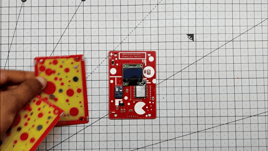

The same DWG file is used to create the outline for this board as well. AHT is added on one side, and ESP12F is added below the display in the middle.

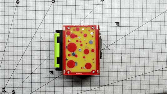

The third board, which is the side PCB, will be empty and without any ports or connecting pads, but we have added two CON1 ports with PCB traces linked to them that extend 5V and GND from one side of the board to the other.
In addition to serving this purpose, the side PCB has patterns and a solder mask aperture on both sides that allows light from the LEDs to pass through.

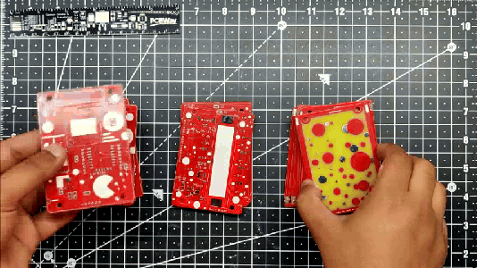

Step 3: PCBWAY
After completing all three PCB Designs, we export their gerber data and send them to PCBWAY for samples.
Three Orders were placed, all for RED Solder mask and white silkscreen.
After placing the order, I received the PCBs within a week, and the PCB quality was pretty great. The silkscreen I used is completely random and asymmetrical, so it's pretty hard to make, but they did an awesome job of making this PCB with no errors whatsoever.
You guys can check out PCBWAY if you want great PCB service at an affordable rate.

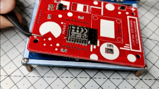

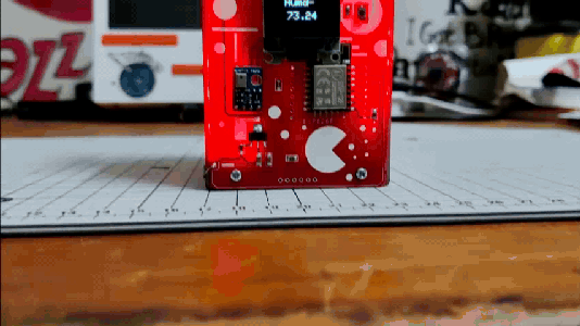

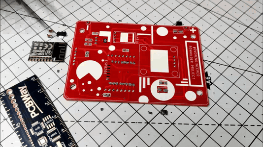

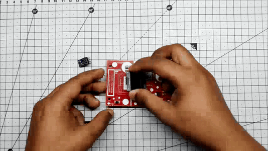

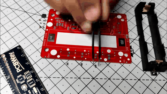

Step 4: Front Temp/Humidity PCB Assembly
We begin with the Front TEMP/Humidity PCB Assembly process, which required the use of two soldering techniques because it involved both SMD and THT components.
  • We first apply solder paste to each SMD component pad using a solder paste dispenser.
  • Next, we pick and place all the SMD components in their proper places using an ESD Tweezer.
  • Following the pick-and-place procedure, the PCB is carefully lifted and placed on the SMT Reflow hotplate, which heats the PCB from below to the solder paste melting temperature, permanently soldering all of the components to their pads.
  • We gather all the THT components, including the OLED display and AHT10 sensor module, position them on their pads, and then solder the pads with a standard soldering iron.

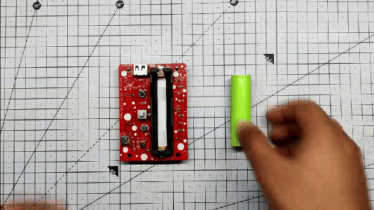

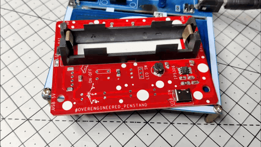

Step 5: Power Management Board Assembly
Next, we begin the Power Management Board assembly, which followed a process that was identical to the one used to create the front PCB.
  • We first add solder paste to each SMD component's pads, and then, using an ESD Tweezer, we pick up and arrange each SMD component into position.
  • The PCB is then placed on the SMT Hotplate, where it is reflowed and all of the SMD components are soldered to their pads.

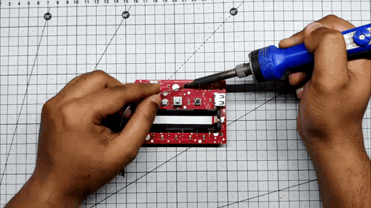

  • The remaining THT parts, including the 5mm THT LED, Push Button, USB Port, and push-on-off switch, are then added.
The Board is now complete.

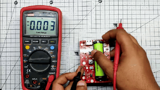

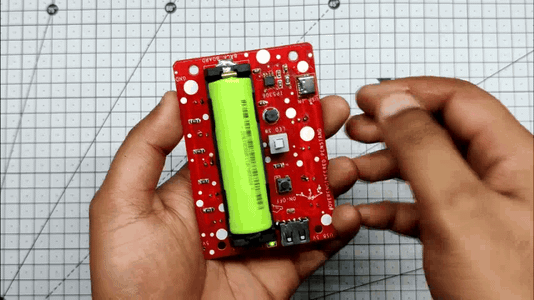

Step 6: Power Source

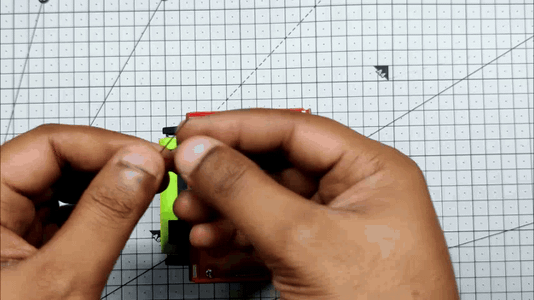

The entire system is powered by a 3.7V, 2900mAh 18650 lithium-ion battery, and the ESP12F OLED and LEDs are powered by a reliable 5V output from the IP5306 power management IC.
We insert an 18650 cell into its holder by confirming the polarity, and we then use a multimeter to measure the output voltage, which should be 5 volts; this confirms that the setup is functioning.

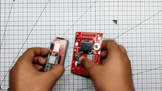

Step 7: Temp/Humidity Board Programming With NODEMCU
You might not be aware that any ESP board can be programmed using the NODEMCU Board.
By taking a NODEMCU board and connecting a jumper with its GND Pin and EN Pin, which puts the onboard ESP8266 of the NODEMCU into sleep mode, we may utilize the NODEMCU to program the external ESP12F module.
This enables us to connect an external ESP Board to the NODEMCU; so essentially, we are turning off the ESP board on the NODEMCU and connecting a second ESP Board to a few of its pins.
You can read the article below for additional information about this process.
https://www.instructables.com/Program-ESP8266-With-NodeMCU/

Step 9: Final Assembly
The final assembly method begins by first gathering the four Boards, the bottom lid, and the 3D-printed holder together.
  • We begin by using M2 screws to attach the front PCB to the 3D-printed lid before adding the back PCB and the 3D Holder on the top side.
  • We then install side panels using the same M2 screws.
  • After completing the mechanical assembly, we link the power management board's positive and negative terminals to the side PCB using jumper leads. Then, the positive and negative terminals of the side PCB are connected to the front PCB using the same jumper leads.
The Project is now complete.
Step 10: RESULT
This project's final result is an overengineered pen stand holder with an ESP12F setup at the front, an OLED screen, an AHT10 sensor for monitoring room temperature and humidity, along with RED light that lights up the entire thing.
This project was a follow-up to my earlier PEN HOLDER project, which was also made entirely of PCBs.
Ultimately, this project demonstrates that FR4 may be used to create body parts in addition to electronics.
