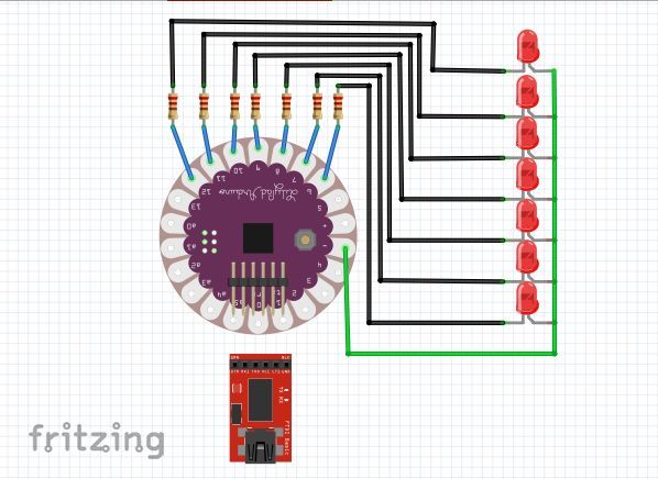

There is no "circuit board" but the schematics would look like this:

The LEDs are sewn into the palm of the glove with the ground side on the right. I found that sewing them in place with normal thread worked to keep the spacing. Once they are all in place run conductive thread from the ground (-) on the Lilypad to the ground side on all the LEDS. In the diagram the Green line is this run of conductive tread.
On my glove (left hand) I ran the thread from the (-) , under the thumb and straight up the palm. Try to wrap each connection 4 or 5 times to ensure a good contact.

At this point you have a choice. You can use conductive thread and connect the resistor the to the LED. I found in my case I was just not able to sew the thread close enough to keep it from shorting out.
Alternately you can use wire. Strip the end and roll up like you did the resistors and LEDs. Use conductive thread to sew the resistor to one end and the LED on the other.
Be sure to connect the I/O #6 to the bottom LED (closer to wrist ) and work up to I/O12 to the top LED(closer to fingers)
