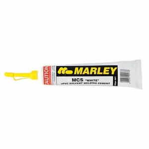

  • PVC Cement

Use a piece of threaded bar or a bolt to centre the three discs that make up each pulley. Put a small amount of PVC cement between each of the discs. Lastly, put a washer and nut on and tighten this down.
A small amount of PVC cement will probably squeeze out, you should wipe this off with a rag. A splash of acetone (or finger nail polish remover) on the rag will help clean this up.
