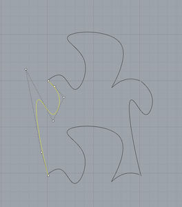

I then designed a simple puzzle side using an interpolation curve consisting of six points, which I used as a reference for the program. I looped through my grid of points to create horizontal curves between points with the same Y value, and vertical curves between points with the same X values. I checked for edge curves and drew them as straight lines instead. The curves each consisted of the gridpoint, the adjacent gridpoint, and four points in between, and linearly scale by height and length of the puzzle piece.

In the selected line here, you can see how the interpolation curve is shaped around the points drawn.

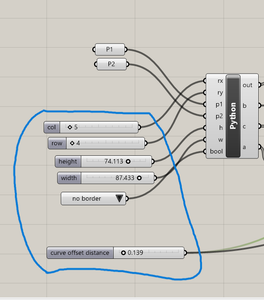

I also added a parameter to allow control of the border, which is no longer necessary as it is for the puzzle. The parameters are shown in detail in the grasshopper editor, and consist of sliders (R) for width, height, sliders (N) for columns, rows, and a dropdown to enable/disable border.
I played around with other input-controlled parameters such as curve degree, smoothness, and dimension however the output quality was significantly diminished with overlapping lines so I removed them.
