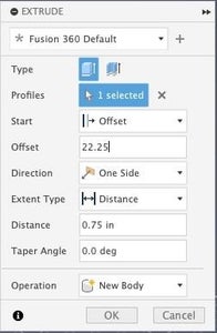

Step 2: Modeling (Extruding)
Now that our "base" sketch is finished, we can extrude:
1) The bases will be extruded 3/4" inches as per the dimensions.
2) The legs will be extruded 24" inches as per the dimensions.
3) The board will be extruded 0.75" inches as per the dimensions. I added an offset of 22.25" inches above the ground.
