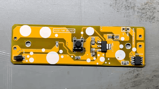

Step 1: PCB DESIGN
The schematic, which is divided into three sections—the AMS1117 part, the Raspberry Pi Pico portion, and the Mosfet as switch setup—is the first stage in the PCB design process.
The A04406 Mosfet, a N channel High power Mosfet IC in an SOIC8 package, is what we utilized for this project. Its source is connected to GND, its drain is attached to a CON2 port, and its other end is connected to 12V from the input side. This CON2 will be used to connect the load, in our case a 12V DC fan. The Mosfet gate is connected in series with GPIO0 via a 10K resistor.
The second section includes the AMS1117 setup, which is primarily the AMS1117 minimal setup with a 10uF CAP at the AMS1117's input and a 1uF CAP at the output. Between the input VCC and the AMS1117's input, we add an M7 diode to reduce excessive power coming from the input side.
Additionally, we added an LED that will function as an indicator and is in series with the input side via a 1K resistor.
The Raspberry Pi Pico is located in the third section. It is paired with a toggle switch that is linked to both GPIO1 and GND. When the switch is pressed, GPIO1 is connected to GND.

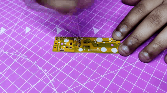

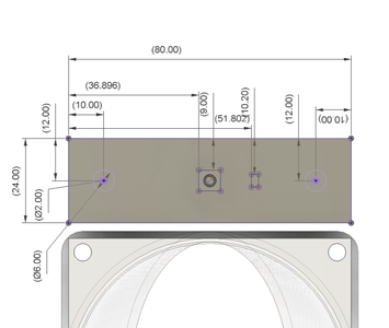

After setting up the schematic, we export the netlist and convert the schematic into a board file.
We model a 24 x 80 mm outline in the layout, and we arrange all of the SMD parts, with the switch in the center, on the top side. The Pico is positioned on the bottom side.
The board was finalized and then send to PCBWAY for samples.

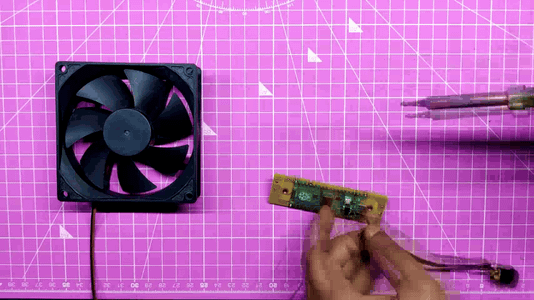

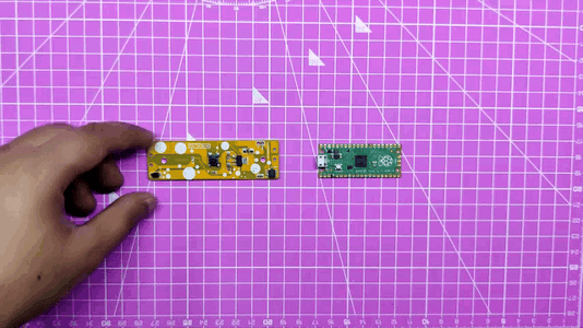

Step 3: PCB ASSEMBLY
  • Using a solder paste dispensing needle, we first add solder paste to each component pad individually to begin the PCB assembly process. In this instance, we are using standard 37/63 solder paste.
  • Next, we pick and place all the SMD components in their places on the PCB using an ESD tweezer.
  • With extreme caution, we lifted the complete circuit board and placed it on the SMT hotplate, which increases the PCB's temperature to the point at which the solder paste melts and all of the components are connected to their pads.

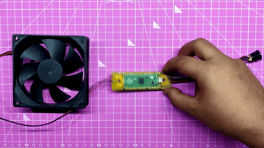

  • Next, we add the PICO on the bottom side of the PCB using a soldering iron.
The Board is now complete.

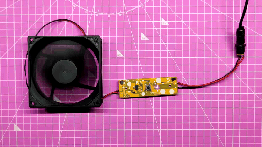

After uploading the code to the PICO, we use the DC Barrel Jack to plug the 12V adaptor into the board.
Step 6: RESULT

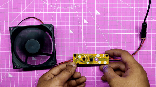

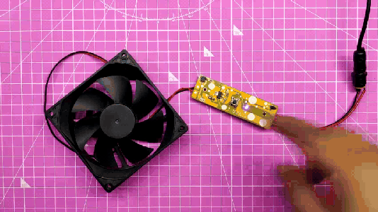

Here's the result of this simple build- A working Motor Driver running a 12V PC Fan through a Raspberry Pi Pico connected with an AO4406 Mosfet IC.
The first tap activates the setup; the second drives the motor to run at 140 duty cycle; and the third tap deactivates the load. This is a continuous process.
The initial code is capable of including more modes, making modifications incredibly simple.
This driver can be used to power a wide range of DC loads, such as a solonoid, an array of LEDs, pumps, and other devices that run on a 5–12V voltage. It can also be used to power any type of motor that runs on 12V.

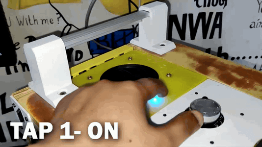

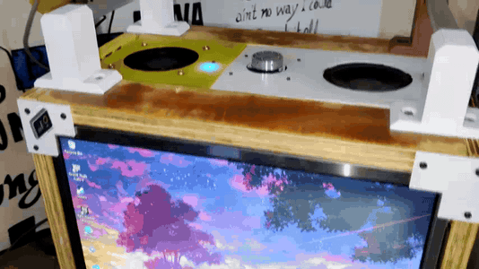

Here's the final step of this project, which was to implement it into the woodwork fusion PC.
  • The plan was for the fan to draw air from the top and circulate it around the PC, improving ventilation and keeping things cool. To that end, we first 3D printed the fan-circuit holder, which was designed to fit atop the woodwork fusion PC.
  • We mount the fan with its 3D-printed body and circuit to complete the fan assembly.
  • Subsequently, we position the assembled fan mount over the woodwork fusion PC and fasten the entire assembly with four wood screws.
Power was provided by ATX Supply 12V.
The switch on the Pico Fan Driver board controls this fan setup. A simple press turns the device ON, the second will reduce the fan speed by fifty percent, and a third tap turns the fan off.
