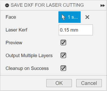

I exported each piece using the DXF extension with a 0.15 mm kerf. I chose this kerf so that the pieces would be loose enough to be taken apart and continuously rebuilt. I then added them to an Illustrator file, where I made final adjustments for the CNC machine. I also copied additional "head" and "body" parts in Illustrator so that I could increase my build options.
