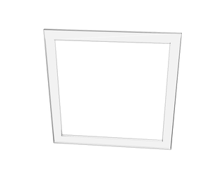

Step 3: Laser Cutter
I start to make a drawing in Adobe Ilustrator. In the beginning I want to make the Pitstop from 6mm wood.
To create the Pitstop as a building packet I load the drwaings in Rhinoceros to make a 3D sample. There I can see that the plates fit in each other.
The first day I found out that 6mm thick is to mach. It take hours to cut through the plate. and we can only can use the machine one hour. So I went back home and I remake the drawings to 3mm thick plates. Now it cuts in one time throught the plate, so the work can speed up!
In the beginning I found it to thin for the big birds, but this is a prototype so when everthing is rounded I will see how it works whit the birds. For the weaker parts I glue two plates, and than it is 6mm.

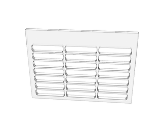

Step 5: Bin With 3D Printer
I use PLA-plastic, and it is waterproof!
PLA-plastic opposed to ABS-plastic: ABS needs higher temperature (230 and higher) and was not an option of the Fablab.
It takes 2 hours to make the bin and 20 min to make the edge. I glue the edge it whit PVC-glue after I scrub the edges for a better fitting. I want to make 4 bins in total but unfortunately I don't have the time for that. When you have the time I recommend to to all the bins with the 3D printer. But if you don't have the time, see the next step.
Than I want to print a grid above the poopbin, but that takes 8 housrs, so that was to long for me. I make a model with wood, but you can if you have the time make it with the 3D printer.
My conclusion is that the 3D printer works perfectly for the ride size, but it takes a lot of time. It is the waiting more than worth!
