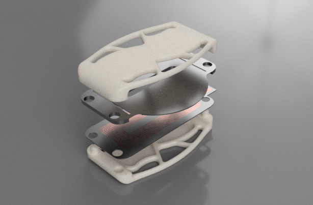

Step 3: Design and Print:
As always I jumped onto Fusion 360 to design the drivers, to get the thin yet rigid parts I needed I decided to print it on my resin printer but it should work on a FFF printer with 0.4mm nozzle and <0.2mm layers.
Bellow is the 3 files to print as well as the step file if you want to adjust something in the design.
I designed the two magnet shells/holders to the largest hard drive magnets in my collection so that it can fit a wide variety.
The middle coil print is still highly experimental, although the stl uploaded does work this part has the biggest impact on your sound so a lot of tweaking still has to go into the design.

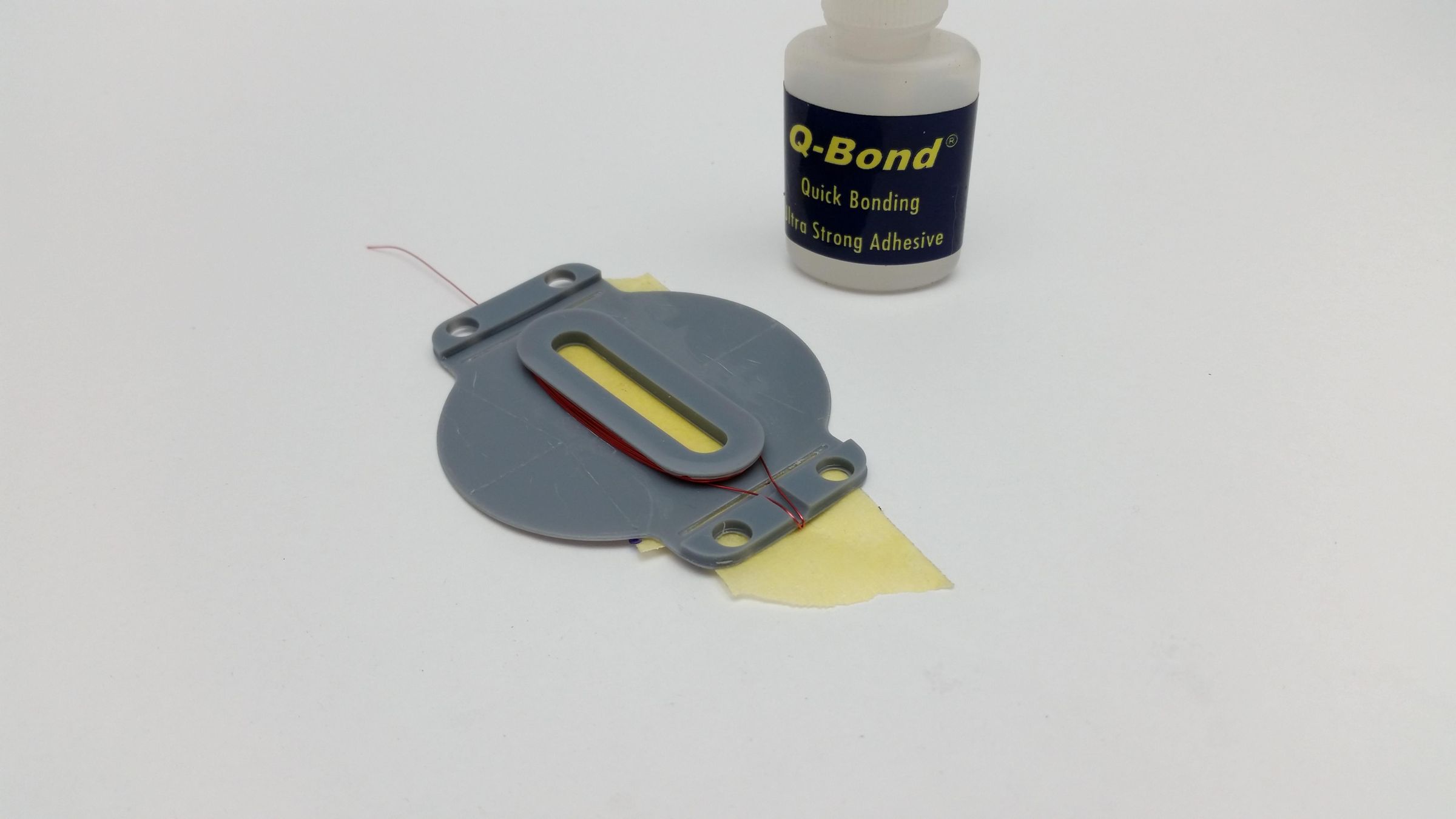

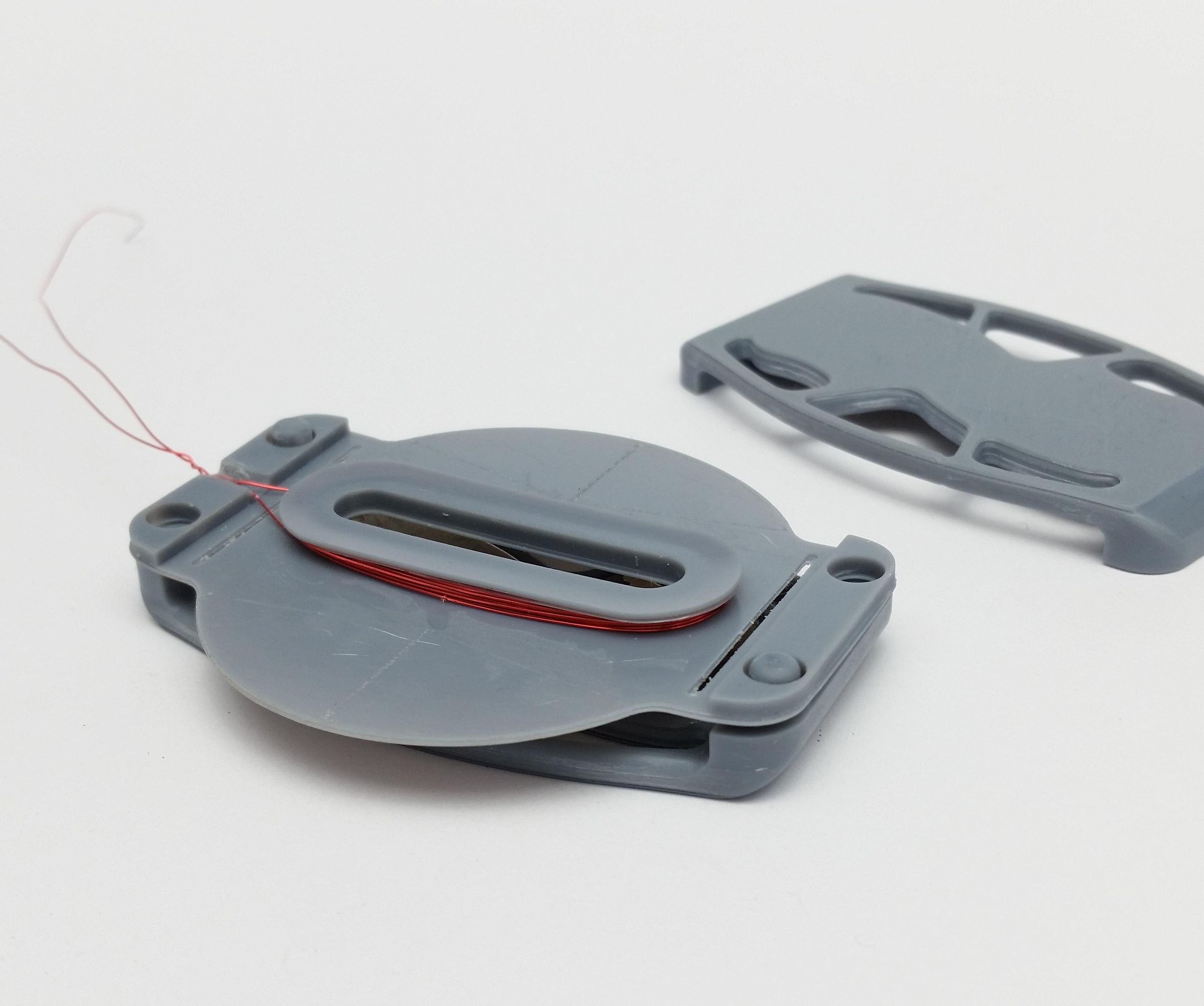

1: Coil on bobbin
The first is the one I'm currently using and is pictured above.
This to me is simplest to make as it is a bobbin attached to a thin round extrusion that acts as the diaphragm, you then simply need to wind your enamelled copper wire around the bobbin to complete.
I wound the coil with the thinnest wire I had on hand which is 32 gauge, It would be better with something closer to 36 gauge as I could get more windings on the bobbin and lower the resistance as it is currently 2ohm which is a bit too low but still within spec for my amplifier for testing purposes.

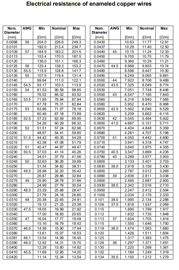

You can use this table to roughly estimate the required length of wire needed for your voice coil:
Be sure to apply CA glue (super glue) liberally to the coil after winding to prevent unwinding and vibrations whilst playing.

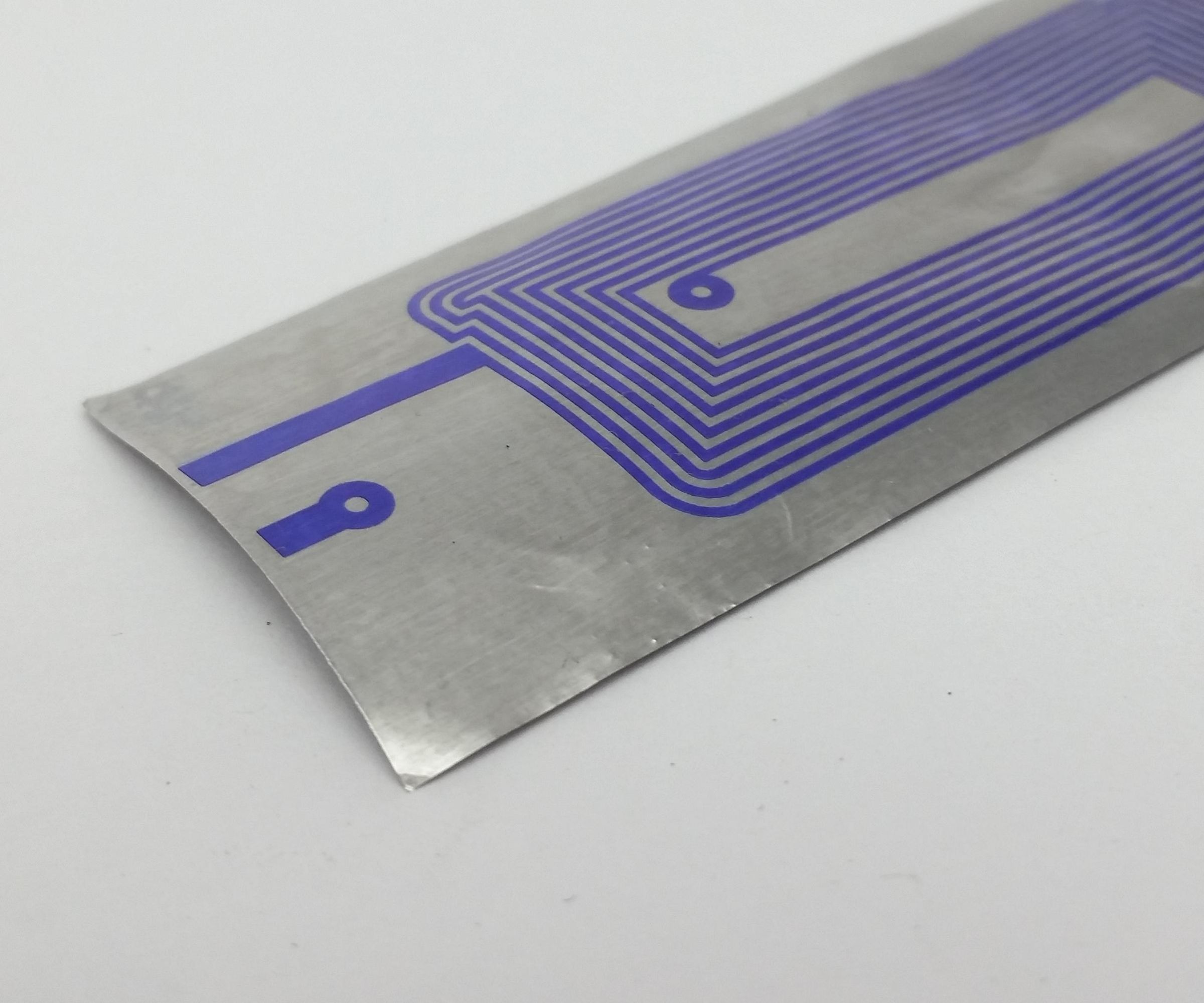

2: UV mask etching
For this method we will use the display from the resin 3D printer to create a UV resist mask, this mask can then be heat transferred to a piece of copper or aluminium foil.
After transferring the mask onto the foil we need to add a thin backing to the foil to keep the coil in tact after etching, this is where I had problems with this method.
The material you use for the backing will become your planar drivers membrane so it needs to be suitable for sound reproduction. In my test I used normal printer paper stabilised with thin CA glue, I know this can sound good from tests with sound exciters.
With the paper backing the coil etched well with only one small defect but still tested good and was exactly 4ohms, super excited to test it I started soldering... here's the problem... I had no copper foil wide enough so I had to use aluminium but the flux and higher heat that comes with aluminium soldering quickly destroyed the paper backing.
This is the method I'm definitely going to be doing most of my experimenting with as soon as I get some wider copper foil.

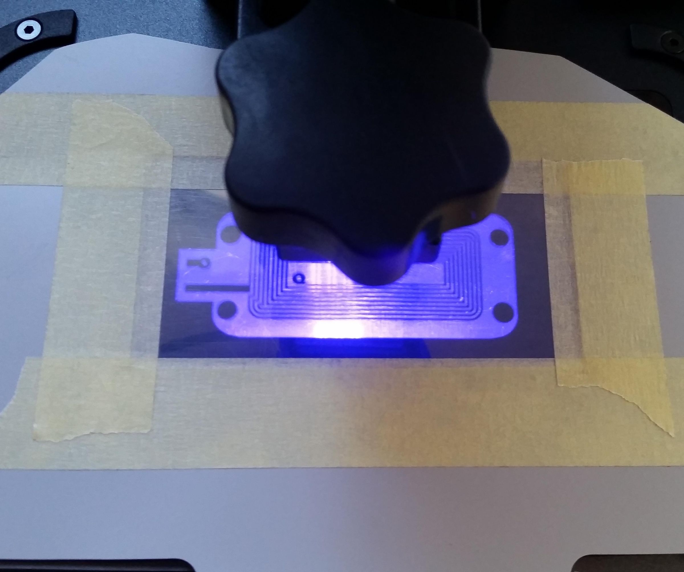

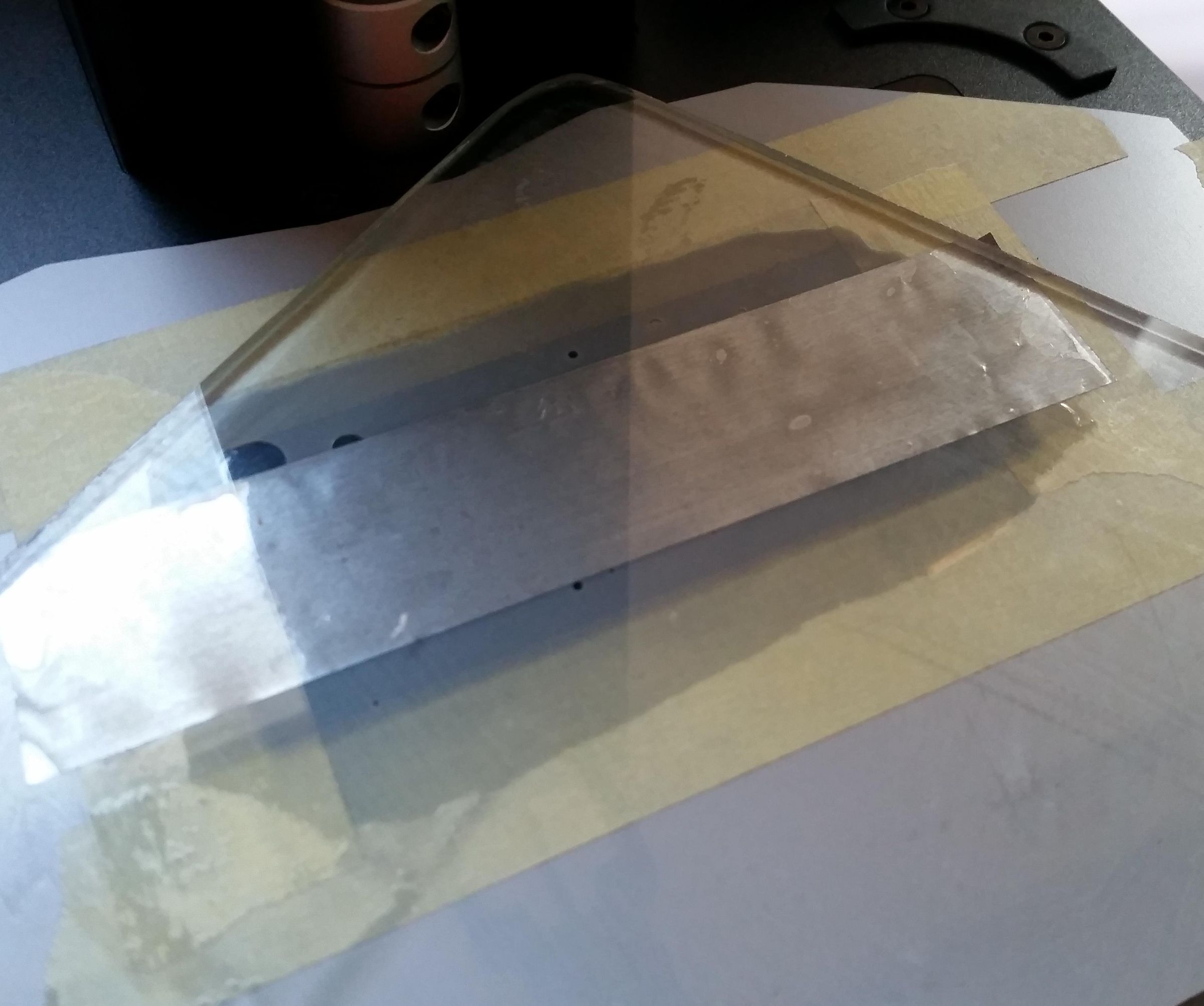

3: Resin mask etching
This method is completely new to me yet is something I will definitely be trying out more in the future, unfortunately like the previous step I was unable to continue testing due to the aluminium foil.
Here we will use the resin printer as well as the resin from the printer to create a resist mask out of the resin directly onto the foil.
For this you will lay a piece of transparency on top of the printers screen (the vat and printing bed will be removed during this entire process) then using painters tape we create our own very thin vat this is just to lift the foil a few microns from the screen making space for a layer of resin.
Lay the foil onto a pane of glass (I smear some resin on the glass just to keep the foil in place) add about half a teaspoon of resin ontop of the transparency that's on the screen and squish the glass pane with the foil onto the resin.
Keeping some pressure on the glass run the print and clean as you would a normal print.
You will be left with something similar to the previous method but with resin instead of the UV resist that can then be etched.
What I like about this method is you can incorporate the coil backing/diaphragm into the initial exposure so that your coil is basically embedded in the diaphragm.

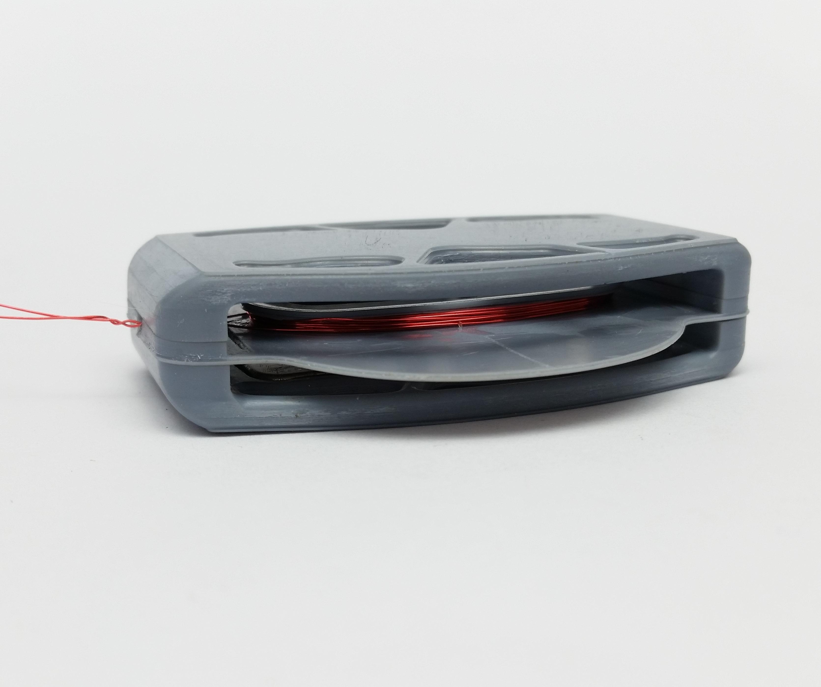

Step 6: Assembly:
Time to start assembling your driver.

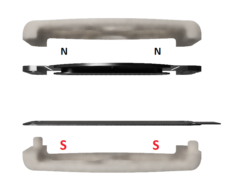

First we need to mark the polarity of our four magnets, I use a small weak magnet mark each of the magnets polarity this is important as the magnets have to be added into the cases in the correct polarity or your driver won't function correctly.
I used a thick CA glue to adhere the magnets into their corresponding slots.
After inserting the magnets the rest of the components simply stack on top of each other, start with one of the magnet housings then the coil goes on top of it and finished with the second magnet housing.
In between the components I used B-6000 glue for it's vibration absorbency.
Step 7: Test It Out:
The uploaded sound file is just a rough recording from my first play, as expected the resin dampens the movement of the coil too much but at least the concept works.
Next I will be revising the diaphragm and suspension.
Updates:
  • I broke off the tabs that hold the diaphragm to the magnet shell and replaced it with a cloth tape, this freed up the sound a LOT and gave deep bass but the treble is still slightly muddy due to the resin diaphragms weight.
